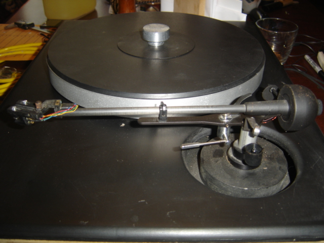

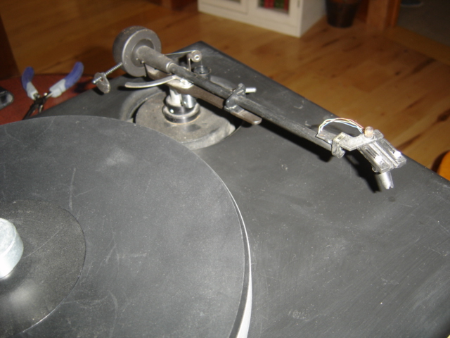

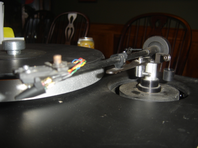

Who made this tonearm?
In the attached photo's is my tonearm from years back(at least 20 years). Fresh from its dark and dirty storage in the barn. Unfortunaltley, I lost the box and paper work it came in. I know it is a uni-pivot but for the life of me can't remember the name of the manufacturer.

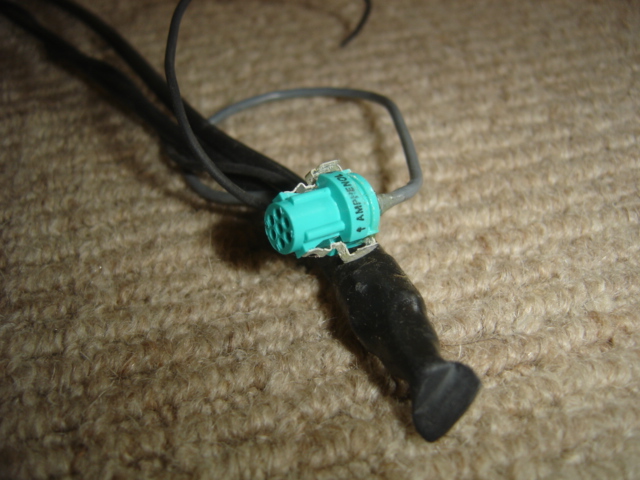

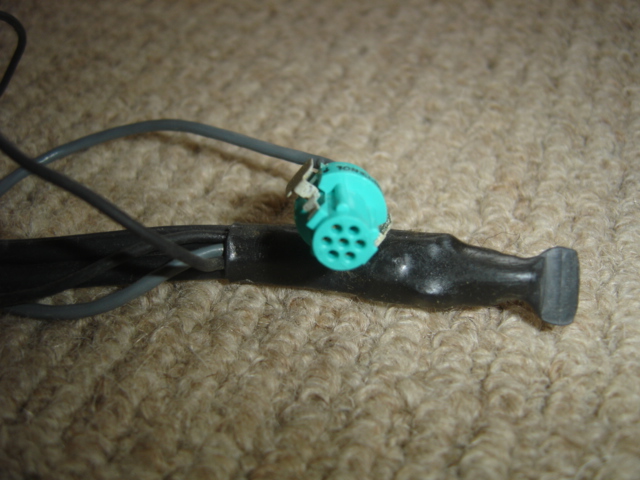

I also attached a photo of the cable connection and need advise on what to replace the cables with. The newer style cables use the DIN 5.
I will ask forgiveness in advance for letting this thing set in a box and fall into such a state of dis-repair. The stylus is a Talisman S, but with no cantilever:(.

The TT was originally an Ariston Audio RD80. The plinth was flimsy so I built a new one many moons ago out of MDF. Will probably redo at some point after I get the system up and running. As it stands today, I have to rewire it. Will use Cardas Shielded 4x33 in a single run to the RIAA amp for that. I can eliminate the special plug on the head shell and at the base of the arm by rewiring.
I think the photo in the manual shows the DL103D, high compliance version. Back in the day this was a common set up. I am concerned that the arm may not be a good fit for the 130R which is a low compliance cartridge. Will find out soon enough I guess.

I was thinking about uping the mass of the arm a little when I rewire. One thought I had was to pack the carbon tone arm with talcum. It would dampen it abit while dropping the Fs down a little. I recall 8 Hz being a good number.
The arm in general is in great shape other than the wiring. The pivot is perfect, as it was stored in a non contact position. Just needs a good cosmetic cleaning.
I have to take it apart to rewire, hence my consideration of adding some mass to it while it was in that stage. Where is the recomended Fs in today's world?

Best Fs is 10Hz to 12Hz IMO.
