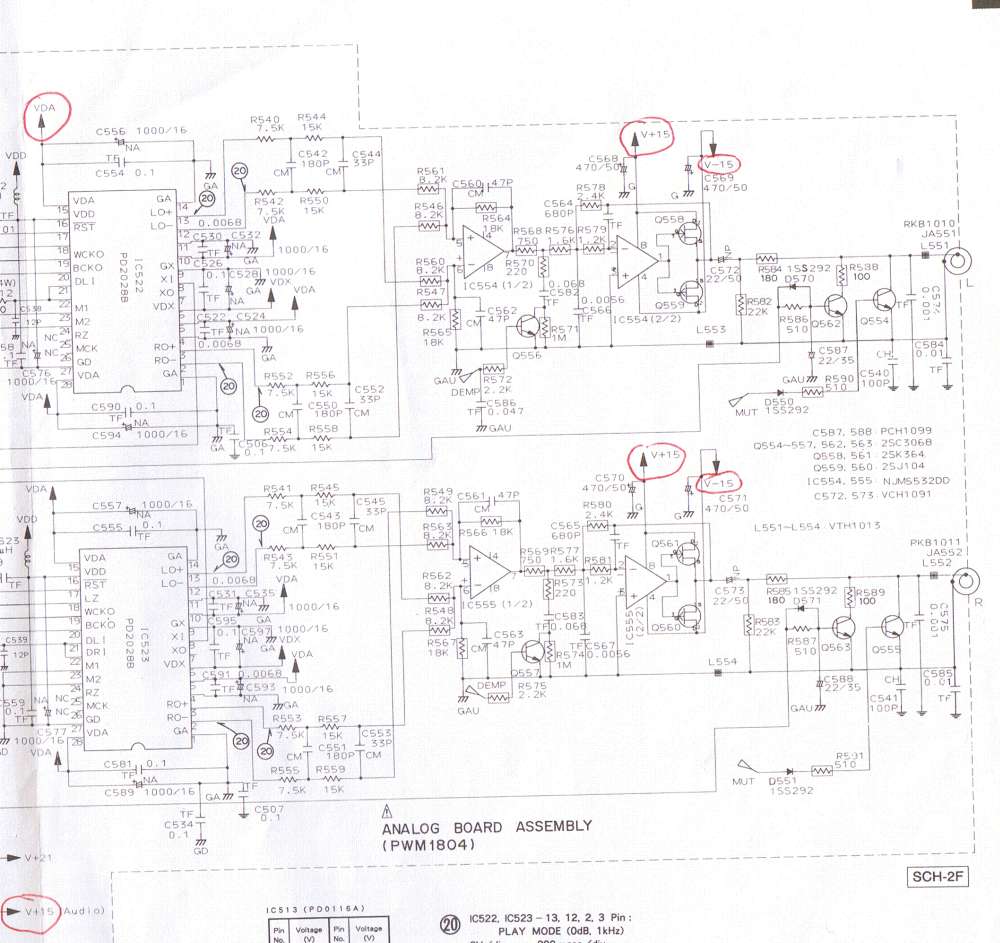

Depending on what your doing this could help, it's the PD2028B but it's closely related I think. It's all I have left of the Pioneer stuff. Cheers George

D deuginthesky Member Joined 2007 2008-01-28 11:55 am #6 2008-01-28 11:55 am #6 Thanks, seems very similar with PD-9700. ••• More options Share
