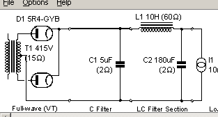

One other comment Bas, and that is to make sure with no signal present that the plate voltage on your EL84 is at least 180V - 200V, which implies at the current I was suggesting that the raw supply be in the range of 400V minimum on the other side of that 12K plate resistor. (You could also change it to 10K, but I wouldn't go lower due the loss in gain.)
Fortunately you do have headroom in the supply to get the voltages you need.
Check. Got it to 215 last night.and that is to make sure with no signal present that the plate voltage on your EL84 is at least 180V - 200V,
