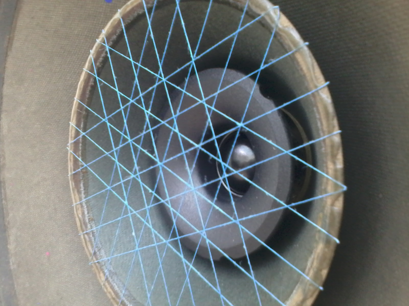

Has anyone else tried criss crossing cotton thread across a whizzer to stop the bell mode resonance?
I stretched cotton thread aver a soup bowl in a very open weave to give hexagon shape 1cm holes (it was a big whizzer), painted it with PVA and let it dry. I then put a bead of PVA round the top edge of the whizzer and stuck it on. Stopped the bell mode completely on mine. Reversible too at a push. I have a photo somewhere and will try to find it.

Found a photo. These we old McKenzie PA speakers that I made coaxial using some Monacor tweeters. I thought I'd made hexagons, but it was 5 years ago... I guess any shape will do, the point is to connect any given point on the edge to as many others as possible without adding too much weight. You can't see it in the photo, but the PVA is connecting the threads where they cross.

Very cool! I may try something like that on my EV's. I can't pinpoint any abnormalities in what I hear, but occasionally female vocalists have a bit of a buzzy noise on certain notes. Not sure if it's from the main cone or whizzer. Trying to pin it down. Otherwise, they pretty decent from about 60 Hz - 9 kHz on an open baffle.
Haven't seen/tried it, though some folks have used fine mesh screen to 'cap' it; my preference is to knead the starch out of it and if too limp, then use cheap lacquer hairspray or shellac or Dammar to fine tune it as required.

Haven't heard of that one, either. Maybe it would be worth buying one of those inexpensive 8 inch coaxial drivers (the Pioneer replacement) and practicing the technique until it's right before messing up a more expensive (or nice vintage) driver. I'd hate to mess up one of my EV's with a non-reversible tweak.

Normally a whizzer, though the $0.98 tweak sometimes cures it, but guessing it won't on a big one unless a relatively dense damping material is used.
