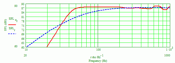

Here's my modeling results...
Mondo, I got the automated email from this forum containing the T/S values for your driver but for some reason, your post didn't end up being posted in this thread. Anyway, I did some modeling. I don't know exactly what kind of driver you're using but for the sake of modeling I assumed it was a ~5-inch fullrange type. So, I ended up with a line tapered at 15:1 and 42" long, starting at 4.13 Sd and ending at 0.276 Sd. Dimensionally the starting area was 7.5" square and the ending area was 7.5"W x 0.5"D. The terminus would be 7.5"W x 0.5"H. I placed the driver's center 8" from the beginning of the line. I used a stuffing density of 0.75 lb/cu.ft., stuffing with a total of ~7.5 ounces in the first 28" of the line. I've attached the system response graph (red line). I used Martin's ML-TQWT worksheet which allows modeling a tapered line, too. As you will see on the response graph, F3 is ~39 Hz and the ripples in the response are acceptably low. If the stuffing density and/or length were to be increased, the ripples would be diminished but at the expense of a higher F3. The terminus air velocity with this 2.83-volt modeling input was under 1% of the speed of sound.
Paul
Edit: The peak of the terminus air velocity occurs at ~32 Hz. Without stuffing, the system's tuning frequency is 40 Hz, and with stuffing it's ~38 Hz.

More modeling results
I used your latest T/S values, including adding 0.4 ohms of series resistance, and simply entered them into the very same tapered TL I originally modeled. The resulting system response is shown in the first attached graph (BTW, you didn't give me new values for Fs or Le so I used the original ones of 46 Hz and 0.9 mH). The system tuning with stuffing was ~38 Hz.

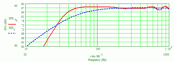

Next I lengthened the line to 48", keeping everything else the same, and the system response is shown in the second attached graph. The system tuning frequency with stuffing was ~32 Hz.

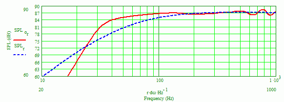

Last, I shortened the line to 36", keeping everything else the same, and the system response is shown in the third attached graph. The system tuning frequency with stuffing was ~41 Hz.
I prefer the overall shape of the higher-tuned system but I would make the enclosed volume larger in order to get a lower F3. Tuning the system lower, as shown in the second graph, does make F10 a couple of Hz lower.
