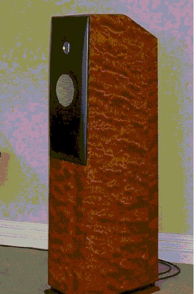

Jim Salk's Accubob (and my poor picture reduction technique..)
