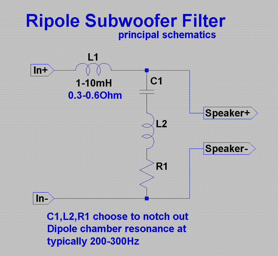

Your hint regarding using a coil reminded me of something I miussed saying.
A Ripole implemented properly features a passive EQ network.
This consists of a series inductor with a copper resistance of 0.3-0.6 and a parallel RCL network.
Whereby only the ohmic part of the inductor is required for the notch filter to work on.
The inductive part could be omitted with, but it performs a very welcome lowpass functionality.
The slight raise of the Qts due to the series ´resistance´ counters for the losses of the inductor ... so efficiency won´t be affected -> no loss of SPL.
Inductors with higher dc-resistance are quite cheap.
See for example the I-Kern inductors at Intertechnik.de (pic below).
Without that circuit its just a small folded dipole.
The network comprises a lowpass and a notch filter to cope with the chamber resonance (typically ~200-300Hz, depending on the cabinet dimensions).
Besides increasing Qt slightly, the Fs drops even more.
The impedance response also drops in value and the minimum, somewhere between 100-200Hz, should be watched if teh amplifier can drive that load safely.
It is not a necessity to use highohmic drivers and to connect the drivers in parallel ... the series connection of 4-ohmers works well also.

Thanks Calvin, some great tips. The 200-300Hz notch filter is a great idea, do you still think I need it if my LPF is at 100Hz, using a single 25-27mH transformer inductor?
I’m planning to use a single driver, so putting them in series is not an option. Keeping the total (three way) system impedance at a reasonable level is a main concern. Efficiency is less of a concern.

As the world's leading authority on "how not to build a ripole", I feel compelled to add a link that demonstrates the effect the cavity has on Qts and Fs
http://www.diyaudio.com/forums/subw...but-these-drivers-suitable-6.html#post4085513
Also, Using a cone to magnet arrangement reduces even order harmonic distortion, but also makes the arrangement less symmetric in terms on the air cavity load on the individual drivers, .. for whatever that's worth. The cone - cone arrangement is how the ripole was intended to "work" i.e. the "blow motion principle"
