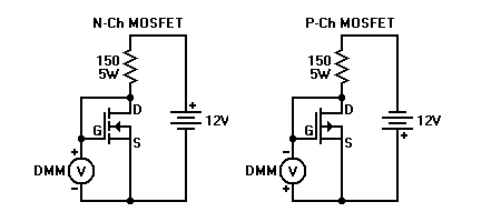

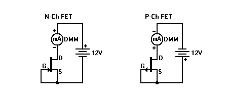

Well.. Finally I built my f5. Everything went fine until biasing. I had two dmm. I read somewhere, bias should be measured across R3 or R4! So, in my weird logic I thoght either one will fine. So I measured bias across R3 while monitoring dc offset . When I increase bias with one pot -one or two turn- offset increased. I turned other trimpot until dc offset at the output vanishes. While I'm doing this 500va toroid was humming mecanically. Biased other channel with only R3. (I know it was a huge mistake!) Both channel biased to 0.59V across only R3. Whole process took 3-5 min. I knew there is something wrong with this process. I kept going. I measured voltage across R4 to check. One channel has 2V, other channel has 1,8V!!! Turned off completely. I realized my silly mistake. Returned all pots to zero, turned on the amp. No humming transformer.. No dc offset.. Both channel biased to (this time both R3-R4) 0.59V. But dc offset does not change at all this time, constant zero.:confused:
Power supply for both channels steady +24/-24V.
I think I shorted outputs? I'm using original FQA mosfets. Did I blew something else at the amp boards by doing this silly bias procedure? Or replacing output mosfets may solve my problem?

pull them put (all semis) and check them - diode test (will show shorts) and simple JFet and mosfet matching/cheking procedure
re-read F5 building tutorials
you made some other mistake - two DVMs are enough for proper procedure
