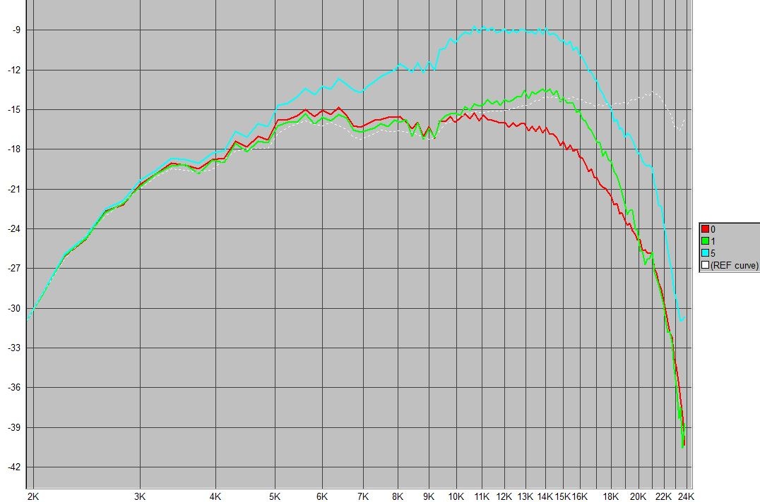

50 - 16,000 Hz ± 1.5 dB is stated for the Beyerdynamic MM1 at £185, i would want at least ± 0.5 dB and over a wider range.
if you buy a bunch of cheap electret capules one of them may possibly have a response as good
i.e. the green capules bare response is about 1dB off the referance curve upto around 15KHz (blue / red are extremities of the bunch)

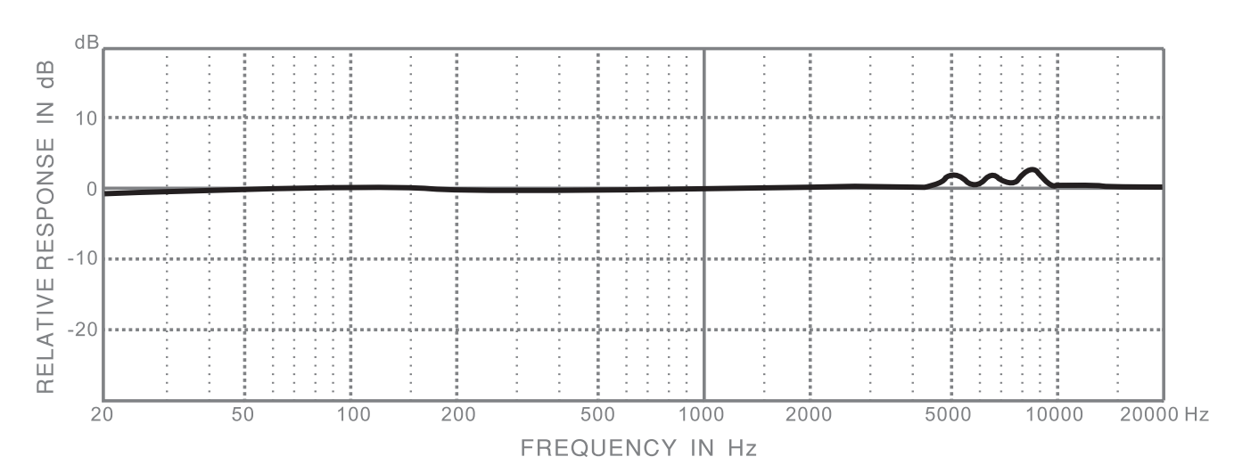

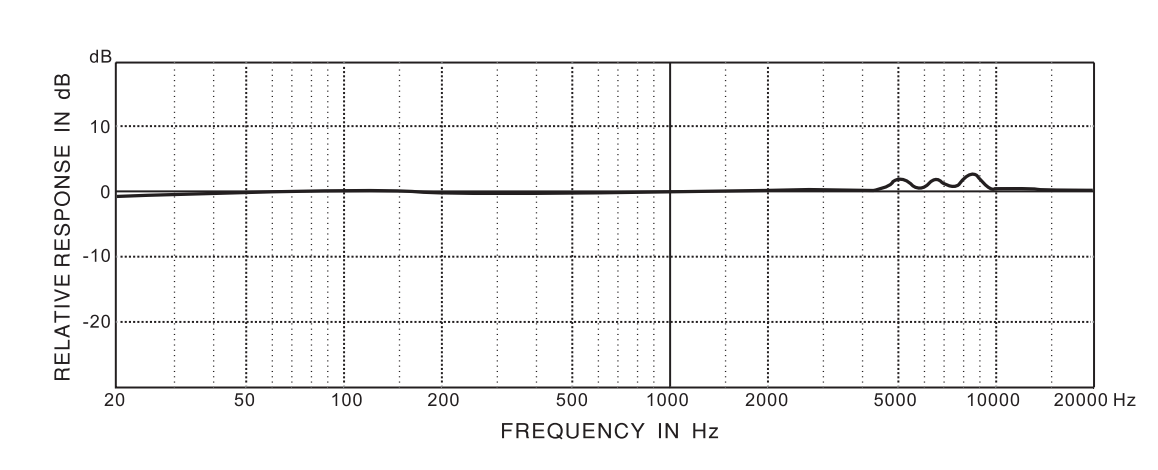

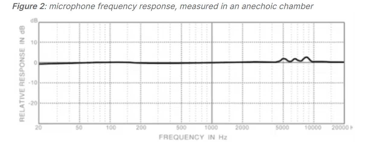

Can anyone confirm or deny whether the Behringer ECM8000, Superlux ECM999 and Sonarworks Xref20 (2015) and Sonarworks SoundID Reference (2021) (but not 2024 model) are one and the same? Perhaps even the same OEM?
Superlux ECM999:
Type Back electret, ̮ 6mm( ̮ 0.24”) Polar Pattern Omni Frequency Response 20-20,000Hz Sensitivity -37dBV/Pa (14mV) Output Impedance 200Ē Min. Load Impedance 1,000Ω S/N Ratio 70dB Equivalent Output Noise 24dB Max.SPL 132dB Dynamic Range 108dB Power Requirements 12-52V DC, 2mA
Reference:
http://www.superlux.com.tw/upload/f...09db2929/resource/20191220-SPEC_ECM999_EN.pdf
Xref20 / SoundID Reference:
References:
https://www.sonarworks.com/legal/so...icrophone-user-manual-2015#frequency-response
https://www.sonarworks.com/legal/so...icrophone-user-manual-2021#frequency-response
Behringer ECM8000:
References:
https://www.behringer.com/behringer/product?modelCode=0506-AAA
https://mediadl.musictribe.com/media/PLM/data/docs/P0118/QSG_BE_0506-AAA_ECM8000_WW.pdf
