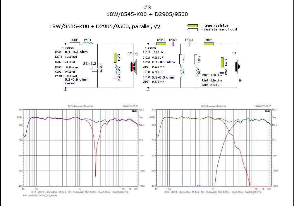

I see you havent replied to my question asking what software you are using for crossover design. Getting the proper driver roll offs, and matching driver levels is very hard to do without seeing how the filter is interacting with the drivers. The drivers you are using are very good...
While this is with the SS 9500/9700, here are some results showing a successful crossover around 2.2khz
Amish revisted
You should be able to get fairly close with the 9500 filter, a lot closer then you likely are right now...
Amish revisted

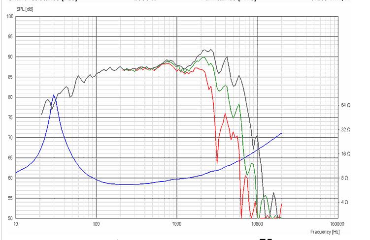

Guy's (who are saying it should be able to work) have you looked at the FR of this SS woofer? I personally think without some serious correction on the breakup 4th order L/R at 1.7Khz is not going to get it anywhere close to out of trouble. Even with some serious attenuation in the 2-3Khz range it is clearly out of its comfort range and will probably still have pretty noticable issues...
It looks to me like it is intended to be used in a three (or maybe four) way, crossing over lower than probably 500Hz...
I think that getting something else (for a two way) is warranted. If later the OP wants to do something more challenging then a three way using it is probably an option

Guy's (who are saying it should be able to work) have you looked at the FR of this SS woofer? .
That's really not that complicated of a filter.

My experience with notch filters is they are only advisable as a last resort. They can get rid of annoying and irritating peaks, true, but the resulting filtered sound can be dull and drab...
I have had the same experience.
