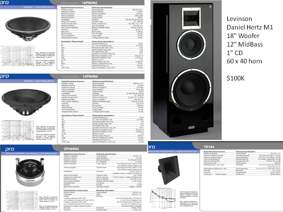

Somewhere I read that the M1 uses all Beyma drivers (could have been here, it certainly looks like a Beyma horn though), if true you could build an exact copy for under €2000.

Somewhere I read that the M1 uses all Beyma drivers .
A review of the Daniel Hertz M1 noted that all Beyma drivers were used. 18db crossovers at 80Hz between 18"-12" and 1600Hz to a 60x40 horn. The review stated that the 12" speaker polar response was near 60 degrees at 1600Hz, and this matched the selected horn+compression driver.

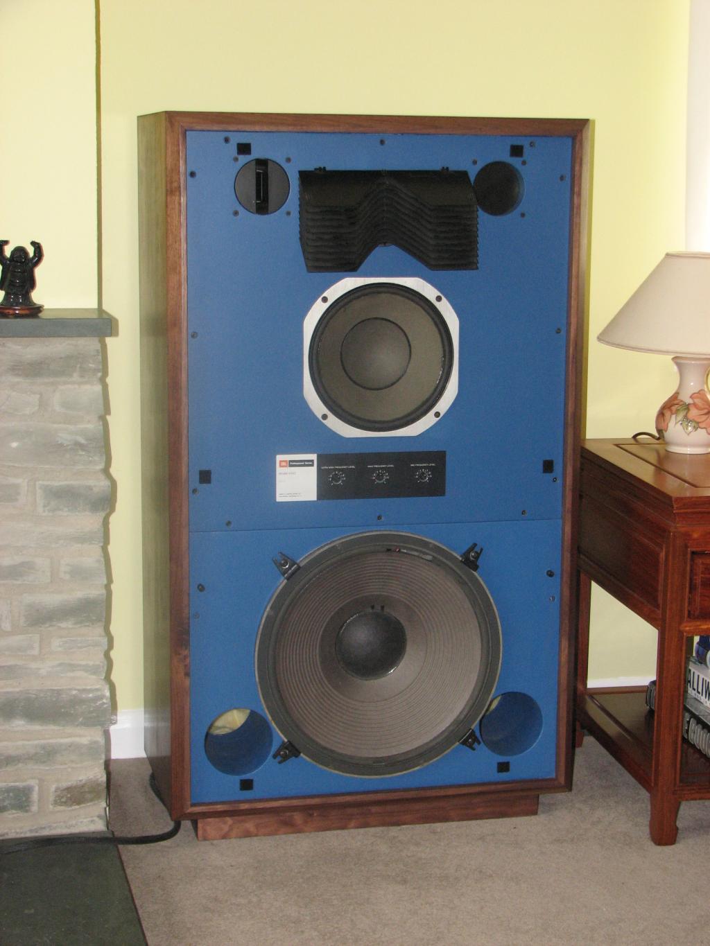

Many old-school JBL and modern monitors use an 18" woofer with LR4 Xovers at 80-100Hz to 10" midbass with steep Xover at 1100-1200Hz to 90x40 horn(SEOS). The polar of many 10" at 1100-1400 matches a 90x40 polar pattern. A 10" midbass like the Lambda TD10M is a cult favorite.
