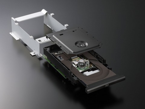

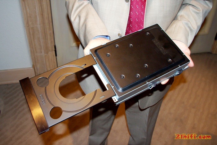

Are there no blu ray transport mechanism versions for top loader design like the CD mechanism Philips/Daisylaser CDpro2 (VAU1254)?
About the used transport mechanism (BD/DVD/CD drive unit)
I don't find any informations as is commonly done at computer accessories.
The type No used by BDP-LX91 (and BDP-LX08) is follow: "BDV-103A-XA"

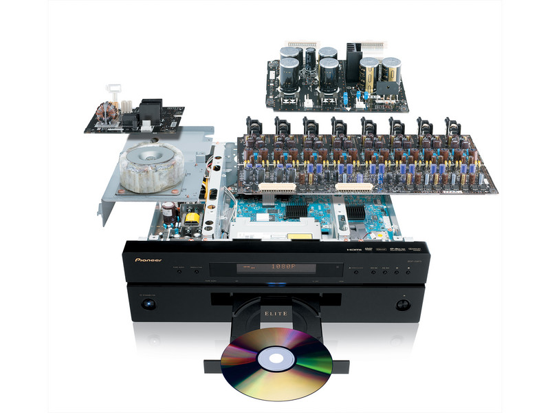

Here any pictures from Pioneer's BDP-LX91 inside:
