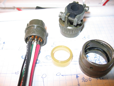

Using Amphenol connectors military serie... PT 06 Serie: MIL-C-26482
14/12 for 12 contacts 8 #20 and 4 #16 {Digikey}
1000 Volts AC
Socket: 15 cad$ pc
Plug: 30 cad$ pc
For my SE 6C33C-B separated power supply's
Driver PS is 420V DC and B+ 250V {Stacked so 670Volts needed}
Very good quality, 4 wires up to #16 and 8 wires up to #20
Alain.

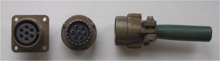

Hope I'ts not too rude to bring this thread back from the dead but its exactly the question I've got...
I'd like a second opinion. Ive managed to get some Cannon-6 connectors (part number MS3106E16S-1P and associated socket)
looking on the Cannon site yields:
Contact Rating at +20 °C (68 °F) - 22 A
Contact Resistance - 6 Mohm
Operating Voltage - In case of voltages greater than 50V the connector must be used in accordance with DIN VDE part 410, IEC 60364-4-41
Insulator Resistance - Acc. To VG95319, part 2, test no. 5.12
and VG95210, part 32, test conditions B,
standard insulator material > 1000 MÙ
Test Voltage - 1600 Vrms
These *look* like they are suitable to having read the earlier posts but I dont fully understand the notes on operating voltage...
I want to shift the 300Vac from PSU box to amp I'll rectify etc. inside the amp itself
Can anyone help me out here? perhaps I'm overworried but I'd much prefer a non-crispy death.
Andy

I use one of those big metal Amphenol 10 pin connectors on my 845 amp with a B+ of 850vdc and its been fine for years now. As long as the connector shells are grounded I'm not worried. Once things get into the kilovolt range then I'll worry Have you looked into anything by Jaeger?
Its probably pretty self evident if you know what youre doing but my problem was that I don't get the quote, "...must be used in accordance with DIN VDE part 410, IEC 60364-4-41",
I was looking for an explicit "use upto X volts" maybe thats in the spec and I can't see it?
The connectors I have very similar to the Amphenol ones I think?
Anyway a picture says a 100 words so...
Andy

The problem is that EU regs are moving the goal posts regarding voltage. I've had a number of quite contradictory quotes from Neutrik about their XLR series. for some reason they've adjusted the safe voltage down - seems totally beurocratic to me, but there we are. And the Neutrik speakons are surely capable of much higher voltages than quoted. The people who lose out on all these regs is us tube users - it's annoying not to know what actually is the safe voltage, not just some rounded off figure that satisfies a bean counter in Bruxelles.
Personally I've been collecting the odd numbered XLR series - 4,5,6 pole, plus in all these cases you can add another connector since earth can be carried in the body of the plug. Unified housing so it's easy to make a few holes for them and then select what's necessary, blanking off the unused holes. I reckon these are OK for 300v - particularly the 4 pin ones.
Eusebius said:The people who lose out on all these regs is us tube users
having just spent the afternoon in th ecompany of RoHS compliant solder I *very* see your point..
If you can get 300v across an XLR then these'll be OK - anyway I'm going to go for it! Guess you have to be empirical
Andy
