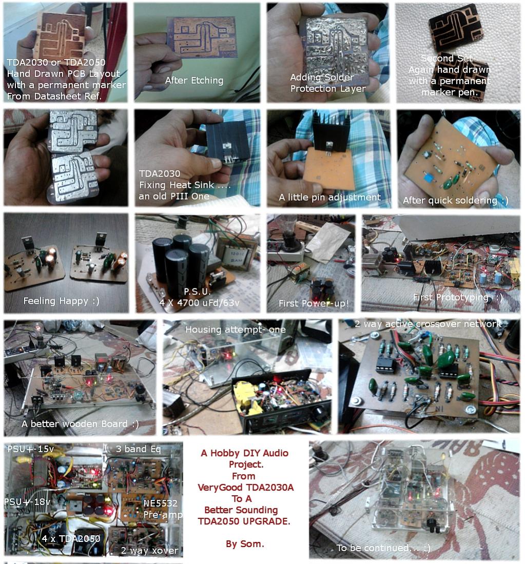

Hi all :)
I am very happy and feel privileged to find such exhausive and valuable information about audio by so many experienced members here.
This is my first post here and hence quite unsure where to post my queries.
My main amp is a high power mosfet one. But hearing many good things about TDA2030A, I attempted to build them following the pcb layout in the datasheet. I was so pleasantly surprised to see the result that i wanted to upgrade to TDA2050.
Currently I am using 4 TDA2050 with a 2 way active corssover system with a 3 band equalizer and and a NE5532 based buffered preamp. I had a listening session with my 6 friends who uninamously agreed that they heard a very true to life sound with excellent stereo imaging, surprising minute details that was absent earlier. And we had no prior exposure to any really high end audiophile system to be honest.
The output is more than adequate for my very small listening room. And I play it at a very low volume.
So my question ....
1.Do I really need to upgrade to LM3886 or anything better in my situation, in a near field listening environment? (LM3875 is hard to get in my locality)
2. Is an active 2 way crossover system better than a 3 way system in a small room?
3. I was unable to find OPA2134 yet , so I am using NE5532 for the time being. I want to swap opamps just for a test :) Could you please recommend some latest commonly available ( better) opamps?
Thank you all,
With warm Regards
Som
