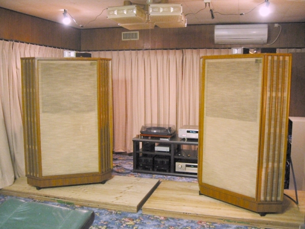

Please do. Also have a listen what the Tannoy Dealer has. Note, I cannpt recommend any mainstream Speakers from Tannoy, STRICTLY only the historic lines no later than the Monitor Gold (not HPD, not any of the Super Red or Super Gold) and the current replica's which are only in some of the top models of Tannoys "Prestige" range, basically strictly the Westminster Royal, Canterbury, Yorkminster and Kensington.
I cannot recommend the so-called "Tulip Waveguide" Tannoy coaxials or any of the non-coaxial models, they are at best okay.
My suggestion instead is to buy some historical drivers of e-bay (< 2K GBP) and to have a pair of GRF Autograph enclosures made locally (<1K GBP), which will give you a speaker with a performance at least equal to the Westminster Royal.
Tannoy actually made one runs of the GRF-A for japan (Autograph Millenium), where they are more expansive than any other Tannoy model and more sought after.
Here some more Autograph info:
tannoy
And a Picture of the beasties attached...

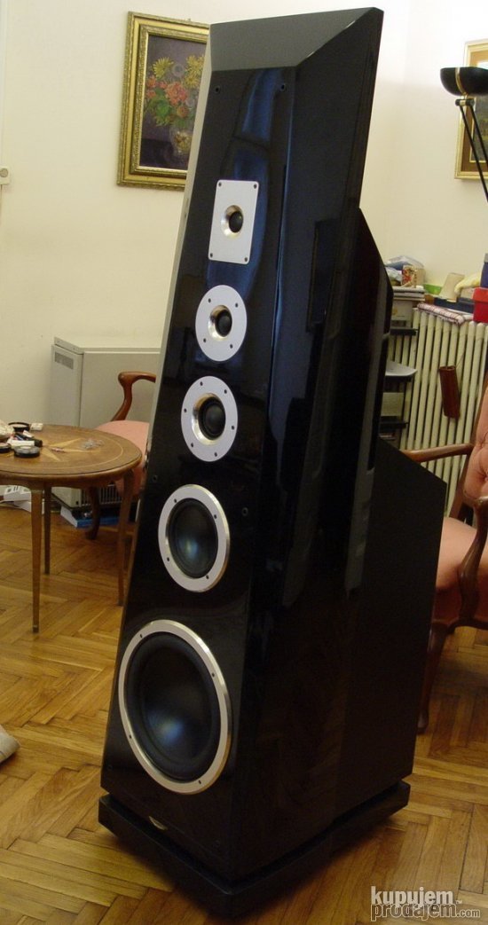

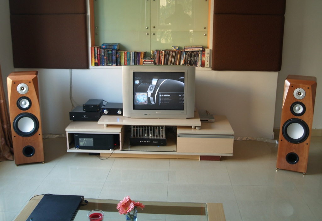

Hmm, the speaker is complete generica in terms of design. To suggest it works well with low power tube Amp's seems a little adventurous.
If not in looks, then in terms of general it seems comparable with what is playing in my living room (10" Woofer, 5" Midrange, Circular Ribbon Tweeter Floorstanding), which is around 50m^2 and not heavily damped.
At least in that room an EL34 Push-Pull Amp with around 35 Watt is insufficient for really loud (realistic) levels with classical and jazz that has not been compressed to death.
But maybe those guys never play music loud?
Well, it looks like some of the older Dynaudio Models. These 5-Way systems where kind of interesting in the 1980 (e,g Pentamyd) but the resulting sound was, how shall we say, interesting...
Getting a 5 Way system to work is seriously challenging...
I'd expect them to cost less than the CAV ones, at best similar (and similar sound as well, probably not as good). Again, do go and listen, maybe they actually are very good, despite being of a kind of design Dynaudio never got to work right...
tannoy

That jungson seems quite impressive by the way!
Bet its not in the 3k gbp range

I attach a piccie. The enclosures are cheap commercial ones, which I lined with stone fillets internally to get rid of the panel vibrations. Crossover is a first order series type. Total cost with copper foil inductors, silver wire and all that, drivers and enclosures was maybe 450 Quid. Generally audiophiles that hear them seem to think they are quite something, I think they are okayish.

so what you got playing in your living room now?

Actually, the cabinets where bought empty, with the holes customised to fit the drivers I had. They originally fit a HiVi/Swans Kit. Cost was very low. Build quality was (as I expected) so-so, rather resonant, but the finishing was okay.
I lined all interior surfaces I could get at with stone slabs, put in place using 2-component epoxy. The combination of the MDF panels with the stone slabs makes a very non-resonant enclosure.
I also used some "right size" ceramic flowerpot as sub-enclosures for the midranges and removed the stuffing from cheap pillows for use as damping material.
