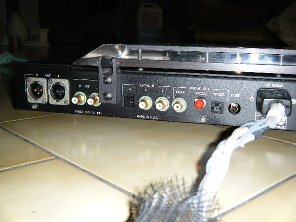

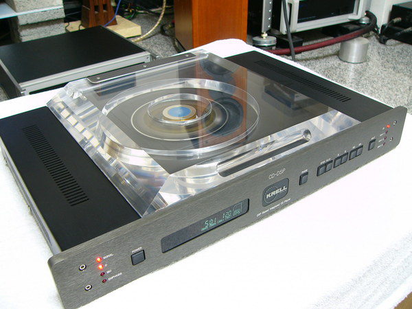

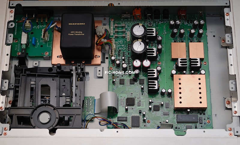

Which CD-Players offers Dig-Inputs to use the internal DAC for DAB/DVB Radio ?

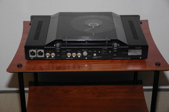

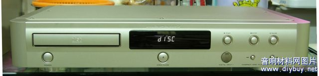

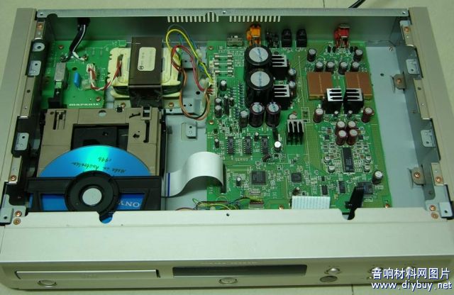

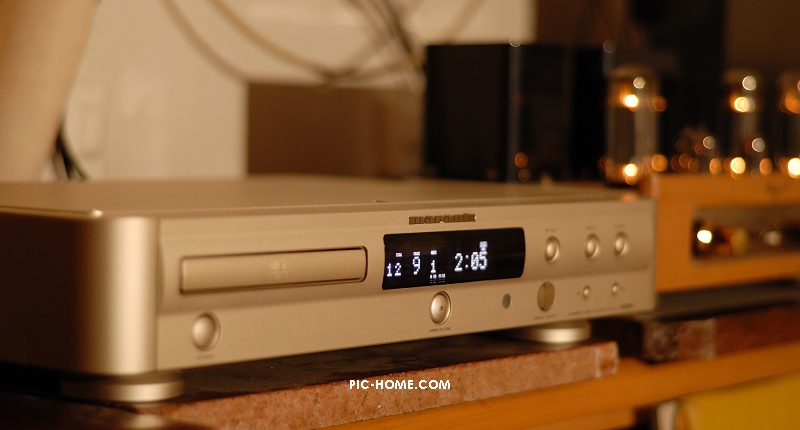

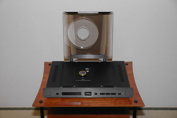

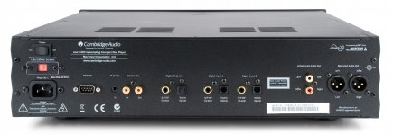

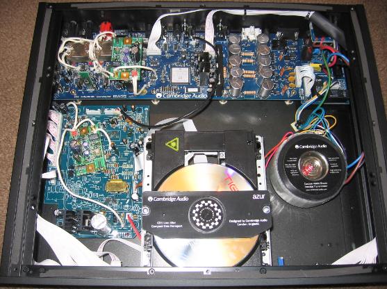

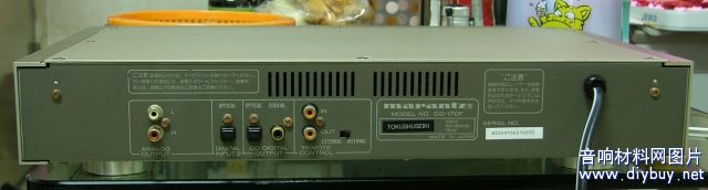

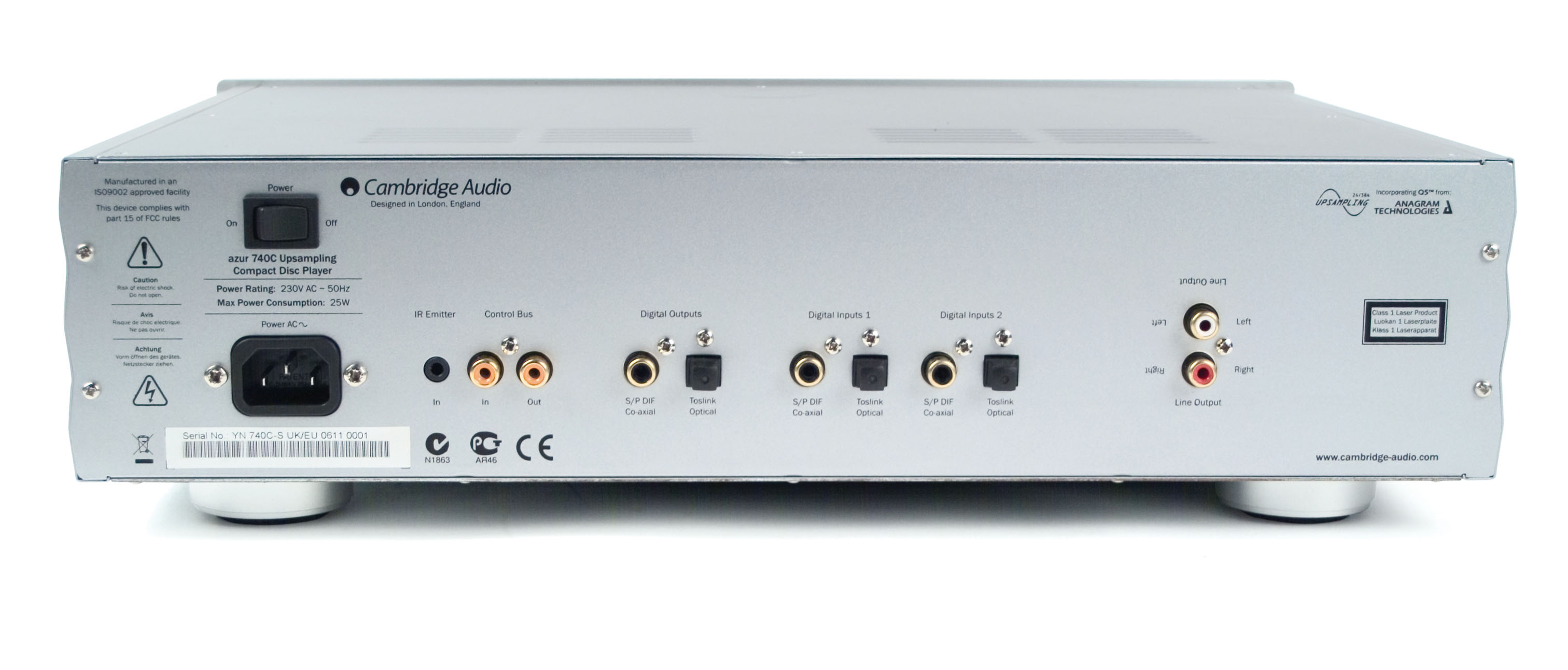

Some users like it to have very low pieces of components. For this users are compact disc players of interest, where the "Indoor" D/A concerter is also available for other digital sources like MD-players, dat-recorders, DVB and DAB radios so as additional cd transport units.
Therefore are S/P-DIF digital inputs necessary (at least one coaxial or toslink input).
Two models, that meet this requirements, I know (see attachement):
1) Marantz "CD 17 D" (CD17D, CD17, CD 17D), CD 17 A (CD17A)
2) Krell CD-DSP (CDDSP)
But I am sure, there are some few models - probably not very many.
Where I can find URLs with overviews?
Thank you for your advices.

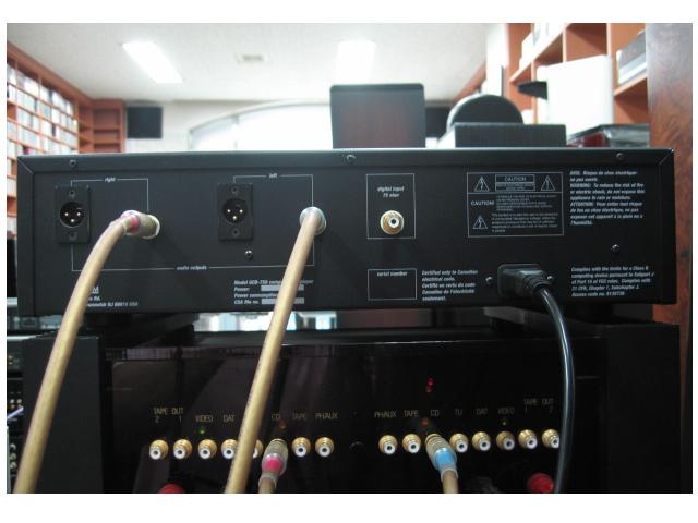

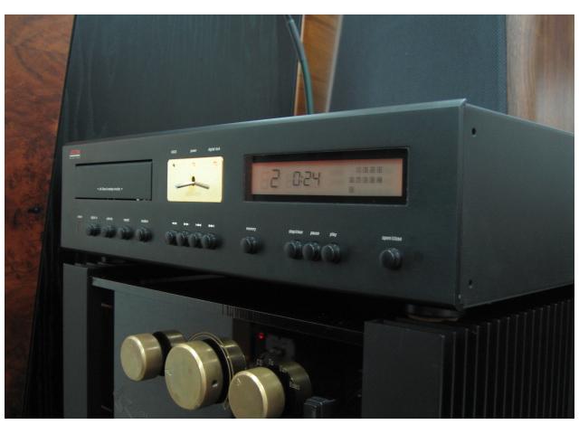

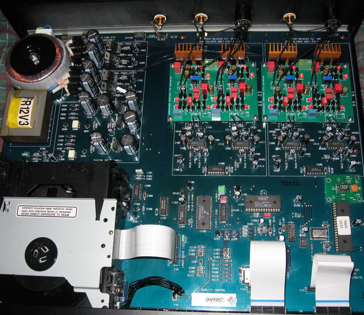

The venerable Adcom GCD-750.
Are there differnt versions (MK-II, MK-III)?
By the attached photos only one digital connector (chinch coax) is present. Is it a dig. input instead the most present dig. output (on the second pic not clearly to identify).
On the main PCB I read "IN_AUX".
The DAC section works with 4xPCM1702 and discrete filtering stages - very promising regarded to the sound quality level.
The optical pick up seems to be the same than that one from Acurus ACD-11 (ACD11), model No RAE0113Z, RAEO113Z from Technics/Panasonic. Also the PCM-decoder + servo PCB: Technics RJB 1123A (CU3C).
Indeed - the dig. coax female connector allows the connecting of an external source to be processed by the internal dac (dig. source selector = No 6 on the front pannel right near the IR sensor and the S/P-DIF receicer chip is the CS8412, second photo).
http://www.adcom.com/data/manuals/gcd_750manual.pdf
But I don't read facts about various sample rates (dig. radio 32KHz instead 44,1KHz). Maybe a sample rate converter is necessary.
