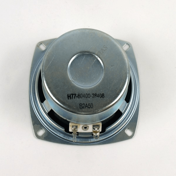

I found this driver that was part from a Beringher pair of active speakers.
Its seems to be 4R driver ( I measured using multimeter)
How can I know the rated power of that driver?
Which amplifier is recommended?
The amp should be run on 12V
the use is for outdoor listening in fairly quite environment so volume shouldn't be too strong.

but it might be overkill?
If you have had a favourable experience with that amp board then go ahead and use it in your current application.
Don't be fooled by the amp's exaggerated "maximum 100 W" rating.
The available power output depends on the supply voltage used. Using 12 V would reduce the available power output compared to using 24/28 V.
Is there any way to know the max output watt available if using 12V PSU?The available power output depends on the supply voltage used. Using 12 V would reduce the available power output compared to using 24/28 V.
The input of power to the amp depends on both the voltage and current capability of the chosen power supply.
A 12 V; 2 A DC supply could deliver a maximum 24 W of power to the amp (power = voltage x current).
The output of power to the speaker cannot exceed the input of power from the supply.
So, you'd be lucky to get a maximum of 20 W output from that amp using a 12 V; 2 A DC supply.
