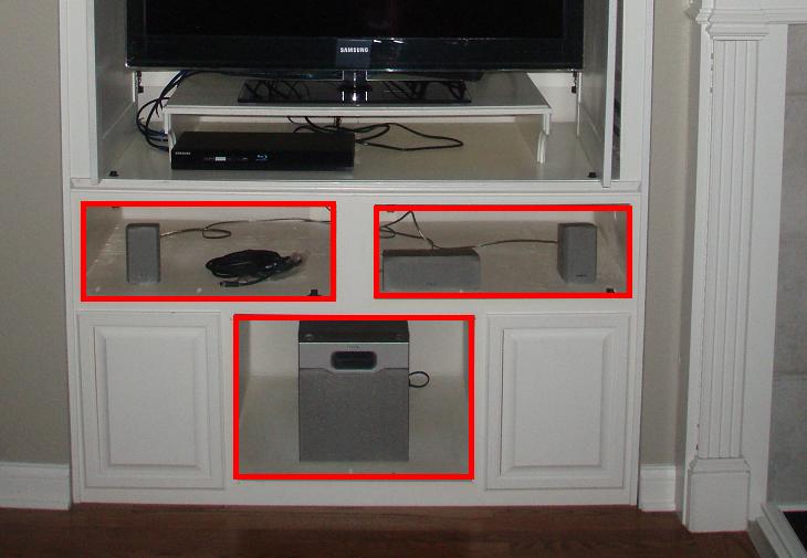

Guys, I need suggestions for a $150 or less 8" full range or coaxial.
This will be used primarily for pop music and home theater. Not for me, but some friends.
Needs to have decent off-axis response.
Unfortunately, these will be built into an entertainment center and spaced much closer together than ideal. See picture below for what I'm talking about. I will at least space the speakers as far apart as possible, in their respective cubby hole enclosures. I will be making the enclosures from 3/4" MDF.
A 15" sub will be located in the bottom cubby hole.
This room is about 3500-4000 cu.ft and leads to a kitchen and dining room, so probably more like close to 7000-8000 cu.ft. Pretty un-ideal. So I'm looking for best dynamics possible. We are NOT allowed to place the speakers anywhere other than the cubby holes. :(
Assuming a 40hz tune & 8" speakers, each cubby hole has 1.8 cu.ft. internal volume still available.
Not sure which AVR will be used yet, but likely something rated around 80 to 100W/channel. Like an Onkyo TX-SR6XX or 7XX.

I'd definitely try to fill the holes completely, preferably with enclosure volume, to avoid nasty resonances. Plus, it'd pretty much be an infinite baffle (although perhaps not ideal as far as diffraction goes), which has plenty of advantages (smoother overall response, lack of baffle step issues, reinforcement of low frequencies, sometimes better distribution of low frequencies, etc). Also, there are some ways of attempting to get a good stereo image with the loudspeakers placed close together, some of which I've actually found somewhat acceptable and interesting.. this might not be very feasible for you though. Exhausted, as usual, so it's tough for me to think clearly, as usual. I'll post back if something pops into my head.
Are those multi-channel receivers? I first assumed this was just going to be a 2.1 channel system.
Yes, from your description, I'd agree that good off-axis response would be a good characteristic for this system to have. That pretty much rules out full-range drivers, other than maybe 3", which unless used in an unconventional manner as a tweeter with a low shallow slope crossover to a wideband midbass driver, it probably wouldn't end up being much better than what's already in the picture. Such a system probably wouldn't meet your criteria for "dynamics" either. On the other hand, early floor reflections might be an issue, especially with coaxials. A large unusually thick rug might help alleviate some of this.
As far as coaxials go, there isn't much to choose from in the consumer market, but plenty in the pro audio / live sound market. However, they tend to require very complex crossovers, along with high acoustic slopes due to the use of a compression driver. Not sure if this is your cup of tea, or if it's within your capability. But yes, I do see where the use of a coaxial would be beneficial. Some of the manufacturers have passive crossovers available, although they're probably far from ideal. 8" you say? Quite a few of those. The Eminence models might seem like a good deal at first glance, but as is common with these dual concentric drivers, the high frequency response from a compression driver when used with these models is particularly horrific, imo. With that said.. Beyma, B&C, BMS, Ciare, P.Audio, Eighteen Sound, and Radian come to mind, and I'm sure I've likely missed a couple. Prices for these drivers tend to get pretty steep though, particularly when it comes with a compression driver. You might do best searching for a trusted design for one of these coaxials. If I'm not mistaken, there might be some info out there for the B&C 8CXT. I know for certain that B&C, Beyma, and Radian all provide passive crossover networks for some of their coaxial units, if you must go that route.

So you want to cram a stereo pair of speakers in a cubby hole? :eek:
Understood, I built a center channel speaker in the WAF location, 30"W x 6.5" tall and 15" deep--a "2.5 way" sealed box with four 5" woofers crossed at 1.8 KHz to a 30mm WaveCor tweeter. Two of the woofers roll off at 450Hz 6/dB (coil) for baffle-step correction and it works very well.
Full ranges are fine but you said the evil word "off-axis response". The MTM arrays work well in horizontal position if you follow the rules as far as beaming goes--horizontal forces the issue.
Another option is to use a conventional 2-way with tweeter and 4" midwoofer in vertical orientation at the edges. Cross two 6" woofers at around 300 to 400 Hz to get your baffle step. Push the pair of 6" woofers toward the center then cross your sub at 80 to 100 Hz. The vertical tweeter-mid will solve the beaming issues when laying speakers on their side.
I considered doing the same thing for my WAF center channel--the off-axis response to cover the area I needed covering killed that idea quickly. Also consider the people might turn the subwoofer off for music, since they listen to pop...the dual 6" woofers would take the load.

Build them into a sealed enclosure MTM style (horizontal obviously). This style with those planar tweeters will give you a nice, wide horizontal and narrow vertical dispersion which is what you want and NEED in this kind of limited setup. I would do a simple passive 1st order series crossover for them.
And speaking of crossovers, I would cross them over to the sub around 150-250Hz since they are all in close proximity to each other. That relieves the fullrangers of heavy lifting and allowing them to do those dynamics without much stress, plus either one of the sub drivers mentioned above can easily and cleanly handle those frequencies.
