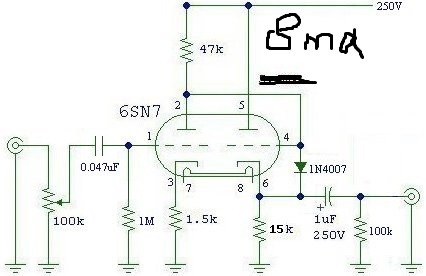

How about this?
Not for headphones, though. Not even if the headphones have 300 ohm impedance.

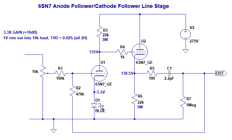

I'm not sure I understand what's good about that Blue Velvet circuit. With only 4.5k ohm plate loads, those 6SN7s are being loaded down heavily. I put the circuit into LTspice and it looks like the distortion would be quite high at 1V rms (typical line level) out into normal loads. Am I missing something?
Well, it seems to work quite well, and drives the 6L6 nicely. Good clean, and linear.
Given, the only test for distortion is my (tin) ear. But the plates don't glow, so I suspect it's not being over worked. ;)
I built the Blue Velvet 6sn7 pre amp, for my 6l6 amplifier. It works quite well.
I did, however modify it slightly, by using 12sn7 tubes.
This design looks like someone was going specifically for the "tube sound" and intentionally misloaded the tubes to give lots of lower-order distortion.
Eh. It's not that they would glow if run incorrectly, they just wont work as well as they should. They may sound fine, but it would likely be much better with plate loads a decade larger.

I prefer the Blue Velvet topology, avoiding hybrids, SRPP, differential stages, mu followers, voltage followers, feedback, diodes... It is difficult to adequately estimate DC bias levels and load driving capability.
With that many restrictions, I think you've painted yourself into a design corner. There's no way to get a tube to drive a 300 ohm load without negative feedback involved. Remember that a cathode follower is a tube with 100% negative feedback applied.

I've built the following circuit, and many variations thereof, many times over the last ten years or so. It's a very adaptable and clean circuit, with less distortion than the SRPP circuit. If you will use it with multiple sources, leave the input capacitor in to block DC from the input tube grid. It's very easy to build, and if you use a decent power supply you will be very pleased :)
The 6CG7 will work perfectly in it, and will require no parts changes. Gain should be ~10 or so. The diode isn't strictly necessary, but wont hurt a thing or effect sound quality in any way. It protects the grid during power-up and then reverse biases itself out of the circuit.

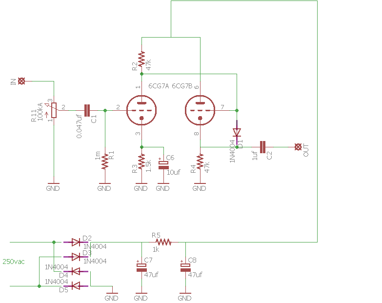

Hi Lingwendil! I just finished building this circuit into what was an older and no longer used 4S Universal build. I used 6CG7 tubes and reused the 250K volume pot, but it doesn't have enough range, and it is full blast in a quarter turn. I suspected that this might happen, and will replace the pot. I see that the schematic shows a 100K pot, but would a 50K also work as I have one handy?

I'm not lingwendil but if you are talking about the circuit in post 92, 50k will work fine but it won't solve the problem of too much gain. Omit the cathode resistor bypass cap on the first stage to reduce gain and distortion.
All help is appreciated! I am referring to the circuit in post #54. In this circuit, the gain is supposed to around 10X, and that appears to be about right based on using it. From zero to full blast is less than a quarter turn with a 250K pot. Here it is for quick reference....

^ That is better than post 92 circuit but It still seems like too much gain. I see 19.5dB, roughly 10x and I would be shooting for 10-13dB 3-4x. Either way swapping to a 50K pot won't change much in that regard. As a kludge you could try the 50K with a resistor around 47K in series from the input to the top of the pot. That would put the gain at max volume somewhere around 13dB
Thanks Martyh. I actually found that I had a nice a 100K Alps Blue Velvet pot, and have installed it. The volume works normally now. There is an issue in that the circuit generates noise, it sounds like a light hissing, that goes away only when the pre-amp is at full volume. Any thoughts on what that is and how to fix it?

Huh, that makes no sense to me. Did you have a linear pot in there the first time? Regarding the noise, What is the input attached to when you hear the noise? Does the noise level stay the same as you rotate the volume control?

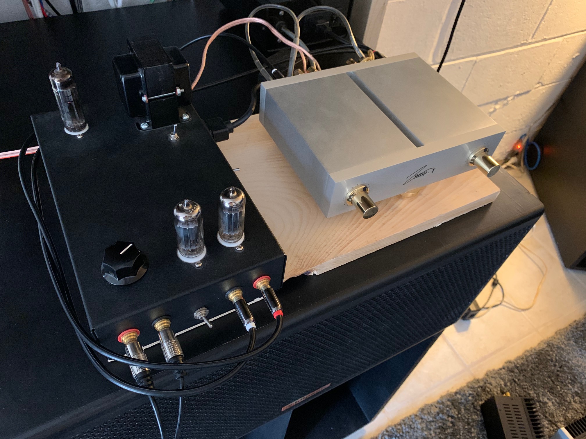

I figured it out. Messy soldering. It’s all fixed up now and sounds great. Here it is feeding a Peter Daniels’ Audiozone Amp-1 that has an input impedance of 10K Ohms. It’s very quiet and provides the gain I need for when I use my phone as a source, or a volume control for the low input impedance amps I have such as my Amp Camp Amps.
