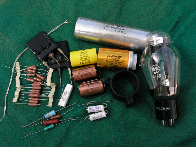

resisters arrived. Pls see th photos. All were use in my kits.
The Biggest one was made by noble( Japan's Made) & some carbon resisters will use in the kits too.
All were excellent quality./

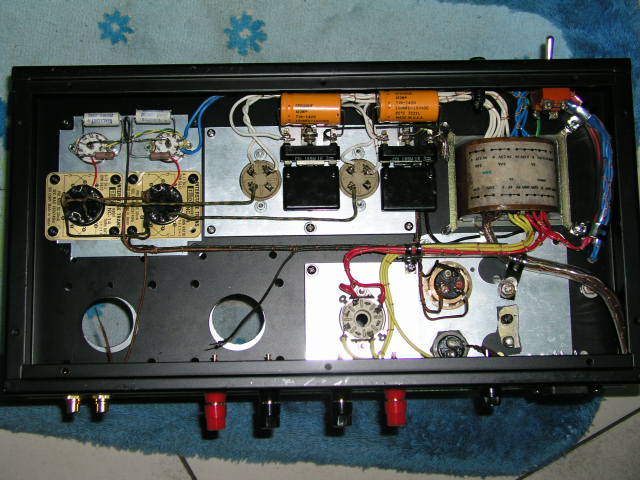

This is my 300b project.
the simple & good sound.
pls see the layout.
any suggestion to improve is welcome.
thanks
thomas

hi Mach_y,
I canno got your mail. Which mail box U send to me.
There was still had a little space to improve.
The improve point is the brown wire which was beside the yellow wire.
I want the coming power trans put the primary winding into the lower side, now is the upper side. The can use shortly wire to connect the AC power, less chance to take the AC noise. I test already. The sound will get a little bit silent than the old tower trans only improve this point.

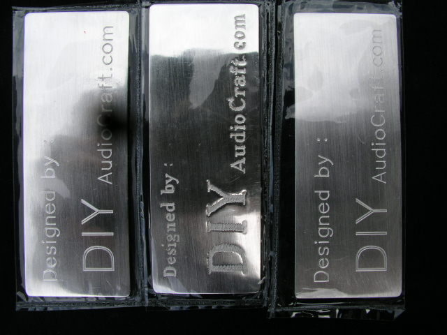

Pls see my Brand name of the kit.
I made three type for diyer to choose. All use 99.99 Pure silver to hand made. The middle one is use hammer to punch the words. Other tow was laser trimmed but one was flash surface, the another one is sandy surface.
NIl coating for the silver plate. But use 99.99 pure silver plate will oxidized with a little gold colour, not black. is it very well.
I will not put the plate into the chassis. the diyer can decide the location of the plate by thenselves.
DO`IT`YOURSELF~OF COURSE>>>>>>>>>>>>>>Yeh!!!!!
Every plate weight 12.82~13.86 gram weight 99.99 pure silver.
