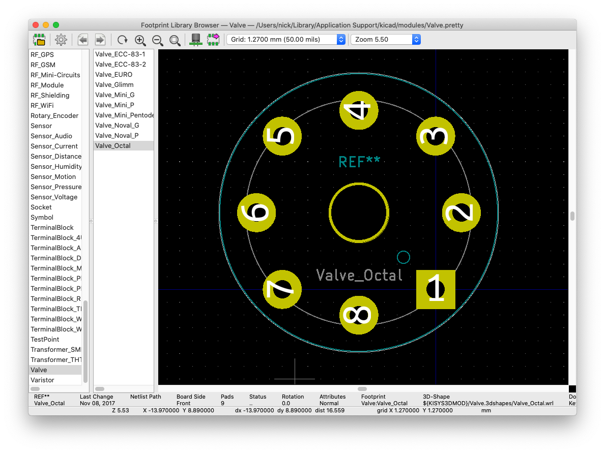

With the current version of KiCad having a selection of valves - does anyone have an expanded library already built?
Just the same way - specifcally 6SN7 and 6AS7.
The library has the following foot-prints, but not the defintions - including Octal.
I've created a 6SN7 copying the ECC88 and changing the footprint to octal. The ECC88 has 3 units (A,B &C) corresponding to triode 1 (A), triode 2 (B) and heater (C). I've also shifted around the pin designations given the pins are different.

I'm getting started making pc boards for the last month or so, I've found it much easier and way more more accurate to make my own tube socket footprints. As long as you have a sample socket and a digital caliper its real easy. Measure the pin to pin diameter. For a 9 pin noval simply create a 10 sided polygon of the diameter needed, put on snap mode and drag your pads to snap onto each vertex. Then delete one of the pads. Delete the polygon. Now save the footprint with only the pads. Also you can measure the size of the pins in order to get the pad holes perfect for that brand of socket. I'm using a $49 program called Sprint Layout to make my boards. Different brands of sockets have different circle diameters, so this is a no-compromise approach you get a perfect footprint for the socket brand you want to use.
