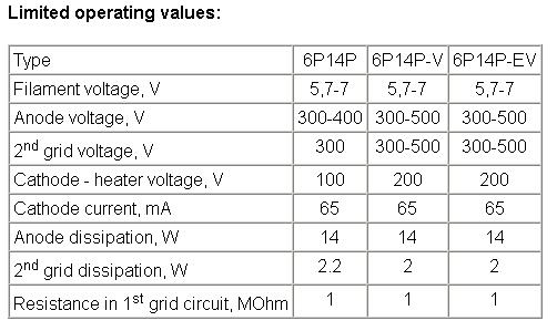

Where did these EL84 numbers come from?
Looks like he is talking specifically about the Russian versions and not NOS. Here is some data I found using Wayback:
