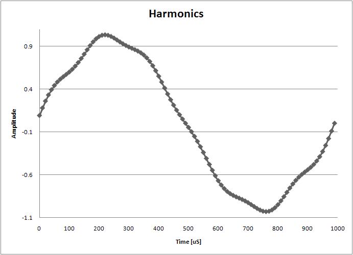

Utterly :bs:, Lumba. You either picked those graphs out of context, or those graphs are flat wrong.
Look at fig. c That cannot be the graph of a sum of harmonics. Proof: A sum of sines is as much an odd function as the sine itself. This means that:
a1*sin(w*t)+a2*sin(2*w*t)+...+an*sin(n*w*t) = -(a1*sin(-w*t)+a2*sin(-2*w*t)+...+an*sin(-n*w*t))
OTOH, sin(n*w*t) = -sin(n*w*(t+T/2))
The above shows that a harmonic sum should be symmetrical against the x axis and t=t+T/2
Graph c) obviously isn't. I can tell it has some non-harmonic components added, something like sin(n*w*t)^k The same in graph b), it's asymmetric as well.
Attached is the right graph to replace c) for a 1KHz fundamental (I didn't bother to normalize the amplitudes).
I'm not saying that THD is anywhere the universal QA metric, it's just about using the right arguments. In the future, if you need to make a point, do yourself a favour and stick to the subjective stuff. Apparently, everything else might blow straight in your face.
