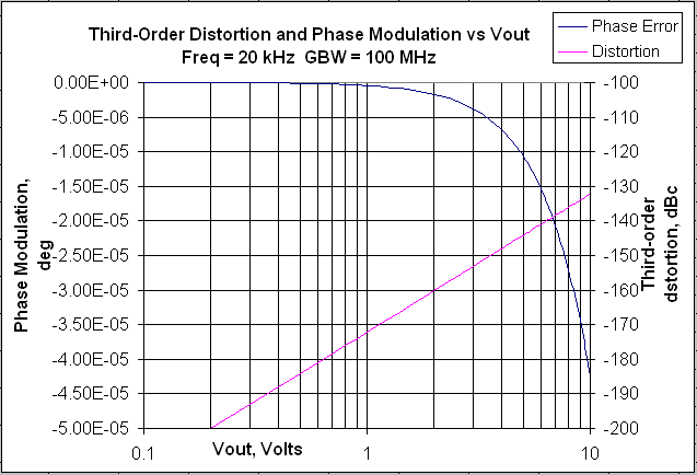

Some preconceived ideas from an old fuddy-duddy (me)
Back in this post http://www.diyaudio.com/forums/showthread.php?postid=493105#post493105 I plotted Gilbert's equations for an op-amp operating at a frequency of 1/100 of the gain-bandwidth product at a gain of 10. The phase error as defined in that post and in this one is the phase shift with input stage nonlinearities included minus the phase shift assuming a linear system. Output voltage ranges from 0.1 V peak to 10 V peak in 0.1 Volt steps. That post showed that when the phase error reached 1 degree, the third harmonic was at a level of about 0.5 percent.
Suppose we are looking at a very good op-amp such as the AD797, with a gain-bandwidth product of 100 MHz. The plot of the post referenced above corresponds to a frequency of 1 MHz for the AD797, since the test frequency is 1/100 of the gain-bandwidth product. This begs the question of what happens to the AD797 at a frequency of 20 kHz? I had the equations in MathCad already, and the results checked with Gilbert's for the previous post (that's why I chose this frequency originally, to allow comparison with his results). All I had to do was change the frequency to 1/5000 of the gain-bandwidth product in the MathCad worksheet and re-run it. The results are plotted below. The closed-loop gain value is 10 as before.
It's hard to see the exact value on the graph, but at an output voltage of 2 V peak, the phase modulation is 1.7 * 10-6 degrees. That's not a typo.
Based on this data, I'd conclude that the whole PIM issue as far as op-amps with a very wide gain-bandwidth product (like the AD797) are concerned, can best be described here.
