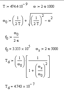

MikeB said:1khz: 0.1708° -> 474.4ns
5khz: 1.2350° -> 686.1ns
Difference: 211.7ns
(Values doublechecked)
Here's what I came up with for a single-pole circuit. A group delay of 474.4 ns at 1 kHz corresponds to a -3 dB frequency of 335.5 kHz. Sounds good. Plugging that back in to the group delay formula shows that the group delay should be 474.3 ns at 5 kHz.
The group delay should be maximum at DC, going to zero as the frequency becomes large.

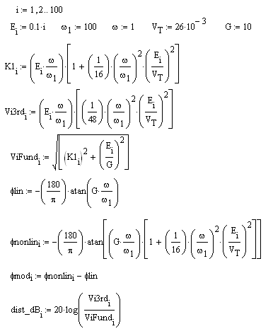

john curl said:Folks, something is wrong. Either the dynamic phase shift manifests itself as a separate entity, or Barrie Gilbert is barking up a tree.
John, the third harmonic is part of Gilbert's calculations. I quote:
"The third-harmonic distortion is the ratio of the second term in (15) to the vector sum of the sine and cosine fundamentals in (17). Since we have chosen to work 'backwards' from input to output, this is the distortion referred to VIN. For moderate levels, though, the percentage is very similar whichever way round the calculation is made"
Then he goes on to compute the third-harmonic distortion at 2V, 4V and 5V output. I've just generalized this to do it all the way from 0.1V to 10V. I've attached a capture of the MathCad worksheet used to compute this, which I checked against his results for the levels he computed. 'E' in his notation becomes 'Ei' in my notation, because the subscripting is used for arrays in MathCad (E = 0.1, 0.2,...10.0). Gilbert is in no way, shape or form making any claim that the variable phase shift with level is somehow independent of the third-harmonic distortion term. To see this, you just have to go through the math in detail.
Is the distortion, with or without negative feedback applied? I seriously doubt that you can get .5% distortion or so, AM distortion from a single frequency with today's audio grade op amp. Isn't Barrie showing the open loop distortion rather than the closed loop distortion?
It's the closed-loop distortion wiith a closed-loop gain of 10 at a frequency of 1/100 the gain-bandwidth product. I used this because these were the same conditions Gilbert used, so it allowed me to check my answers against his for the levels he used.
For a 797, this would correspond to a frequency of 1 MHz.
Also, this assumes "weakly nonlinear" behavior. To work backwards from output to input with the tanh() function, he had to approximate the inverse hyperbolic tangent function as atanh(x) = x + x3 / 3.
This makes the third-order distortion proportional to amplitude squared, but this only holds for the weakly nonlinear region. That is, we'd need all terms in the atanh() power series for it to give correct results for very large signals.
