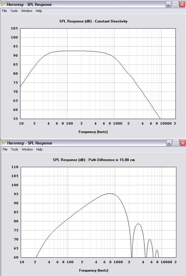

not 79dB 1wmtr is faulty it is 78dB 1wmtr.here two eminence alpha in series ad 3dB for serie config and then with four drivers the cut of is 35hz and spl will be 79dB 1wmtr.

The series resistance helps to chance the behaivour of the response like you want to see. Like I show here.
And see the same driver with out series And when the impedance of 8Ohm is to high use another pair parallel.
Yes, the series resistance changes the Q. That's going to change the response. So will a 6 ohm resistor.
But from a practical standpoint series doesn't work well. 2 drivers in parallel do. But don't take my word for it, try it for yourself! And if you do like it better, you can say "I told you so!!"
