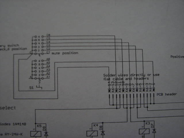

I think I have wiring sorted, and I hope pics too.
One question: Point C on diagram of switch shows 2 wires going there. one from 1-2, and another from 13-14. Is this one from 13-14 "in the circuit board" and only the one from 1-2 to C (center post on selector switch) I think?

Russell.....just relax and ignore schematic, if it's making you confused
go back to #815 and read it few times
look at bottom side of pcb , observing IDC connector pins and you'll get it
where I wrote pair or two pairs of pins, being together - they are together electrically, carrying same signal
example - pins 1&2&13&14 are all tied together, routing Relay+ rail to switch
pins 3&4 are tied together, bringing back Relay+ rail (from switch) , to energize Relay 1, enabling input 1
etc.
in any case, until you grasp it completely, do not power it

Guys (not ZM)—would it help at all if I pointed out that the reason there are 2 rows of contacts in the switch zone is because the header blocks you can buy drop right into ZMs layout and fit ready made ribbon connectors that all have 2 x 14 contact points? I was making things very complicated in my noob mind trying to understand why there were 2 rows when it seemed I only needed 6 connections to make it all work.... (...until 6L6 fixed my brain....)
Also, I elected not to hook up a mute position. So I only have the common plus 5 wires running to the Lorlin switch. Common (pad "2" in my case) to "A" on the switch. then 1-5 on switch connected to 4,6,8,10,12 on Iron—No mute in my case—didn't see the point. Then if you want LEDs to light—pull a wire off V+ with a resistor in series for whatever brightness you are going for—connected to "C" on Lorlin switch. Then connect each LED + to the opposite side of the switch for each relay trigger. For "4" on Iron ("1" on Lorlin) which is the first relay the corresponding LED would be "7" on Lorlin and around you go 2/8, 3/9, 4/10, etc. Connect all the LED grounds together and run them to ground on the board. I used the cathodes bent at right angles to make a support bar for the whole LED lineup so it holds together. See post #667 which has my image in it... you can blow it up big enough to see most of the connections—the color coding wasn't to be pretty.

I'm pretty sure I've got it sorted in head now. Just wanted to make sure of "second" wire in schematic wasnt something I missed.
Looks like pin #1 will go to C on selector switch. 4,6,8 and 12 will go to respective places on five selector pins of selector switch. I will post pics of wiring before powering up.
