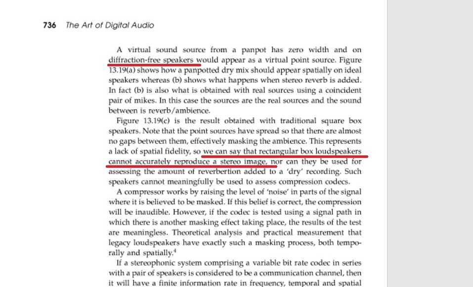

Can be of interest here:
We need to talk about SPEAKERS: Sorry, 'audiophiles', only IT will break the sound barrier ? The Register
Most legacy speakers have massive point spread functions due to diffraction from inept enclosure design and their stereophonic images are badly smeared.
Point spread function (left) before servicing (right):

Since most of the musical instruments except piano and pipe organs are about the same human size, I guess those sharp edged speakers may intend to focus on vocals or each instruments, rather than focus on the whole sound stage. Small speakers may project miniature sized image. ATCs are not good speakers in terns of the sound stage, but they do project very believable image of the each instrument. I guess BBC monitors may focus on the human voices.
I still think the old style horn speakers with bad horn edge diffraction are the best for Rudy Van Gelder recordings, but it's probably because the diffraction of the horn imitates the sax or trumpet very well. They sound horrible for the classical recordings, though. I think the speakers failed to control diffraction tend to project in your face image of the each instruments, on the other hand, the speakers that control the diffraction very well tend to project huge sound stage behind the speakers, like electrostatics.
I don't know if I'm correct..

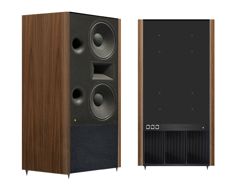

BTW, I photoshopped my active speaker side board plan last night. I will do 1-1/2 radius MDF side board. 3 Aleph J in the stand.
I think this the easiest to realize, and the most economical solution.
