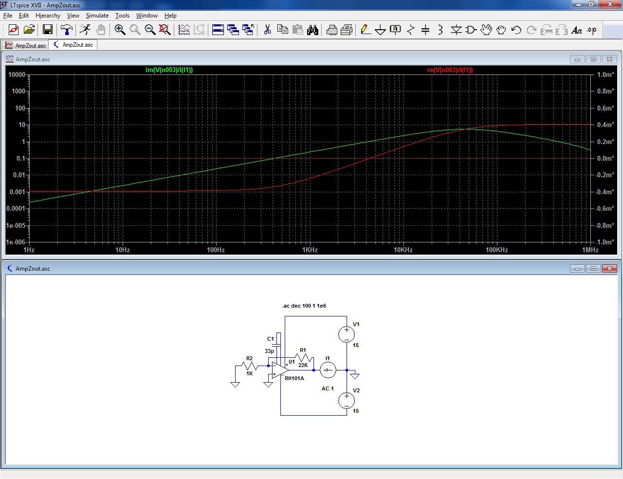

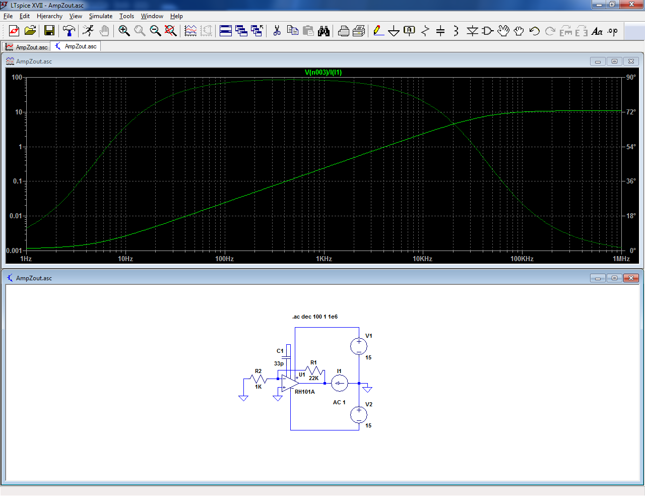

I am afraid it is not the case: as I said, all amplifier subjected to GNFB have a significantly reactive output impedance (and others might also have one, for other reasons).The vector might only change the value by a few percent any way........
Here is a simple example, based on an LM101 opamp for ease and simplicity, but the behavior is common to all amplifiers, discrete or integrated.
This sim shows the |output impedance| vs frequency.
You can notice that the output impedance rises at the rate of 6dB/octave between a few Hz and and few tens of kHz, which is already a strong hint.
Another hint is the phase: it remains in the vicinity of +90° for that range.
Thus, it looks like an inductor, it smells like an inductor, but is it dominant?
We can plot together the real (red) and imaginary (green) parts of the impedance:
We see that the reactive part is indeed heavily dominant for all of this frequency range.
So, the phenomenon is not anecdotal at all.

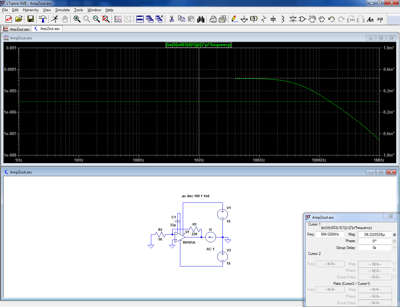

We can convert this imaginary part into an inductance:
It is 38.5µ for most of the frequency range.
Some people might think that this synthetic inductor is completely virtual and has no effect in the real world.
Not so: any amplifier that shows some measure of ringing during a squarewave test on a pure capacitive load (without Zobel) demonstrates that the effect is real.
You can compute the equivalent inductance of this amplifier based on the ringing frequency and capacitor value.
