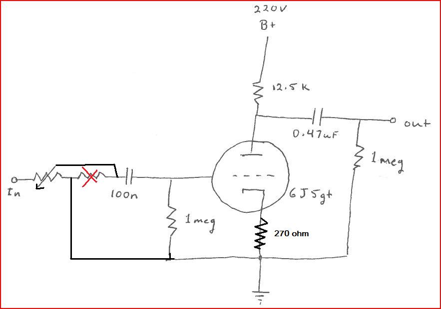

Without a schematic, it's nearly impossible to give advice for your specific circuit. I'm guessing the better options will be to use a tube with a lower mu or use an un-bypassed cathode resistor. But without a schematic, we're shooting in the dark here...
Messing with the volume pot will have little to no effect.
~Tom
Wrong way :eek:
Try it like this :)
Mona

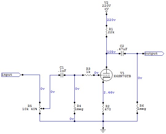

Ketje has it right on the volume pot being wrong. I notice you are basically trying to use it at the generic operating point from the datasheets, plate voltage 90V, grid 0V, 10mA plate current. What they don't mention is that this is with a B+ voltage in excess of 300V, so the load resistor can be a sizable value. If you want to add distortion for that "tube" sound, this setup is fine.

Thank you all... and thank you for the corrections.
Jerluwoo...are you saying that the schematic you drew will add distortion?
I am trying to avoid having feedback from the cathode resistor...and avoid the need for a bypass Capacitor.
Also...will a higher B+ and load resistor allow for less distortion?

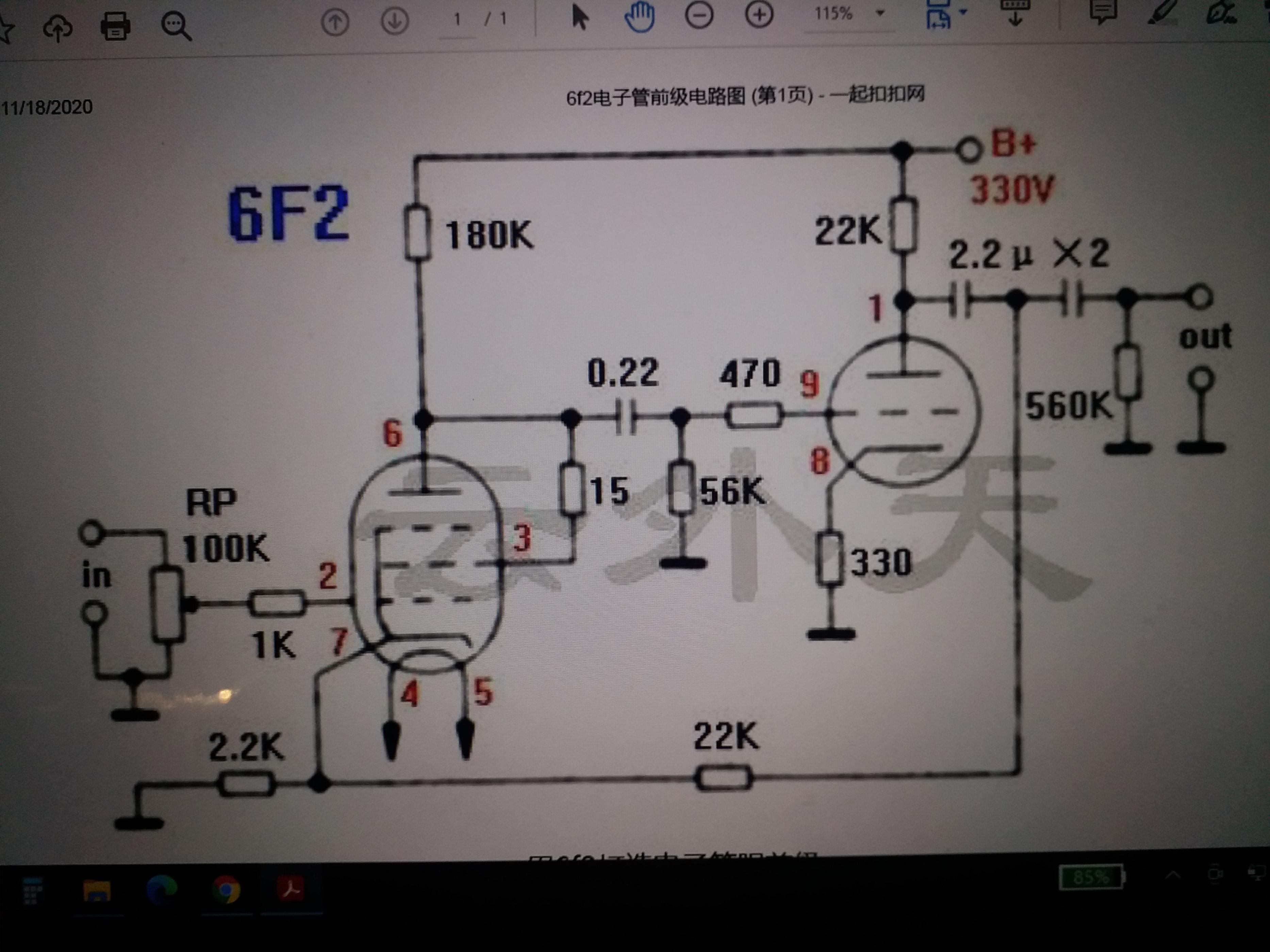

Hi I would request adv also
Hi I also wish to reduce the gain of my DIY preamp. I attached schematic & will appreciate any instruction. I m not very knowledgeable in audio electronics so easy instruction would be appreciated.
one quick way, reduce the 22k feedback resistor to say 10k...
another way is to replace that 22k to a series combination of 2.2k and 20k pot so you can adjust the gain to suit your taste..
