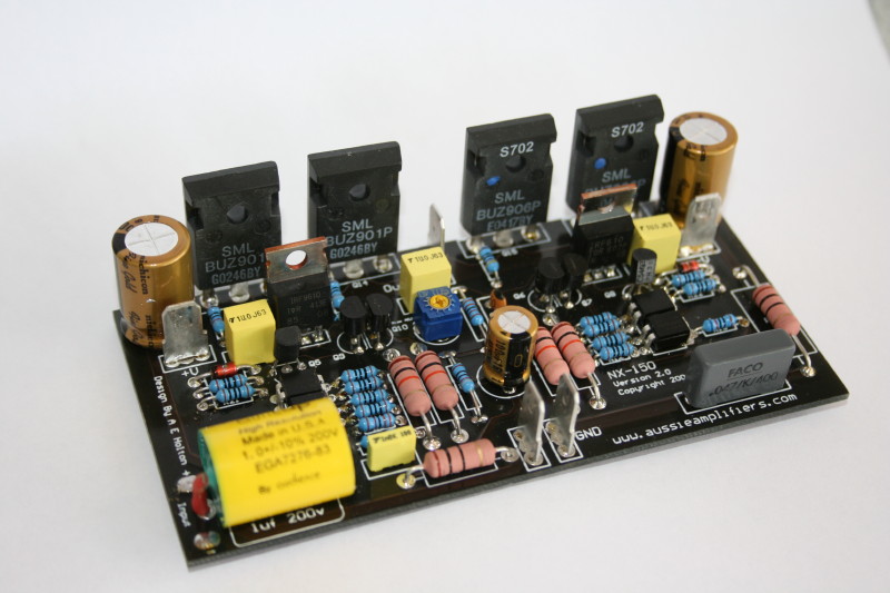

I build my amp too, you can look at
http://www.diyaudio.com/forums/showthread.php?s=&threadid=101948
You can calculate how much i spend the money
http://www.aussieamplifiers.com/index3.htm
Not include heatsink, casing, transformer, wiring and
connector. At the first time i just want buy creek amp
5350 but why dont we move the budget to nx150 :D

Hi Gaetan,
Getting the schematic right, and the PCB layout right makes more difference than expensive components.
There are some constructor type project threads that might be good for you to go through. The SymAsym thread is especially good as it shows the difference the board can make with the same schematic and parts.
If you wish to find out a great deal, build one of these amplifiers. Start out with a small one - like the SymAsym (about 50 wpc). As an amplifier becomes more powerful, changes need to be made which may compromise sound quality. In other words, it's harder to make a high power amp sound good than it is to make a lower powered amp sound good.
At any rate, once you build one you can play with component types and hear for yourself. There are group buys of circuit boards (not populated) from time to time. Get in on one of these to make your life easier. I believe there is a group buy currently on the AAK version of the SymAsym 5.3, look here: http://www.diyaudio.com/forums/showthread.php?s=&threadid=97640
I'm buying a pair and I've already built an original 5.3 pair. Lot's of support on this model. Also, there are amplifiers by Quasi and others. Look also in Chip Amps and Class D amps. If tubes are your thing, then have a peek in the tube forum. Things there tend to be much more hands on. Have a look and read the high voltage warnings! I like tube amps also, but this may be more advanced building.

Hi, the output power is ~60w into 8ohm and ~100w into 4ohm.
simaudio? I don't know that one...
Explain "expensive" components. The suggested transistors have standard prices, there aren't more expensive better types.
I doubt that using high end resistors (instead of normal metal film) make a real audible difference except they cost ten times. But, i haven't tried. It should not sound worse.
For the smaller caps Mica is already suggested. For the elyts simply don't use cheapest stuff, if you use high end elyts, you could skip the bypass 100nf caps, except c19/20 maybe, you need to try.
For c19 the audible difference for using the c20 with cheap elyt is amazing.
It does make sense to not use cheap transformer for the PSU.
