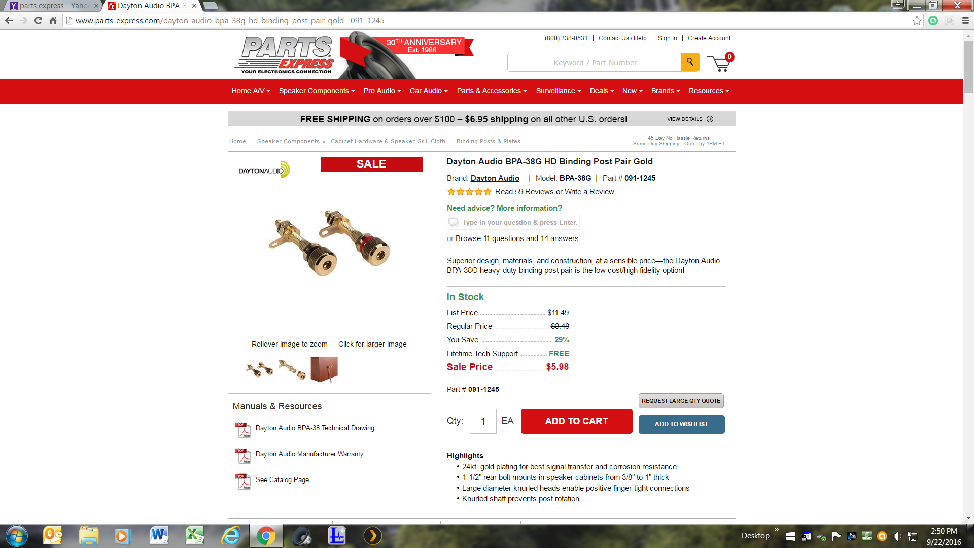

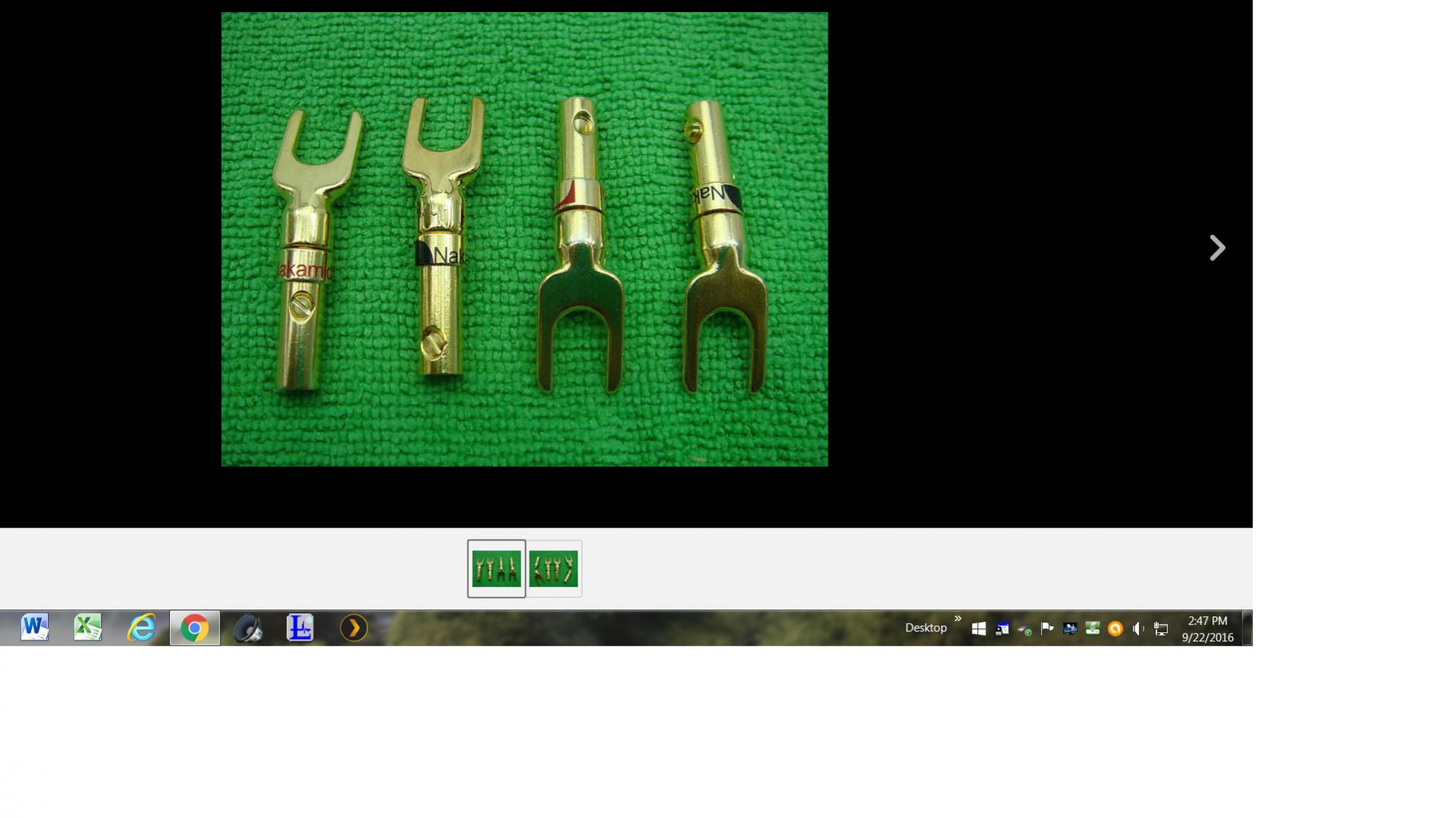

I'm very much a newbie in regards to cabinet construction, but in my limited experience its hard to beat a well designed stand alone posts for ease of assembly. This is the combo that I have landed on (see attached photos). These binding posts are well made and seem like a good price. The Nakamichi spade terminals are also well made and work awesome with these binding posts. Dave and Chris really know their stuff and I'm not trying to discredit their input, just giving another option to consider.
Best Regards,
Rich
