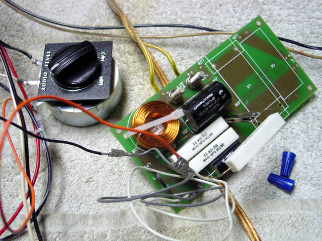

It's the EconoWave PC board. PM for details.

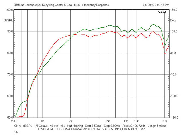

GM, this isn't smoothed except for what smoothing effect gating has on things.
A graph like this would be much more helpful as it's easy to read and compare. I know you've been in this game a long time, but with all do respect check out my signature for info on irrelevant squiggles. There's something to it.
Not a fan of applying too much smoothing to a graph. 1/12 octave is plenty IMO. Well, actually too much.

Here's a look at another sample of the model driver/WG with the on axis included and only out to 45 degrees.
5mS gate in line 6uF cap 1/12 smoothed:

If you have the time, build the econo crossover. The Dayton thing was just to get you up and running if a better crossover did not show up immediately. But since it did, you might as well build it.
It can all be done with screw terminals, if you want.

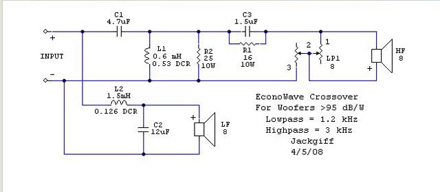

Question for Zilch. What is R2 for in the HPF? All I can see is that it drops the level 2-3dB, but the L-Pad is there for that too. What is it doing that I don't see?

I used to think it was simple and that I understood it, but wasn't until I got it into PCD sim with the actual driver measurements that I could manipulate it reliably. The L-pad leaves the contour largely intact when adjusting the level.Question for Zilch. What is R2 for in the HPF? All I can see is that it drops the level 2-3dB, but the L-Pad is there for that too. What is it doing that I don't see?

By PCD do you mean Jeff Bagby's Passive Crossover Designer? If so that's what I used to double check myself. And I didn't see anything other than a ~2dB drop in overall level. That's why I was curious.
But I ran it again this morning with a better layout and now I see what R2 does. It prevents peaking at the low end of the driver's range. It's a damping resistor, of course!
Don't know why I didn't see that yesterday. Thanks.

As I progress, I'll post pics. I ordered the PCB for that XO that Zilch posted, and I'm trying to find the right parts order from the hundreds of thousands of pages of info he has graciously put out there on the highways of the interwebs.

The basic parts list is here:
http://home.comcast.net/~dnewma04/EconowaveBoM.htm
All come from Parts Express; values differ with variants.
Selenium D220Ti is the bolt-on version for use with the QSC waveguide....
