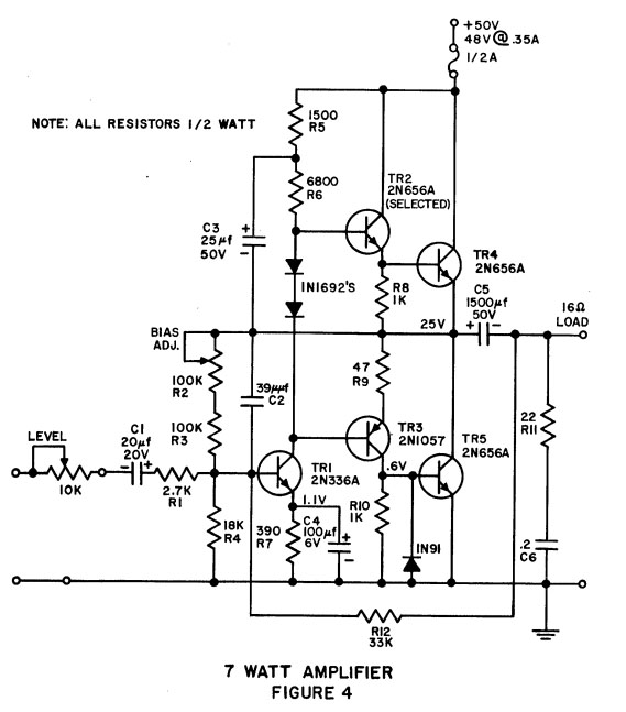

For documentary purposes, the attached pictures indicate what was the status in October 1960, from a AES paper by Jones from GEC.
It is about the 2N656A NPN 60 Volt silicon power transistor, good for several amperes. As you can see, the application is the RCA H.C. Lin inverting audio power amplifier arrangement from 1956, with a bootstrap in the VAS.
Actually, the title about "silicon transistors" is somewhat misleading because TR3 (PNP driver) is a germanium transistor 2N1057. Now you know why Jones prohibed the word "complementary" in his presentation ! The driver stage is completely turning back from complementarity, with TR2 being a silicon NPN power transistor (2N656A selected for minimum beta equal to 20 at 1mA collector current) and TR3 a germanium PNP medium power transistor (2N1057). Amazing !

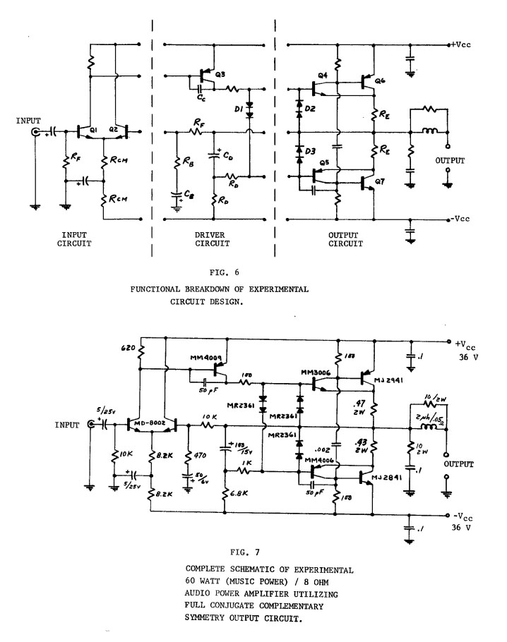

For documentary purposes, the attached pictures indicate what was the status in October 1967, from a AES paper by Haas from Motorola.
In his text, Haas is referring to the 1956 Lin arrangement, calling it a "basic quasi-complementary symmetry power amplifier".
The new circuit Haas is presenting is the ancestor of all modern "blameless" amplifiers, still in use today. Haas describes his amplifier in 1968 as an "experimental 60 watt 8 ohm audio power amplifier utilizing full conjugate complementary symmetry output circuit".
Please note it is using a symmetric power supply with a +36V rail and a -36V rail.
Please note the atypic terminology Haas is using, calling the VAS stage the "driver circuit".
The power section is not a Darlington, but a CFP arrangement. The power output devices are MJ2841 (NPN) and MJ2941 (PNP).
They are fed by MJ3006 (NPN) and MJ4006 (PNP).
The VAS is a MM4009 (PNP).
The long-tailed pair at the input is MD8002 (NPN pair).
One may ask why Haas did not used a constant current sink in the long tailed pair, and a constant current sink as VAS collector load. Conceptually, this is a cleaner approach than the simple resistor in the long tailed pair, and the bootstrap as load in the VAS. Maybe all this was available and done at Motorola, but kept secret for keeping an advantage over the competition.
As soon as 1969, Clive Sinclair, with the Project Sixty Z30 and Z50 power amplifiers, was introducing the constant current sink in the VAS, as collector load. But the output devices of the Sinclair Z30 and Z50 were quasi-complementary (ME6101 + BD155 for positive drive, and ME0402 + BD155 for negative drive). And there was still a simple resistor, in the long tail pair emitters. And the power supply was asymetric, using a +35V stabilized power supply (the PZ5). The ballast transistor of the PZ5 stabilized power supply was a 2N3055.

Well researched, Steph. The bootstrap was used because it allowed voltage drive ABOVE (in this case, below) the power supply voltage. It was then considered better than just a constant current load, and cheaper too. I thought differently in 1968, but that was the debate between my colleagues and me. Now, only on this website, do you see common examples of bootstrapping
I used this output stage configuration in the '67 paper, at Ampex Research in 1969 for a very large motor drive amplifier. I found it difficult to use, due to a tendency to instability. In future designs, especially with Richard Heyser's insistence that the complementary Darlington configuration was actually better, I switched to the Darlington in future designs. Never looked back.
