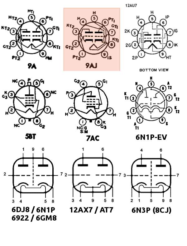

What valves are pin compatible with ECC88 / 6DJ8?
Showing my ignorance here but pin compatable means they can be used in place of without any circuit alteration?:confused:
He seems to be willing to tolerate heater voltage variations (although I doubt there are any...)
"I'm not worried about functional compatibility, or different heater current requirements, I'm just looking for the same pin-configuration."
This presumably means he wants to hardwire the signal-circuit, but he may have a heater-supply with a switch,
that allows for 12.6 volt / 6.3 volt operation without rewiring the sockets.
He has effectively created his own definition of "same pin-configuration",
since he is allowing some (unspecified) differences.
I doubt there is such a pair of tubes that would allow such a wiring arrangement.
The other thing he may be missing is this:
In a low-signal preamp circuit, there is a special shield between triode sections in some tubes,
whereas in the other tubes this is just a 'ground',
or used as an extra connection to the heaters for 6.3/12.6 volt operation.
However, in low-signal applications, 12.6 volt operation is not desirable,
because these low-noise tubes have heater windings designed to cancel hum via parallel operation, and must be operated as 6.3 volts (parallel heater sections) to get the low-hum/noise benefits with A.C. heater supplies.
So its a mistake to think that you can just swap tubes,
even when the pinout for the two triode portions themselves are the same.

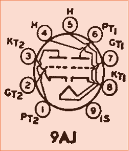

For example, here is the pinout for 6DJ8 / 6922 / 6N1P (Russian) / 6GM8:
Notice the shield connection on pin 9 at top.This is unconnected in a true 9AJ style pinout,
but is the center-connection of the heater in a plain 9A style.
For contrast, look at the 12AX7 / 12AU7 / 12AT7 style pinout below:
Interestingly, an identical electrical function style would be rather the 6N3P (8CJ style):
I
t also has an inter-triode shield, but a different pinout numbering.
A switch that altered the pin connections in the socket by swapping,
would allow a circuit to use either a 6N1P or a 6N3P.
