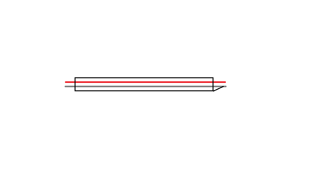

ahh, also called 'pseudo balanced'
I would suggest to try all shields connected to preamp
yeah, if all wires have own shield, split the cable, as suggested
and you can disregard the foil
just cut it so it doesn't short anything
Ex-Moderator R.I.P.
Joined 2005
ideally I think it should be two signal wires, with one common shield
which basicly is a 'stereo' wire
or maybe more correct, a 'balanced' wire
