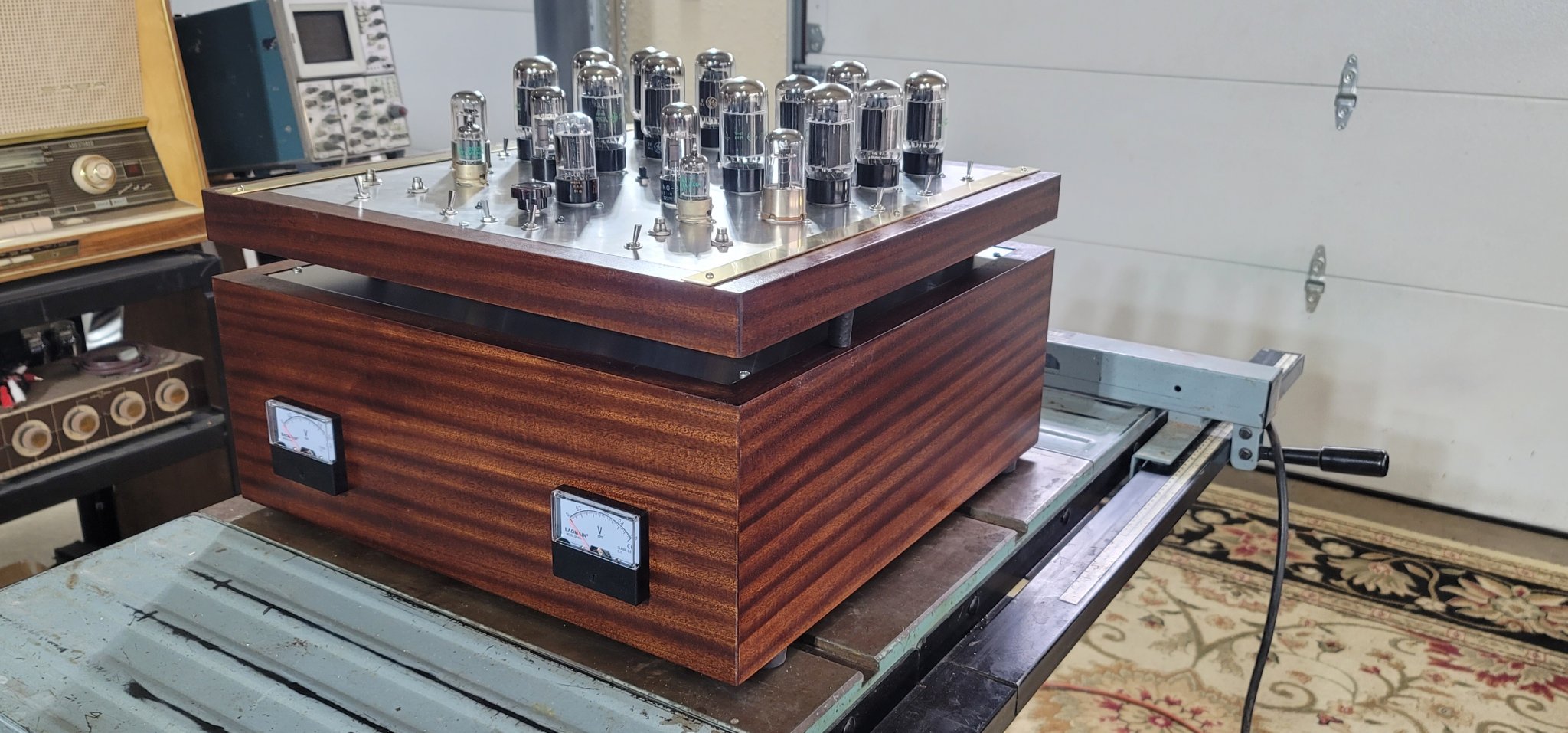

I just built a Rosenblit version, only slightly modified, with most changes done to the bias supply and using a 6J5GT rather than the 2nd 6SN7GTB (yes I know why he chose the 6SN7 B version) and then changed the 12AX7 to a 12AU7 using both triodes (RCA Clear top). It only uses 4 6AS7GAs per channel.
Having learned a lot about the circuit, I decided to take it up a notch. So the 2nd one uses 6 6AS7GAs per channel (brings in that missing bass) but also incorporates a 260V regulated bias supply and individual bias adjustments per pair on both the + and - sides. . It is a heavy son-of-a-gun weighing in at over 60lbs.. I used individual transformers for the + and - rails running at 160V (+160 &-160) and individual filament transformers, per channel. It, however can run all of the versions of 6AS7, 6336 and 6528, if the room gets too cold - otherwise the 6AS7GAs are quite enough (this ability accounts for much of the weight).
The first unit needed to have a fan added because, even with the tubes on top the IR radiated down into the enclosed area housing the filters. The 2nd unit has a hinged top so access to the components is much easier and the vent negates the need for a fan. The filters are all under the 2nd heatshield. Yes it has an unusual look . I call it the Up-Side-Down space heater, since the aluminum chassis is actually upside down.
I guess that I will have to build the M-60 clone if I want to find out for myself.
P.S. prefer the RCA type of 6AS7GA to all others - watch out some RCAs are GEs which are not the same.

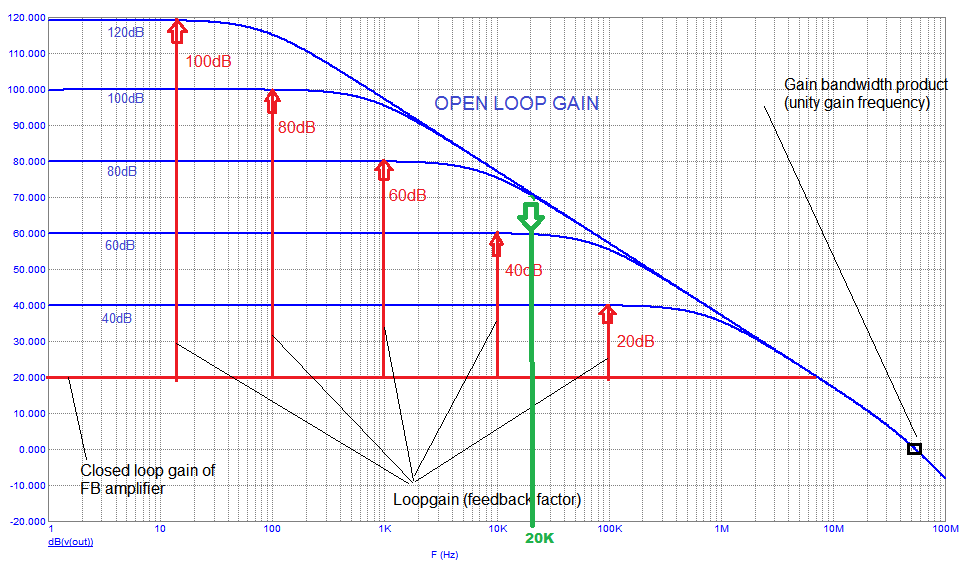

IMO it is not so important if the OPS-BW is in the 10s of Mhz range , that`s actually one advantage ,but what`s important is to limit input signal BW at input of triodes grids to 20Khz using simple RC low pass filter , so any signal at input grids above 20Khz have to be atenuated gradually, also what is important inside of the amp is to not have phase shifting elements , in case of your amps that only two RC elements pair , two 0,1uF coupling caps in conjunction with two 1M bias resistors ,
here`s one basic graph , where I prefer~60dB OLG vs 20dB CLG ( 1000:10 voltage amplification ratio) , since IMO that`s one good compromise for relative small OTL amp working as voltage source , but I still think that for overall amp stability higher loadspeaker impedance have to be used anyway , for S-30 anything between 16 and 32 Ohm is a good choice .

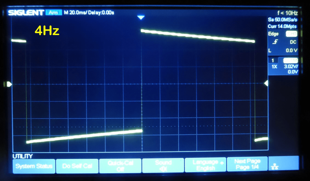

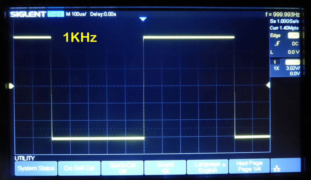

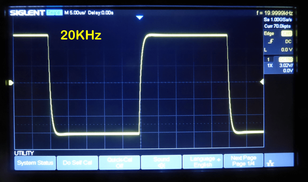

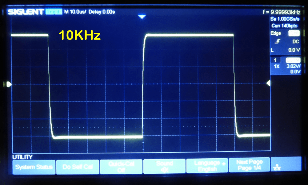

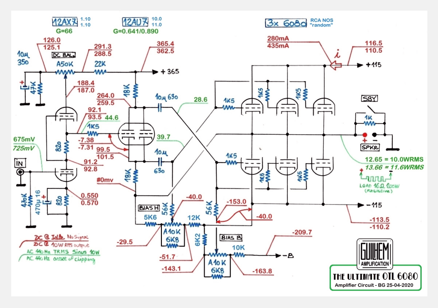

That's why my little U-OTL doesn't have a general NFB loop, but solely the Futterman "speaker output to cathodyne phase shifter" balancing loop :
At 10WRMS output @16R load - which is a modest power, but finally enough for me in everyday use - the results are excellent, given the compactness and the simplicity of the circuit :
2020-2024, four years later : no deviation of the performances, no instability, no maintenance, no setup correction needed... Still operational like in the first day.
I tested random power tubes (I mean : in good condition, but not matched) 6080, 6080WA, 6080WB with graphite plates, and 6AS7G, 6AS7GT, without significant alteration in performance of the amps.
Thanks again Mr Futterman ! :cool: :cool: :cool:
10W @ 16R from 3x 6AS7, that´s interesting.
Assuming that one 6S19P is roughly equivalent to 1/2 6AS7 (not true, but not too far off), that should mean 5W @ 8R from 6 x 6S19P.
5W would be enough for me and my speakers don't seem to mind a bit of output impedance.
I actually started a 6 x 6S19P/ch OTL project fifteen years or so ago but it was never finished and I still have the parts. Building a breadboard some day would be fun, most of my experience with OTLs comes from building an SE OTL that consumed almost 300W constantly to produce 2 x 750mW... :D
View attachment 1293729 View attachment 1293730
View attachment 1293734 View attachment 1293735
View attachment 1293731 View attachment 1293732

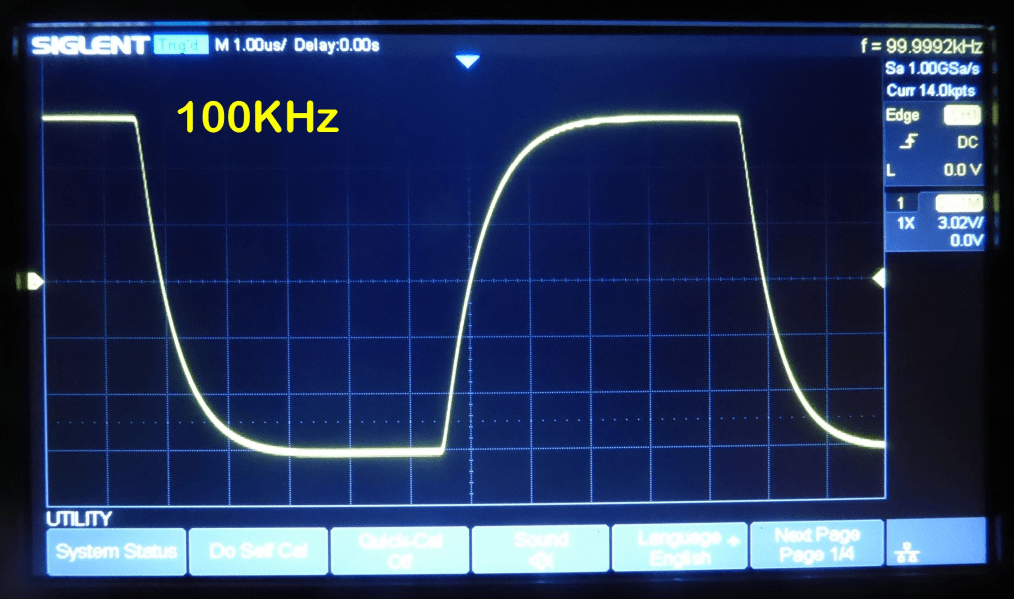

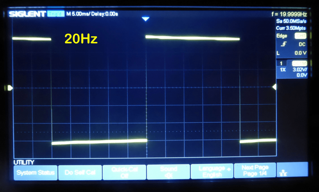

Very well-behaved waveforms.
Reactions: 1 user
An inverterad Futterman would be nice, but the fact that I have four 70V 1,5A EI transformers makes me think of a circlotron. I'm waiting for parts for another project right now (with those TubeTown guitar OPTs that we discussed in another thread a while ago), perhaps I could build a simple mono circlotron while I'm waiting just to see if 6* 6S19 operating at less than 100Vdc can drive my speakers at all.
Yes. One of this day, I'll re-experiment a Circlotron circuit more seriously. I made a quick attempt 20 years ago for a simple one (in the vein of my U-OTL) but it proved inconclusive, and most of all, showed some DC offset instability (due to possible imbalance of some sort) accross the speaker that doesn't occur at all in my U-OTL.
Thanks @egellings ! Yes, given the simplicity of the circuit and the quasi-abscence of NFB, this is a very fine result... Here lies the genius of Julius Futterman's original patent !
