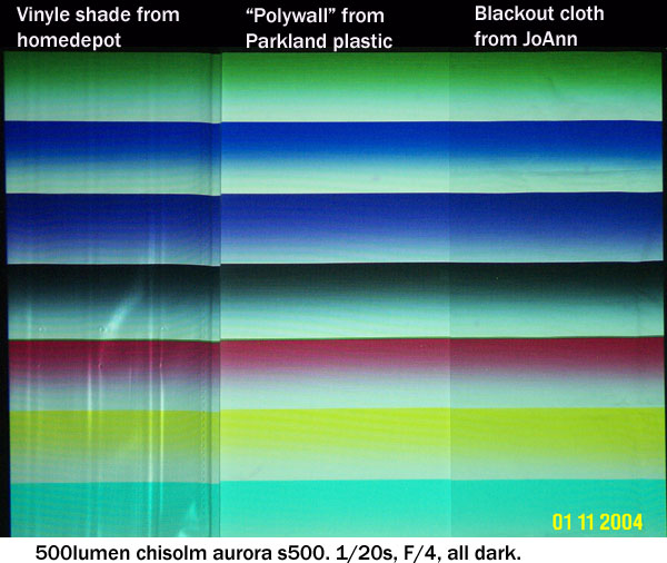

did a comparison between windows shade, parkland plastic, and blackout cloth.
window shades are easiest to setup. and it can roll up/retract when you don't need it.
parkland plastics are heay material and gives the bast result
blackout cloth is the cheapest to get and is a little bit darker than parkland plastics.

I am using Blackout cloth retrofitted onto roll-up blind.
Vinly blind: smooth and bright texture, hotspot issure, waves
Blackout cloth: heavier in weight, softer picture but less wave patterns, no hotspot problems
