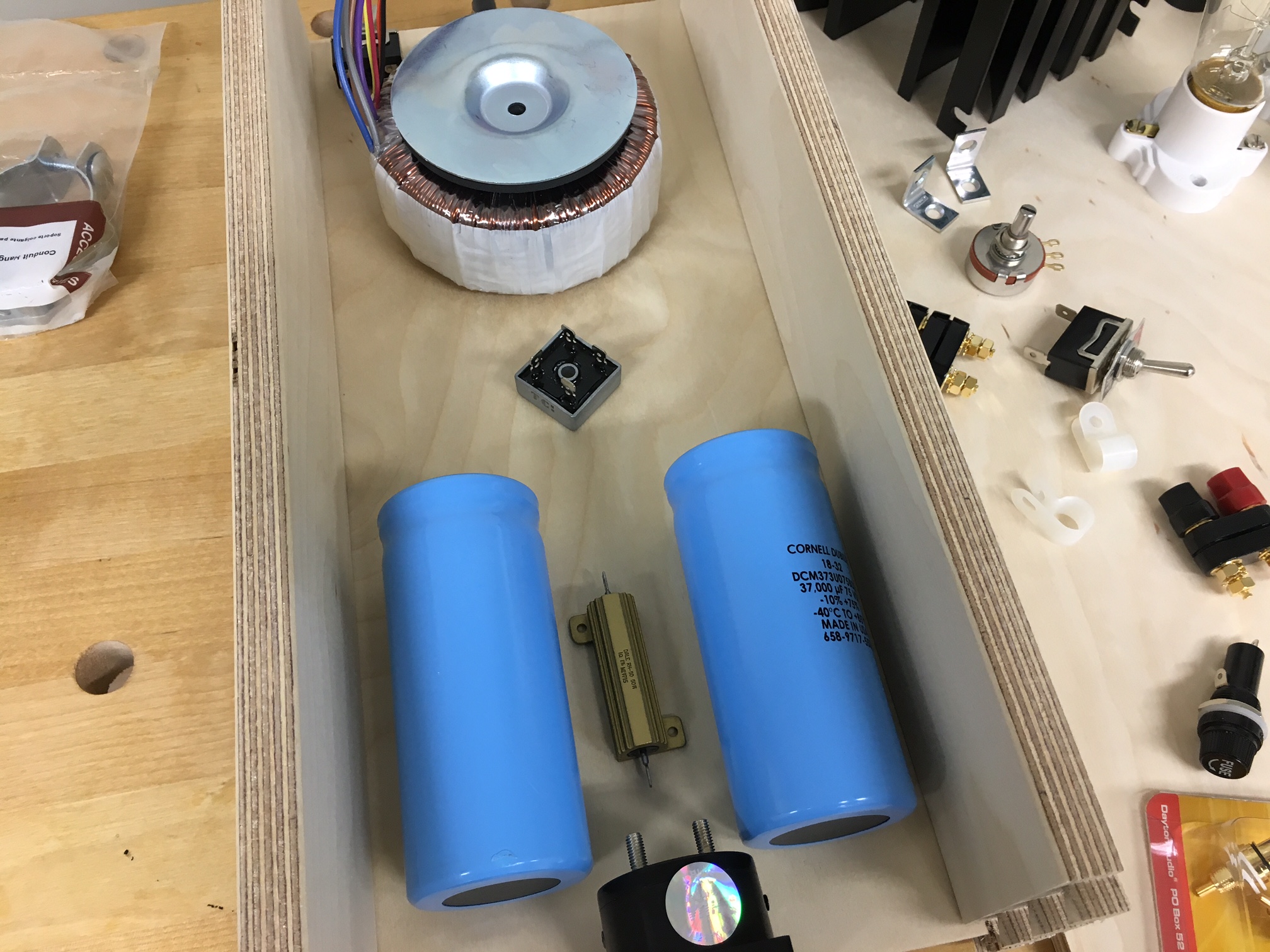

In addition to the design constraints listed above. I'm also going to constrain this to stuff that I have available in my parts stash, so I'll go take an inventory and see what I have on hand for transformers and such.
I only have a pair of 2SK79's. If I manage to blow them up, someone else will have to take over.

....corresponding to what I have on hand.

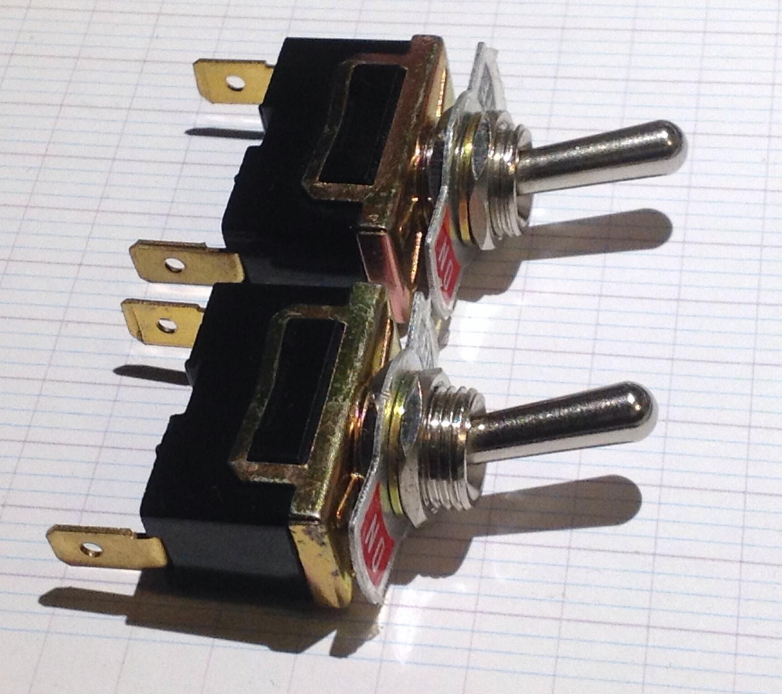

Funny i get the same power switch model.
Build like " tank" high quality strong electrical contact.
Start point, first components for 2SJ28 future monoblock's.

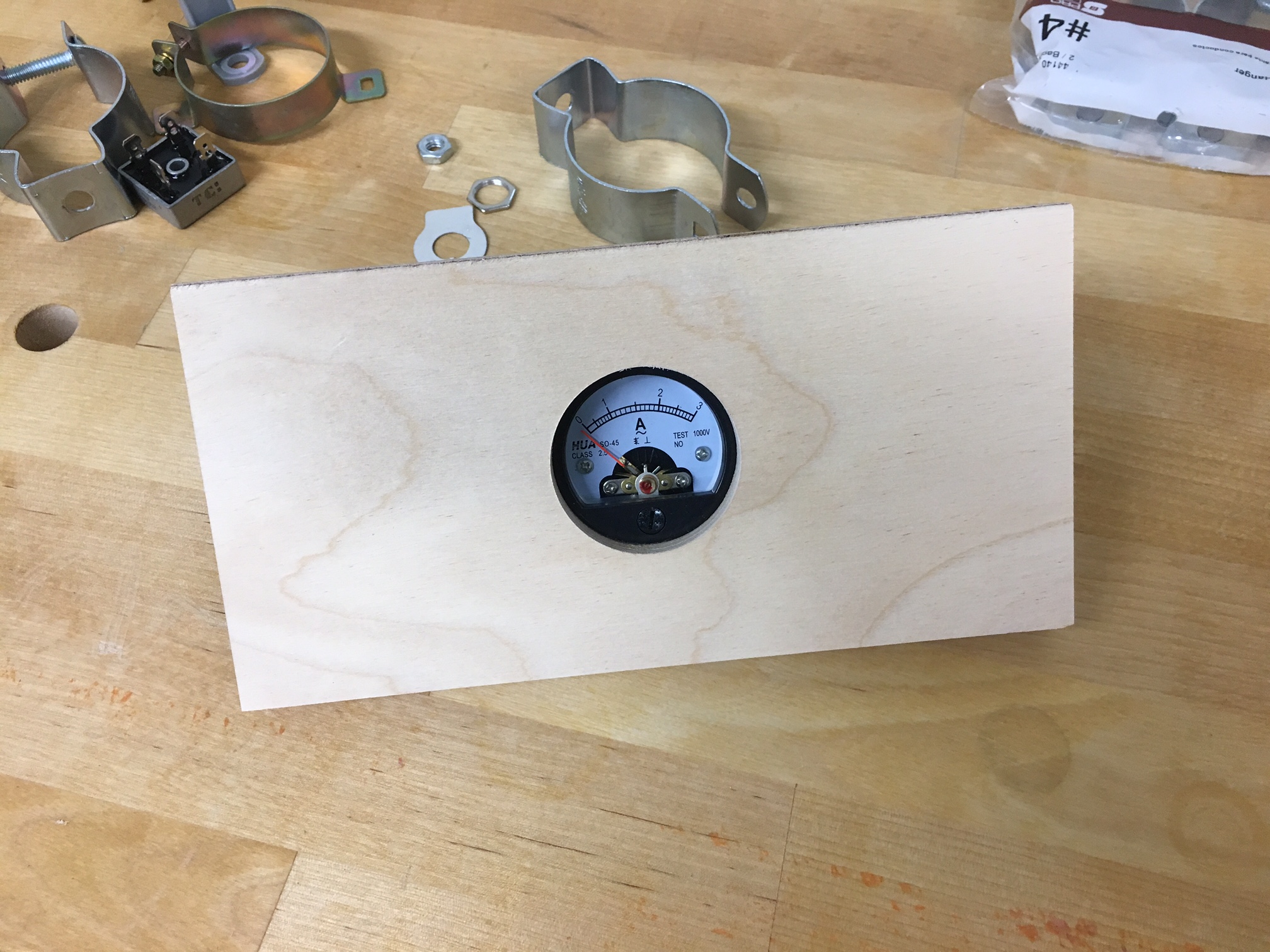

Cute !All the best amplifier designs start with the faceplate, right?
Right only if faceplate have the same speakers warnish colour haha
