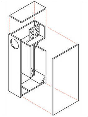

no regret with mine;) , FT1600

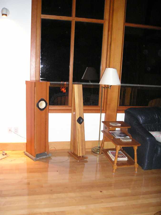

Hello:
I made a set of FT1600, I love them, I am now considering what else would be great with this driver. I am currently considering a bipole Tapered Quarter Wave Pipe. FrankDIY has made a nice version of Terry Cain's Abby with this driver it is on another thread.
I made a 1197 TQWP and fell in love with the design, presentation and sound. So I am think ing about upsizing and making a fe167 version. In my room this might be th eperfect speaker. Here is a picture of the 1197BTQWP and the ft1600.
Things are good they both sound great.

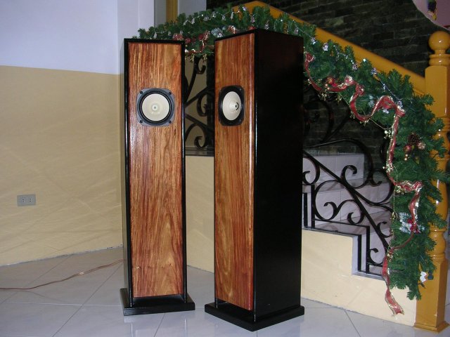

I have build the FT 1600 MKII with the Fostex FE 167 E
the speakers have to burn in for a long time
300_600 hours ..
The sound is improving every day
The bass is deep, dry en very clean..
they realy go down to 35 Hz
Hights well i find there is enough...
But the amp is very important ..
I used a HK 6550, a Nait Niam 2 ( souns wonderfull)
and at the present a Mission cyrus 2 ..
The Mission combines perfect with the FT 1600....
