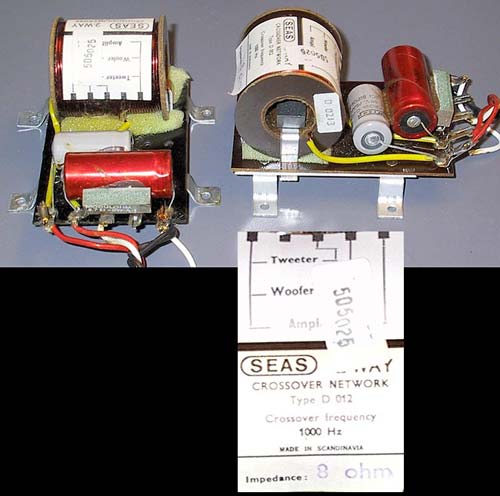

I really need schematic of Dynaco 35A's crossover.
That is what you call syncronycity... i just posted the A50 XO last night -- the A35 (and A25) XO is simply the tweeter part of the XO -- althou i strongly suspect that A25.A35 could be improved by adding the woofer low pass.
From My Dynaco Page

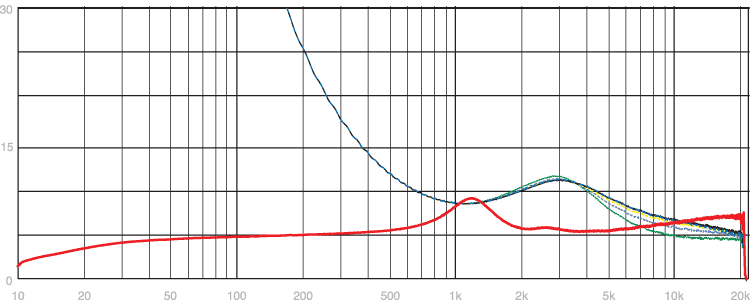

And i did a set of impedance measures for the effect of the tweeter levels (attached)
dave
BTW... the XO i traced this from will be amongst my eBay auctions late this week.

I always found the A25s top to be very soft. Taking the metal cover off the tweeter really helps. The boxes are no great shakes (one of the reason i put the plans up -- too encourage people to build better boxes). The boxes burn pretty good, and my packing bench is built out of 6 A25 carcasses.
If anyone is interested i have the measured parameters of a set of A25 woofers, and the impedance curve of a set of tweeters up.
Tweeters
Woofers
