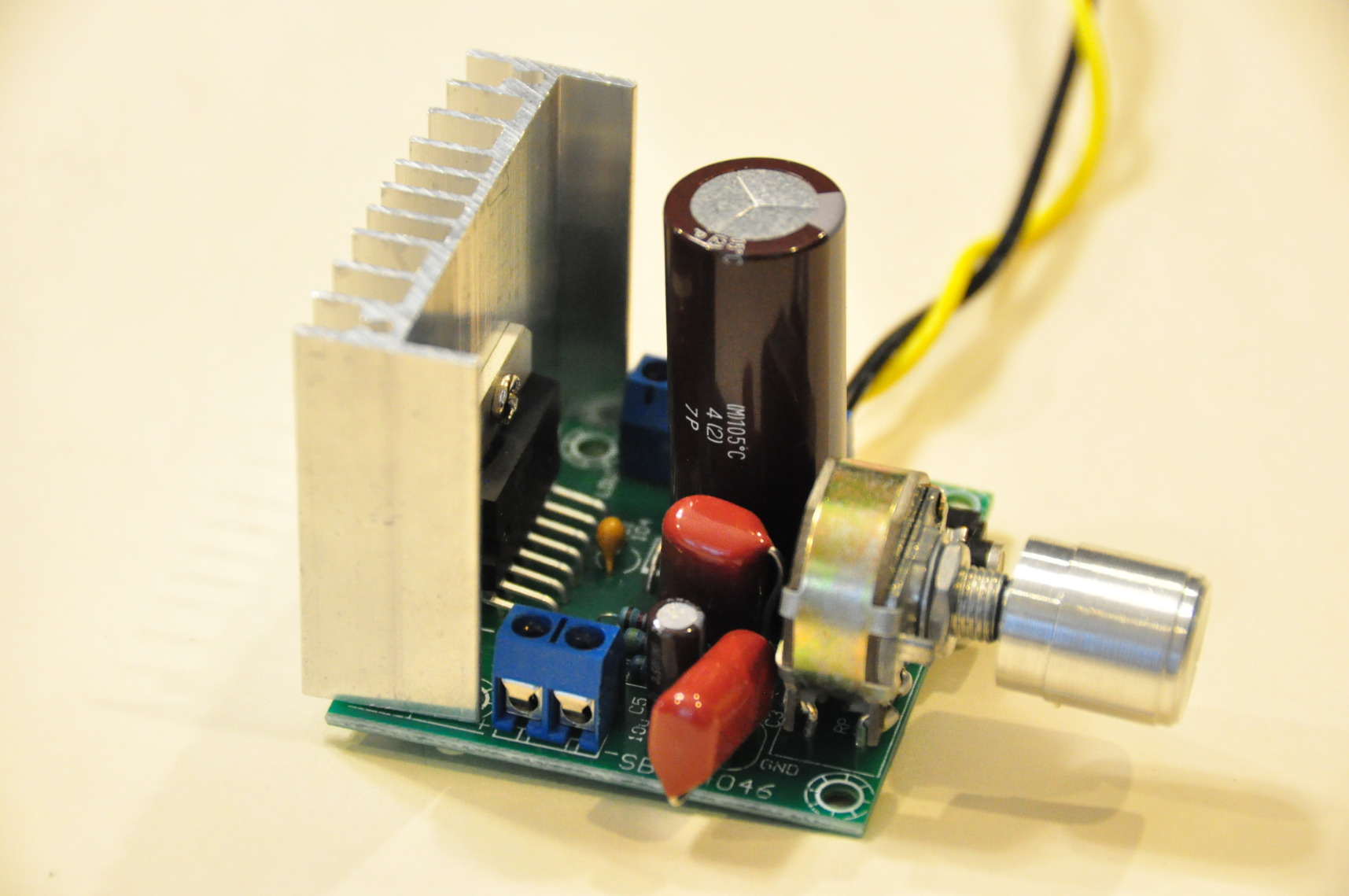

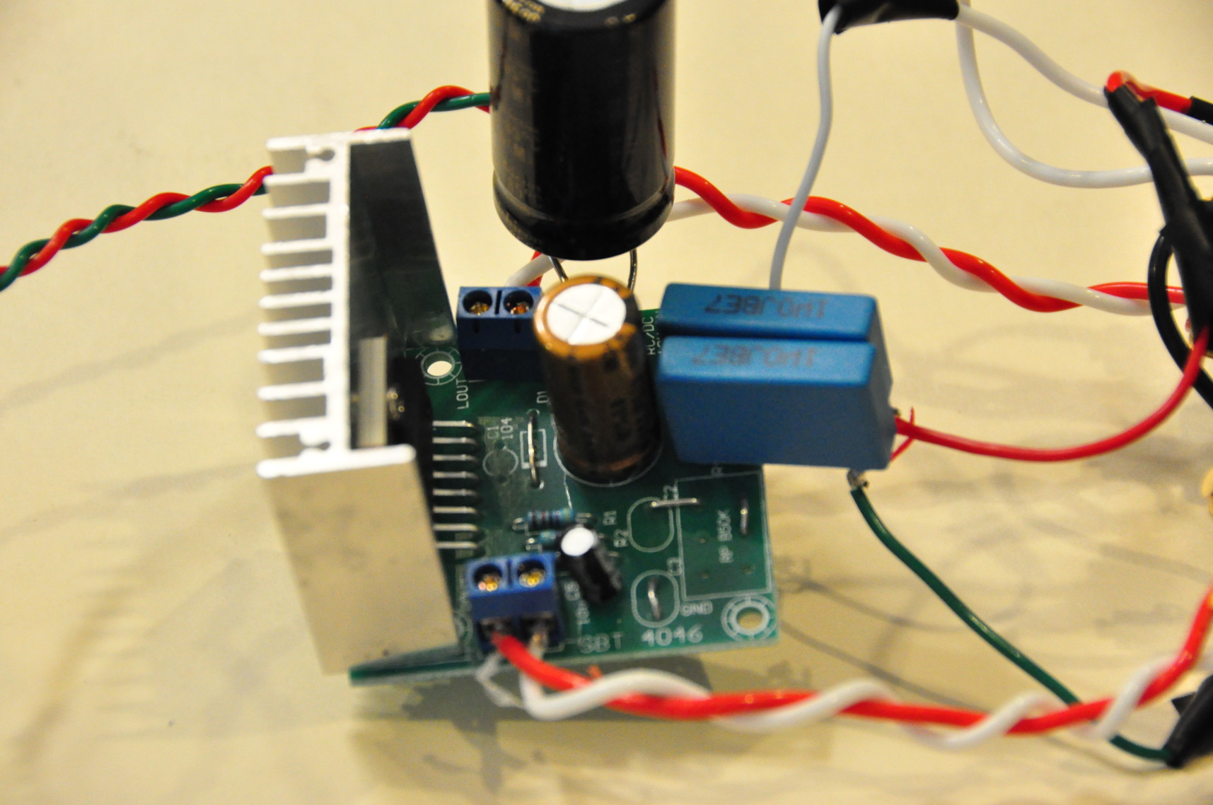

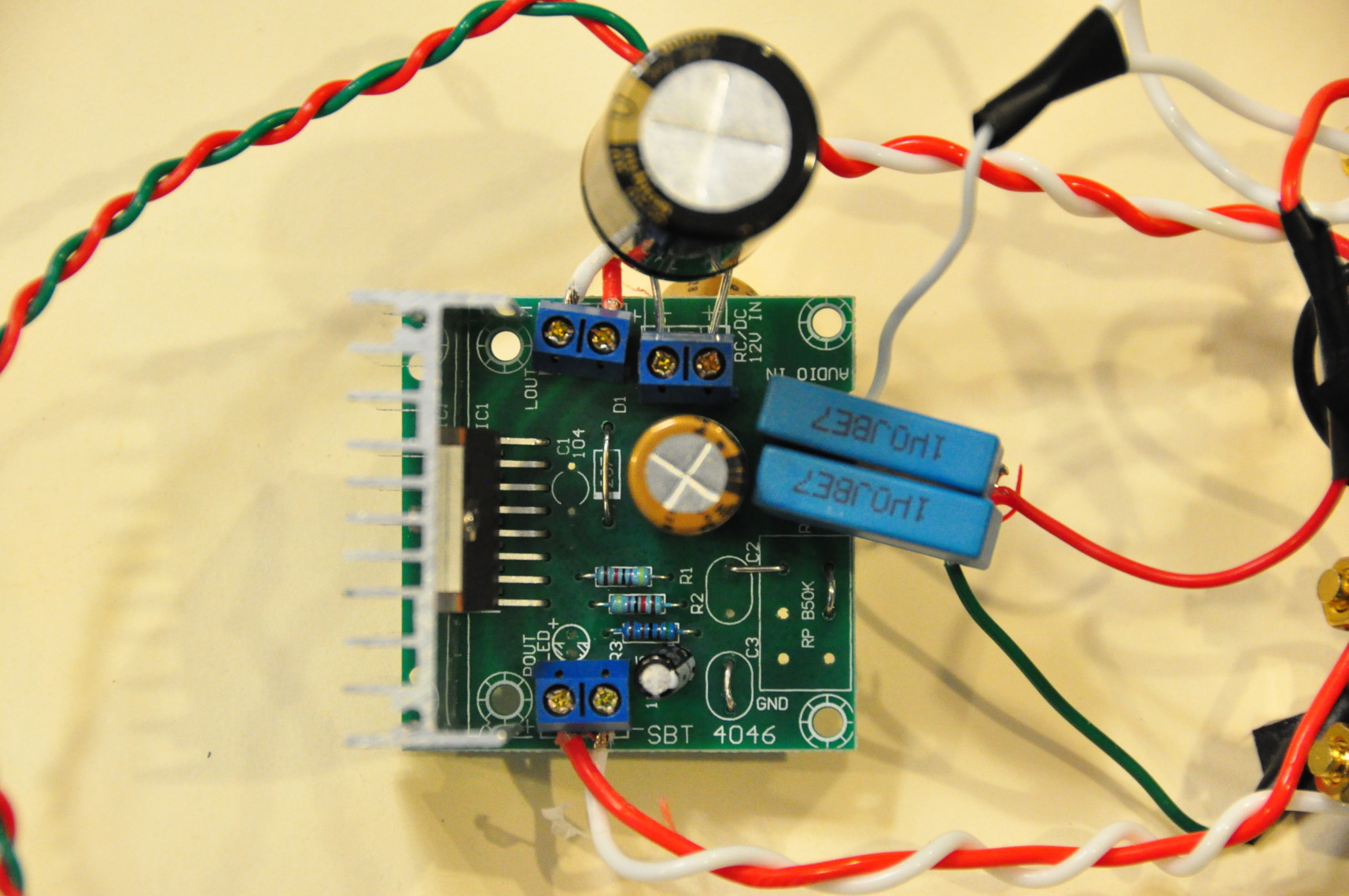

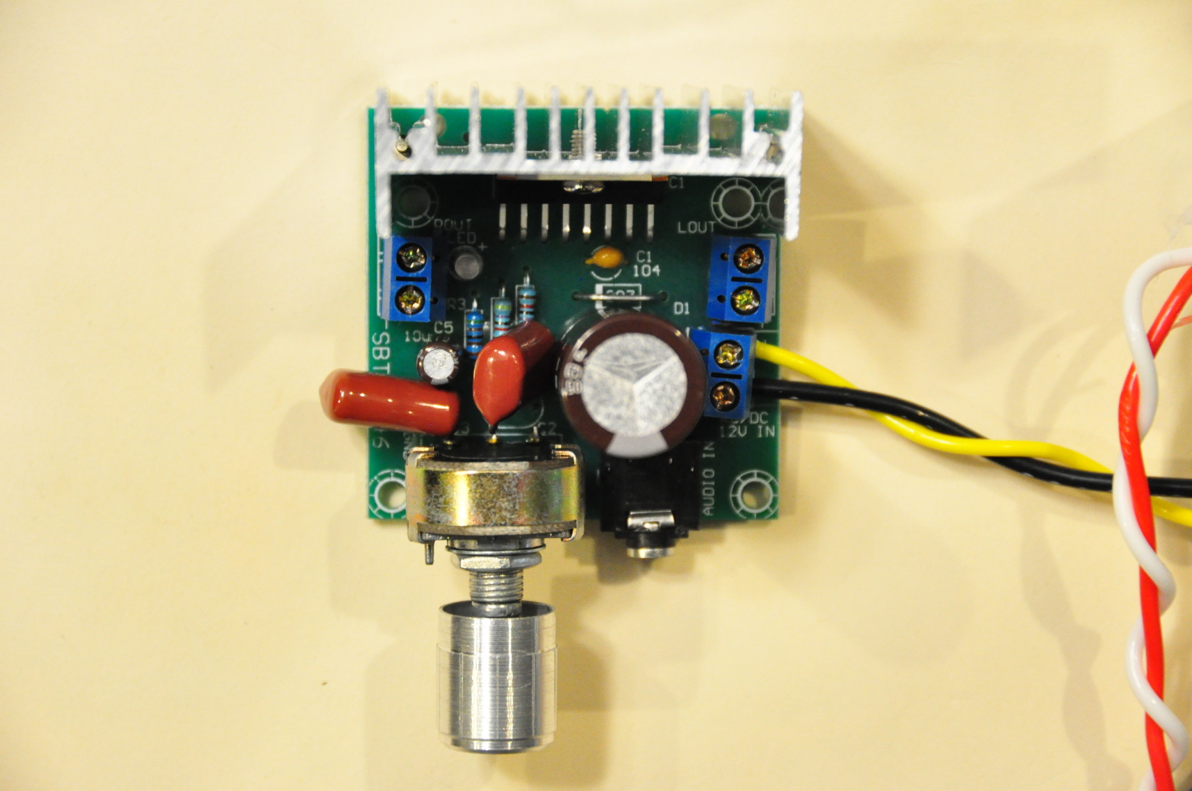

Pics attached, three pics each for build #3 and #4. First one has fancy DACT 50k stepped attenuator in place of no-name pot that came with the board. Diode replaced with a jumper wire, bigger power cap, polypropylene input caps. #4 follows your build guide v2 to the letter.
As was suggested above, the "shotgun" approach of doing all the mods in one go is probably unwise... but in all my other dabblings I've managed to pull this kind of work off without any issue. Not that I'm particularly experienced, but these tda7297 amps and the mods are really quite simple. <shrug>
Power supply is this: Parts Express Power Supply Regulated 3-12 VDC 2A 6-Way Part #120-536. Set to 12V. Obviously not the last word in power supplies, but it's what I have on hand. I have a nice Sigma11 PSU I built, but killed it with my first attempt at this tda7297 when I connected the polarity backwards. (Will get around to fixing it one of these days...)
The + and - are incorrectly labeled on the left side (away from DC power in). Pin 1 and 15 are +. You have one speaker out of phase.
I just noticed a big error on their part. Don't connect SG at the designated spot. Run it directly to pin 8 (if the board is upside down, on the bottom row, count in to the 4th pin). Both SG's need to be twisted around R and L until the separate at the capacitors. The reason is that PG's current is running directly though the connection for SG. This will greatly improve the quality of the amplifier. Please do these things and check back. I'll modify my guide to correct their problem. Apologies I didn't notice this before, as the datasheet has a similar PCB board layout that doesn't exhibit this problem.
I should have mentioned that I noticed that right away. Even with the distortion, the "hollow" sound of having a speaker out of phase is obvious!

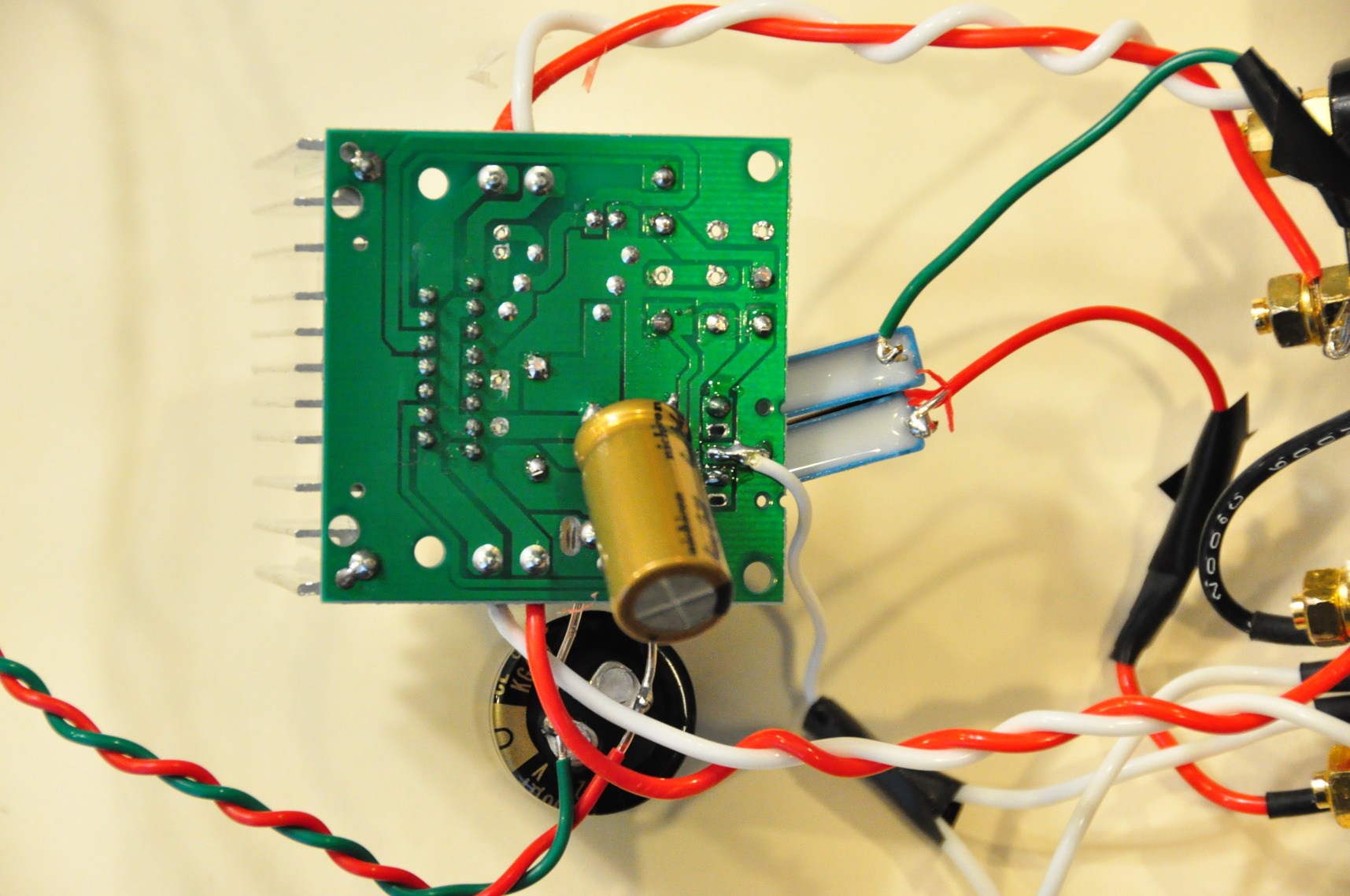

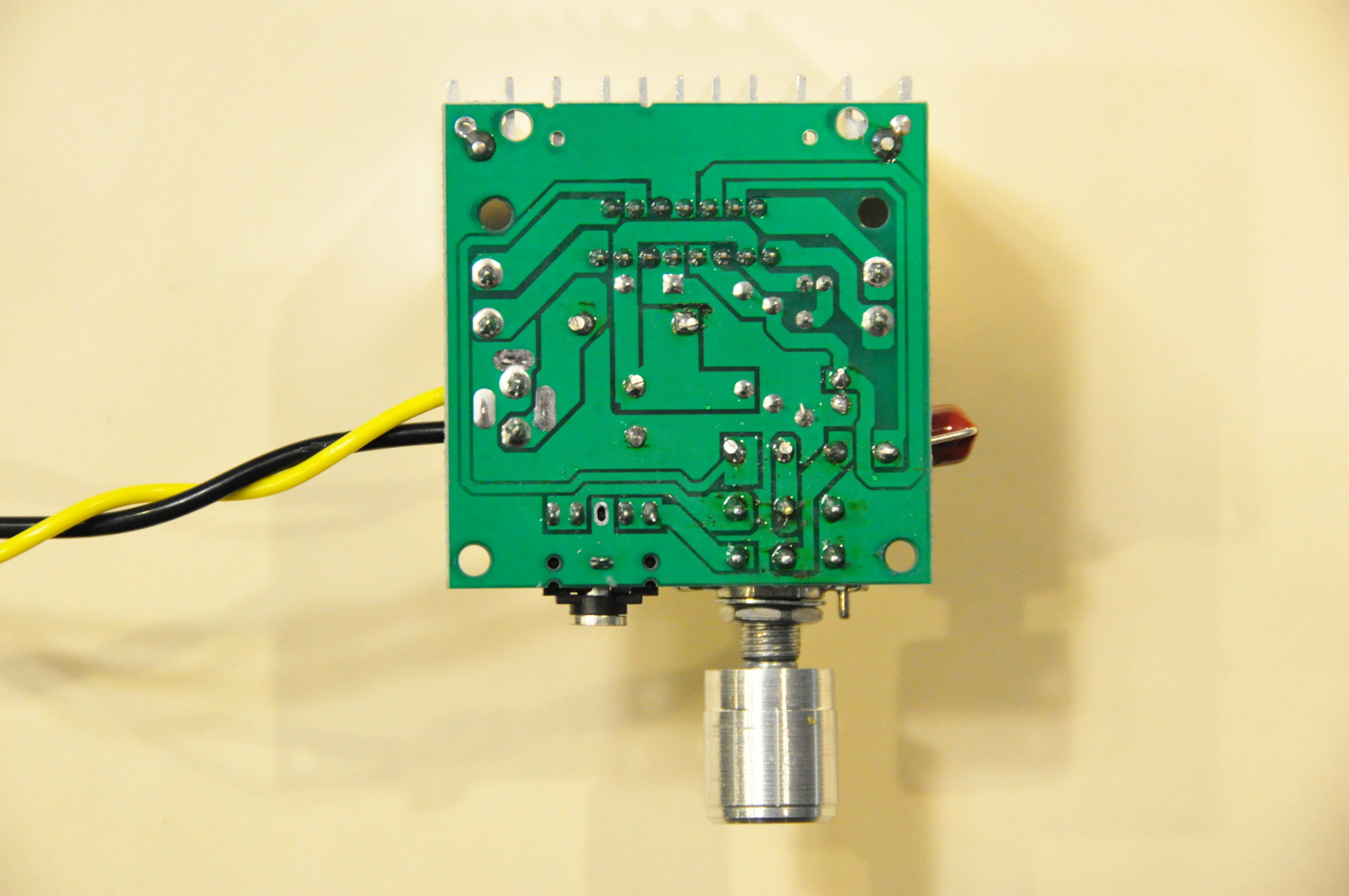

The SG needs to connect at the chip to avoid power currents. It's a flaw of that PCB. SG has to be connected to PG or the amp won't turn on, on these chips. It allows a lot of error, or poor sound for a TV.
Without bypassing to the chip SG pin, all power current flows right through between the mini Jack and pot vias (holes), and that's the path to SG pin as well.
