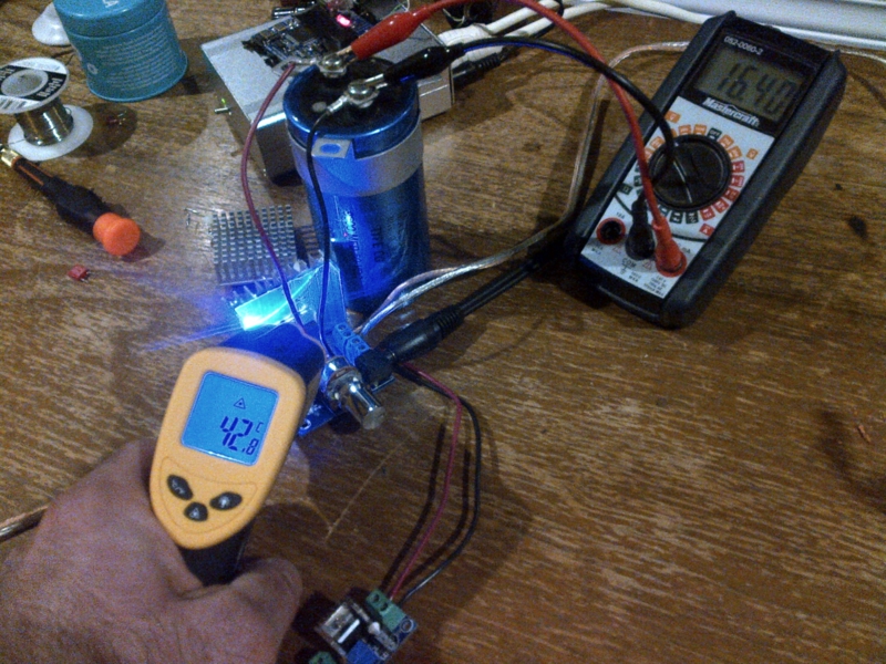

Note: so far I have taken some of the advice in this thread and done the following mods:
- removed the diode
- replaced the input caps with 1uF film
- replaced power tank cap with 9500uF (see pic )
- technically, the volume pot is not in play as it is running wide open (feeding it with a pre-amp)
Power supply is a 19v HP laptop SMPS being regulated down to a little over 16v by an LM317. At "very loud but not clipping" volume, the chip runs well within temp spec. Much of this can be seen in the photo.
- removed the diode

For giggles, I just removed the 9500uF tank cap and replaced it with a Mepco/Electra 100vdc 30,000uF beast. Yes, thirty thousand. The thing weighs 660 grams. It looks hilarious connected to the 7297 amp!
It sounds fantastic. The bass has some very impressive grunt. Overall, the sound is "richer" and smoother. I honestly cannot believe what I am hearing!
