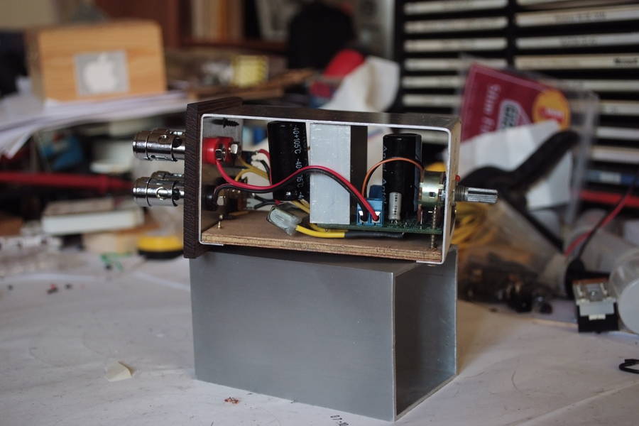

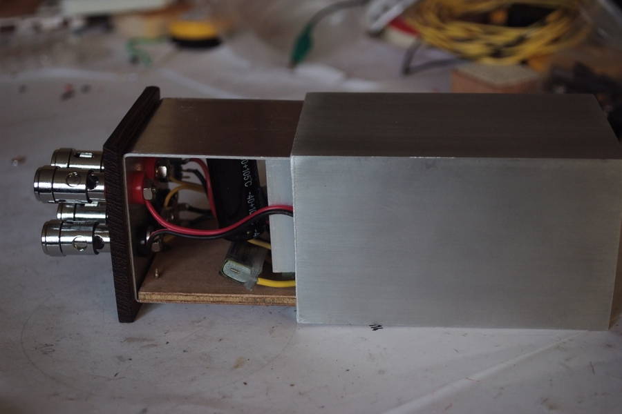

I'm quite pleased how my build (case) turned out.
Everything is done by hand, no CNC tools used. It was rather difficult to align everything properly, given my primitive tools, but I like how it turned out.
The case is square aluminium pipe, sanded by hand and sprayed with transparent acrylic spray (paint can)...
Still a few smaller details to correct, but that's about it...
The case gives it heft :)

By hand!
You are awesome!
(PS do you feel like sending a few across the globe?)

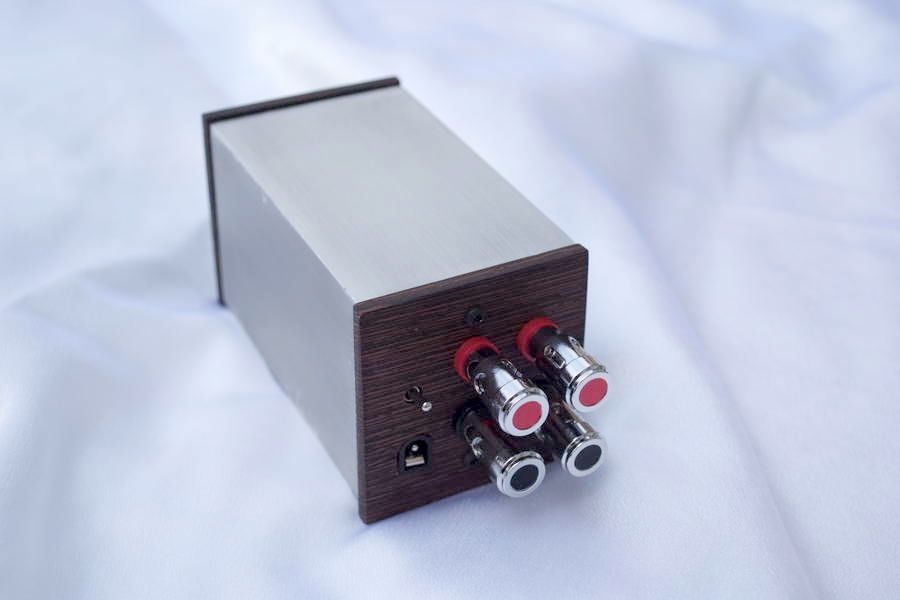

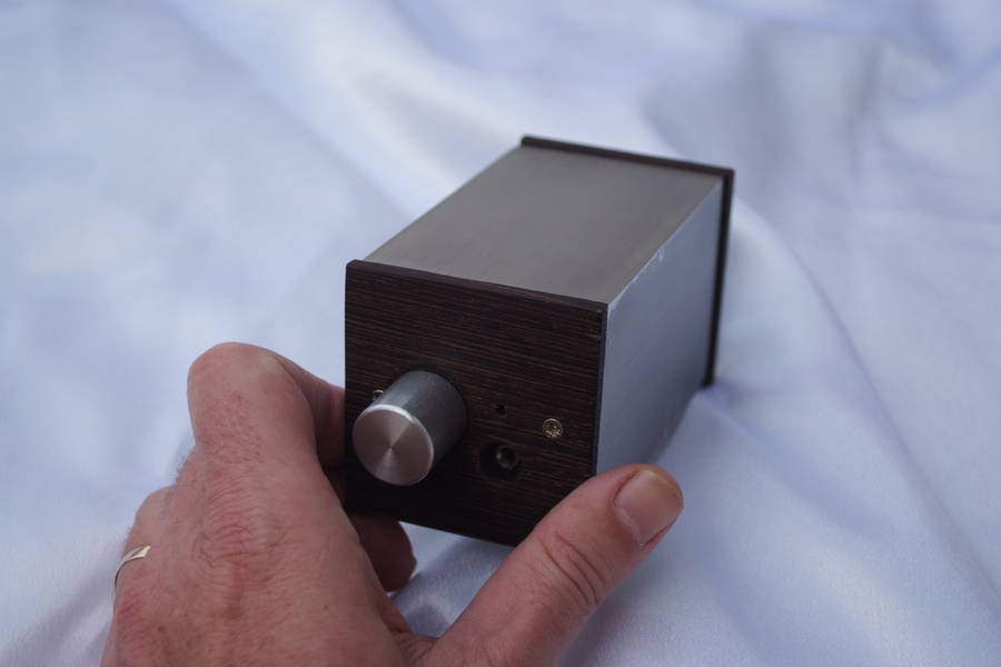

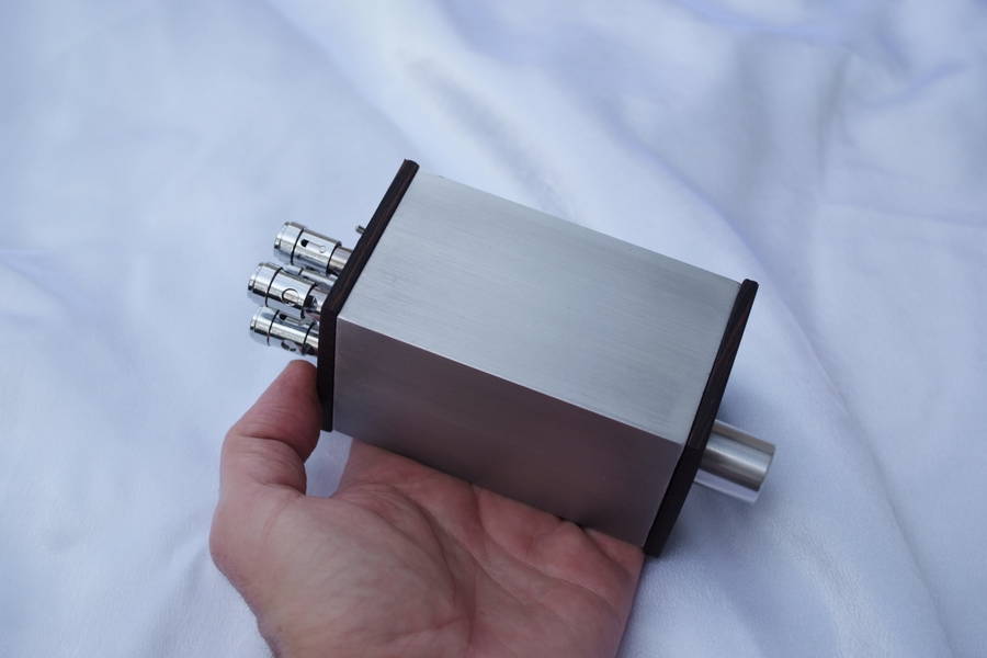

Sure :)
But I don't think it's economical: the shipping costs would exceed the value of the amp itself (it's relatively heavy). Besides, the insides don't really look that nice (see attached photos) :)

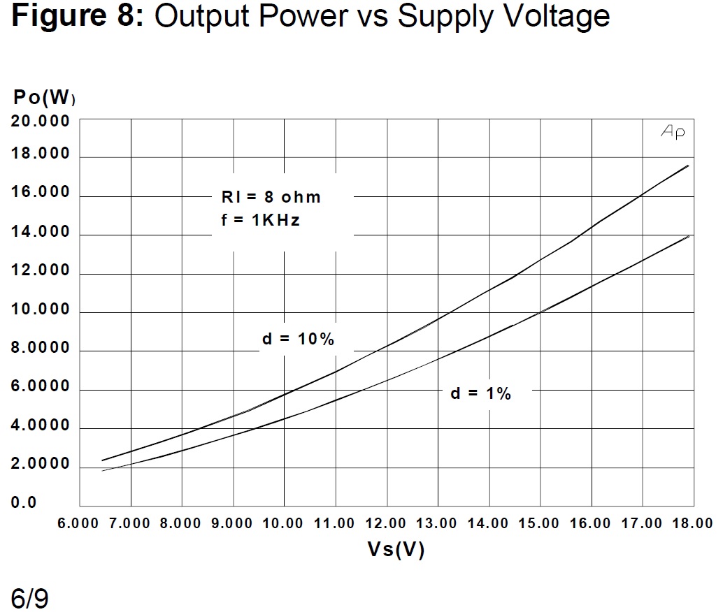

I tested mine on a scope with 14V DC power supply and 6,8 Ohms resistors as load. The full output just below clipping is 7.2Vrms @1kHz. That's approx. 7.5 W/channel.
I don't know what the efficiency of this amp is, but my heatsink gets pretty hot within a minute at full power.....

I don't go above 12V with this one. As long as the power doesn't go over 12V (laptop "brick" SMPS), there are no problems with heating. I tested it only with 8 Ohm speakers, though... Might be a problem with 4 Ohm ones, and if you're playing it full blast non-stop... I tried it for several hours on 3/4 power (pot turned 3/4 of the way up), and no heating issues...
12V reduces the max power indeed a bit (approx 5W/channel at 8 Ohms I guess), but even then you dissipate easily 1 or 2 watts in the heatsink at full power. Perhaps your aluminium construction helps a bit.
Mine has a slightly smaller heatsink, and I built it in a plastic enclosure with openings for airflow.
I use it to drive high efficiency PA/monitors (98 dB/1W/1m; 12" woofer+1" compression driver) at "living room volume" and I think the output power (7,5 W/channel in my case) is sufficient for that. I like this amp and its simplicity a lot :)

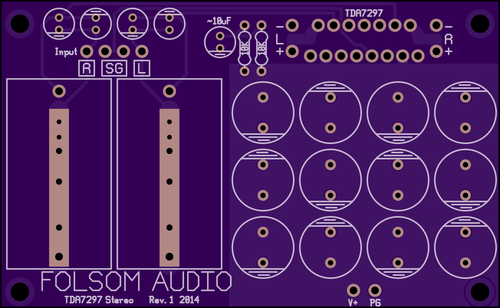

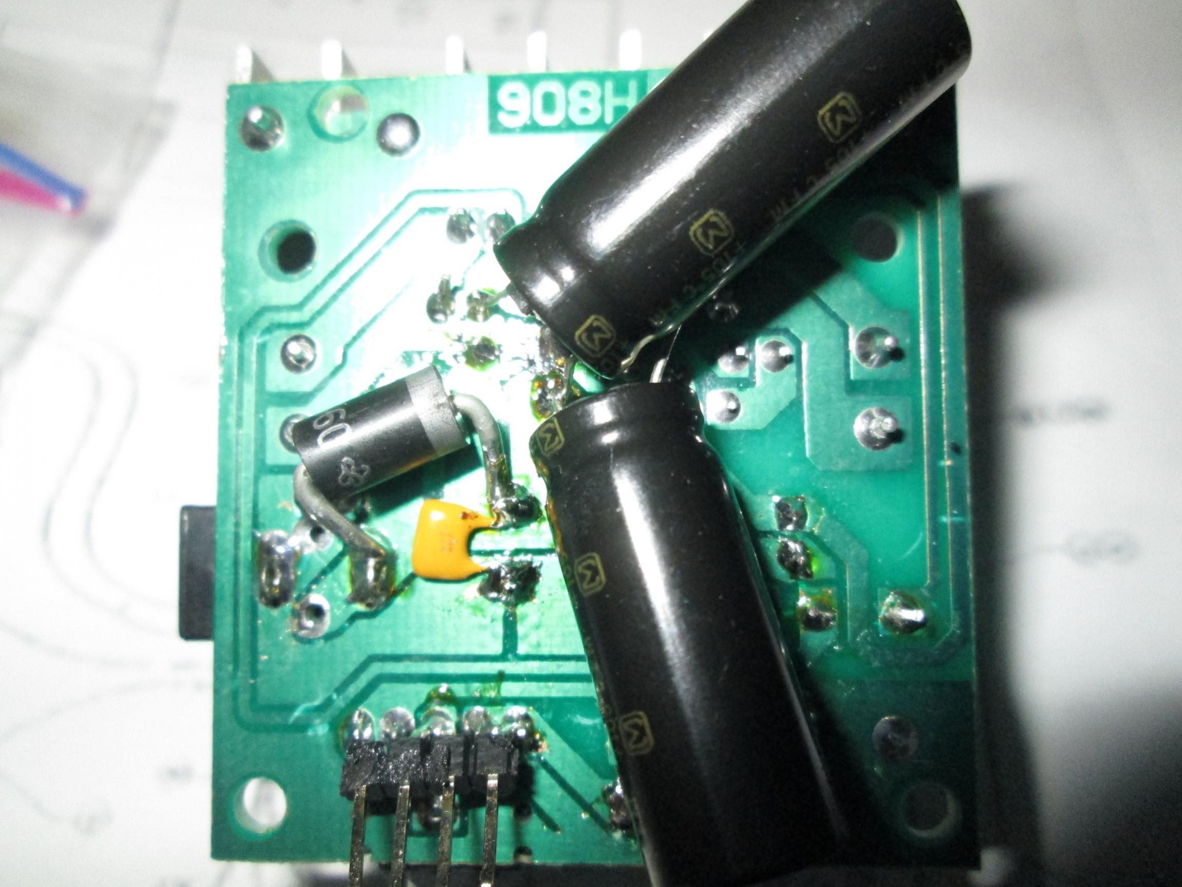

Upgraded my best Luncheon (10k sm series atten, silmic 2 input caps)
With AndrewT Approved high-freq X7R, 100V, 0.1uF across left AND right ps (top) as well as mid-freq Pan FM 560uF, 35V across left AND right ps (bot).
(each highf cap and each midf cap has its own connection to GND)
And threw another X7R across the main ps cap (low-freq old Pan FC 2200uf, 35V) after the schottky diode ... for good measure.
Hmmmm, I think I hear a bit tighter bass and better cymbals ... but it could be audioTOMfoolery!
(PS Playing through the AMT Monitors right now with some Tull, then Satriani, hmmm ... Hancock!)
