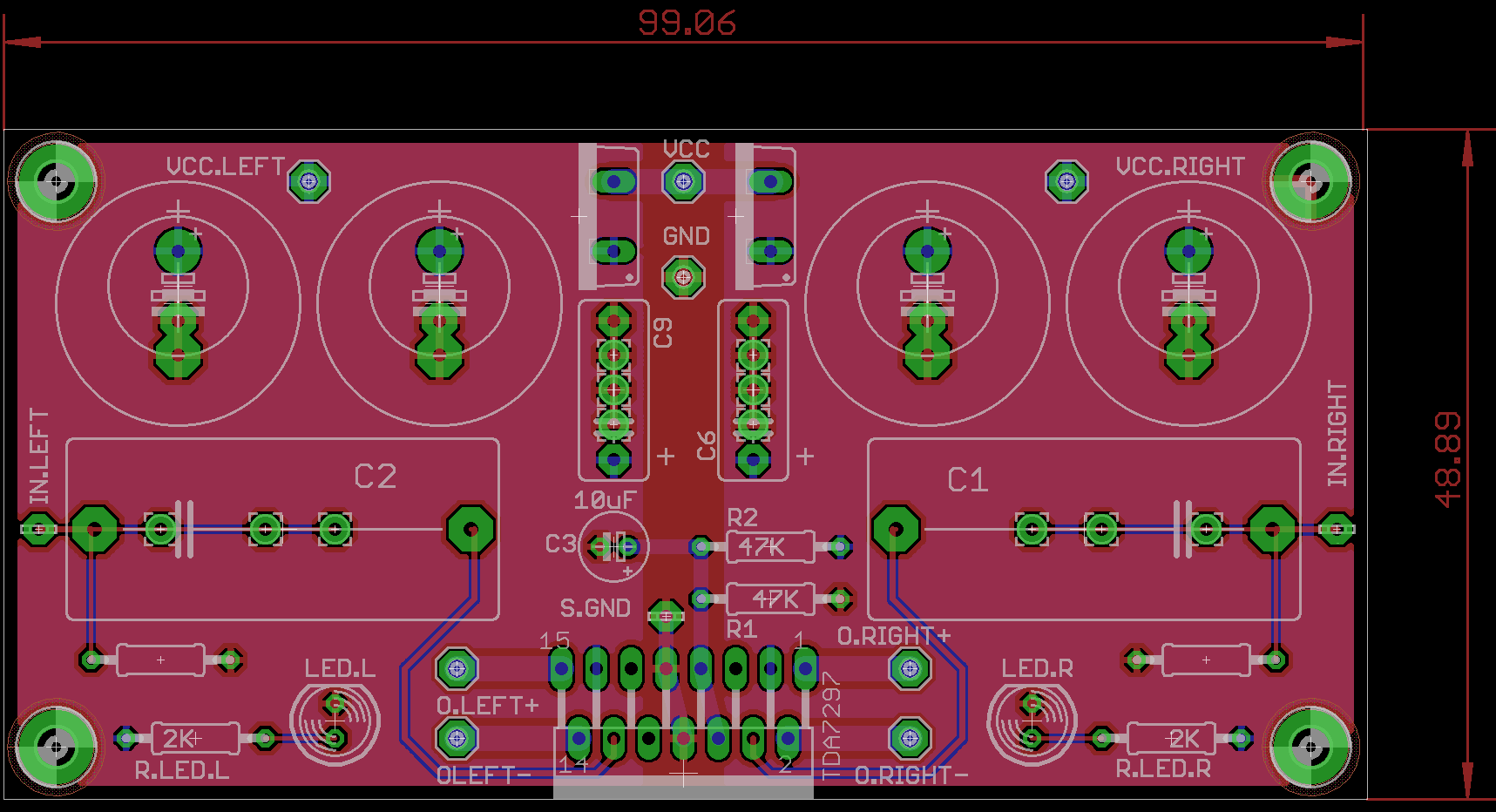

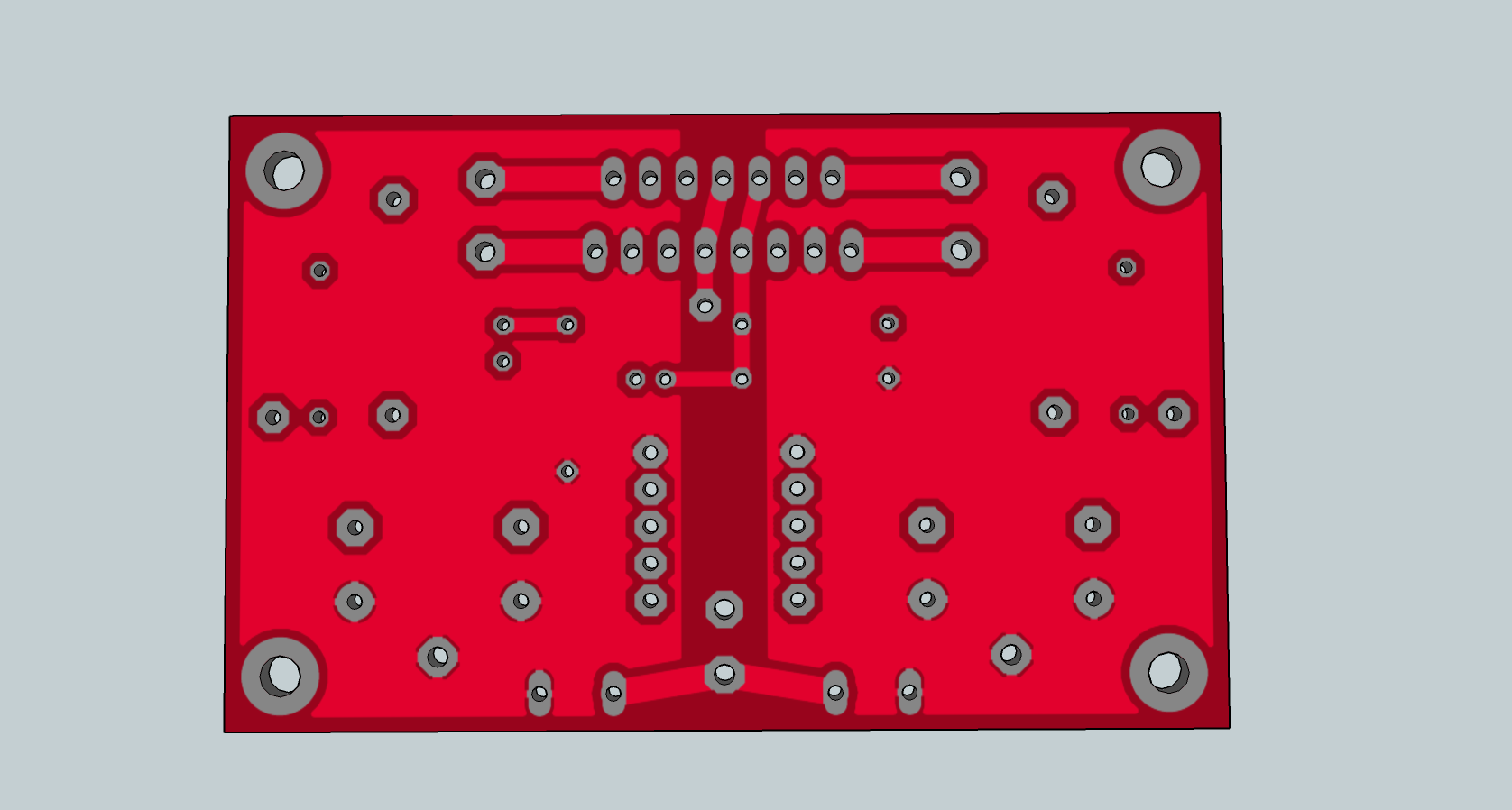

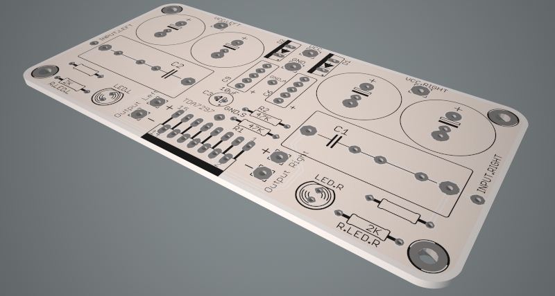

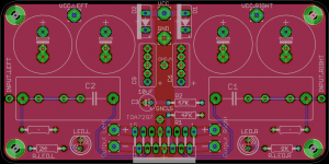

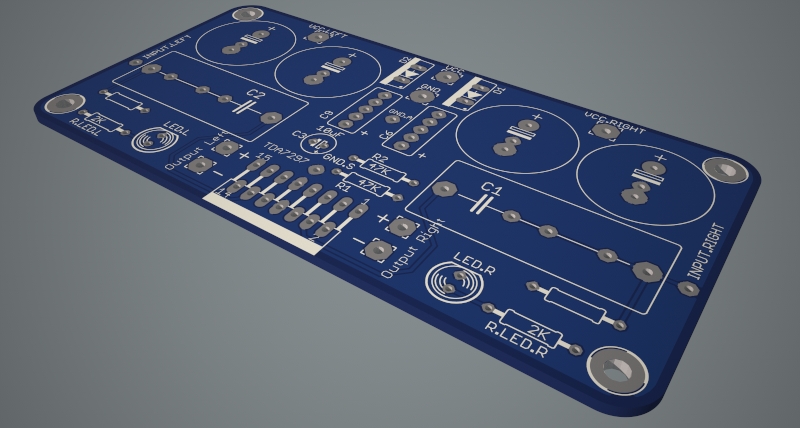

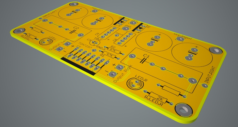

I don't think they are. I will study this aspect. On this board signal ground connects to ground plane near the chip's pin.
Regarding the bypass caps, I took the footprint of wima fkp1 I think, and smallest voltage is at 400VDC I think. Initially I designed it for me as I have those caps laying around
I will make a smaller footprint and also add a connection for smaller electrolytics.
Nope, I've used wima mkp10/63v. Those have 10mm pin spacing. Can you recommend a good pin spacing for bypass capacitors? I could go for 7.5mm and I guess the electrolytic ones have 2.5mm to 3mm, so I could add another solder pad inside the footprint for smaller electrolytic capacitors.
Simple solution for the spacing: Just provide multiple vias to fit either 400v box caps or 63v (normal size) box caps at all four places you've got polyester caps. That will get the needs covered plenty well.
When adding the vias, I suggest to arrange so that when normal size 63v box caps are installed, then the cables aren't obscured. That would be elegant.
Edit: The normal size for 63v box cap is 5mm (including red wima, vishay and avx T*). The 400v cap that I have on hand is 10mm.

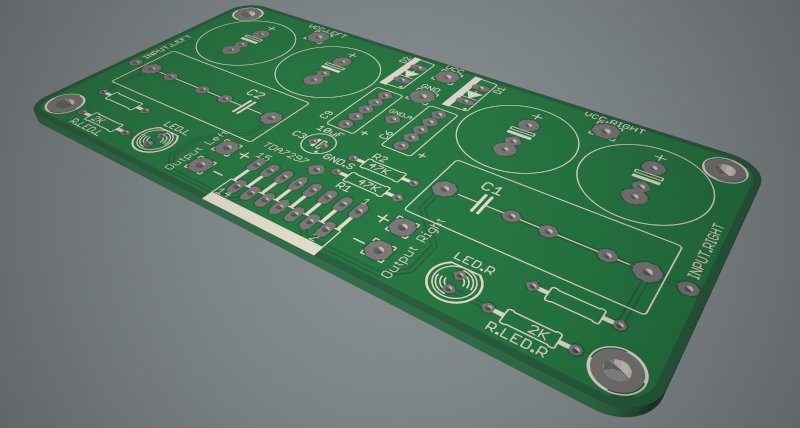

I bought 2 tda7297; 1 mod by changing supply cap to panny FA 4700/25v and the other using BG 4700/16v cap and fed by a simple 9v unregulated CL supply... when the input sig is paused, volume turn to max; panny mod can hear a faint low freq hum while the BG mod is totally silent... looks like better supply cap does remove power supply noise quite effectively...

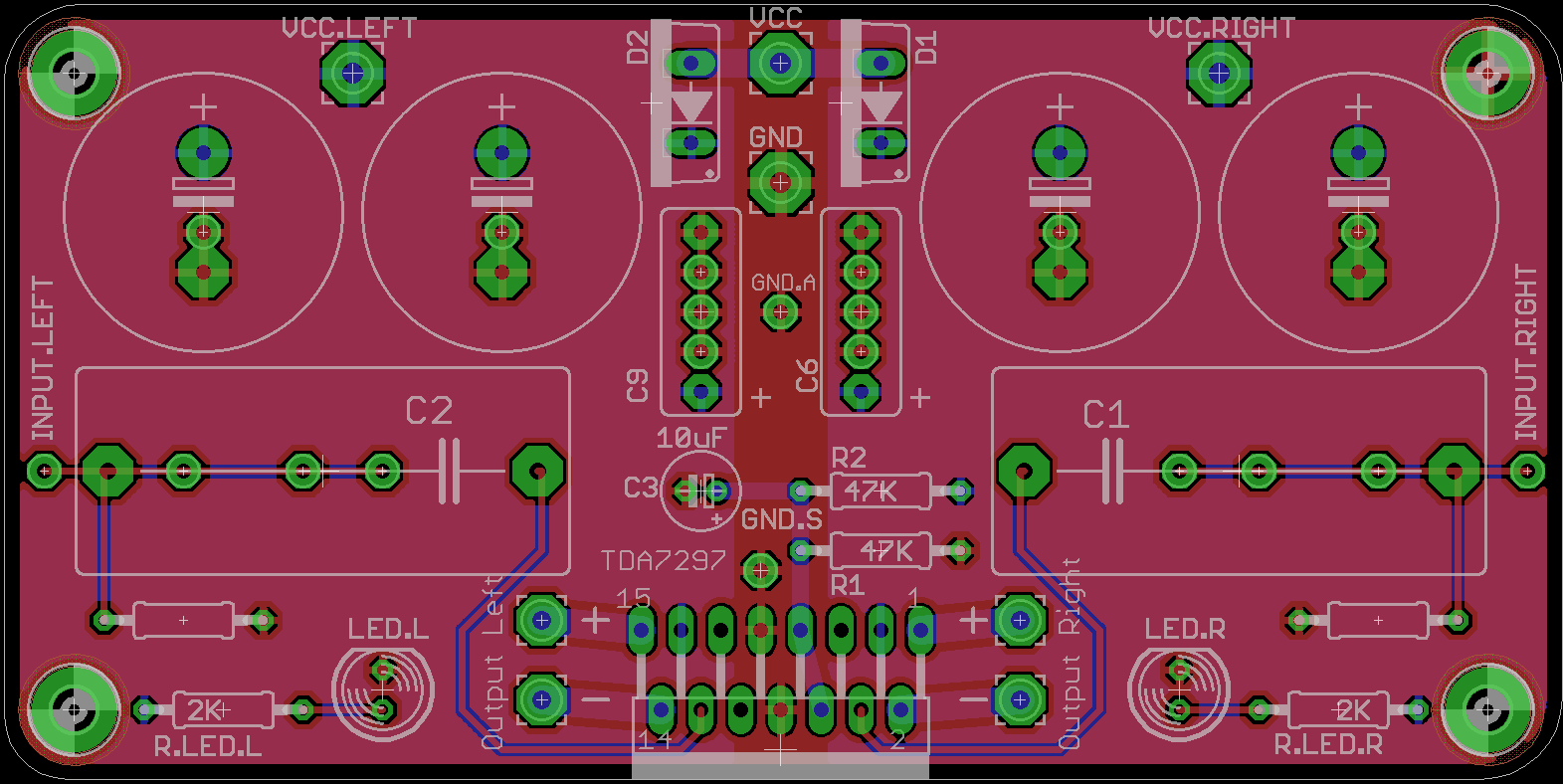

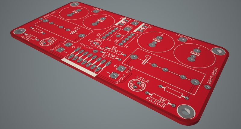

I found some time to make the necessary adjustments. I put pads for 2.5mm, 5mm, 7.5mm and 10mm. Also the positive connection for polarized capacitors is the lower pad so you mount the capacitors closer to the chip rather than power supply. All the extra holes are ground. With this setup you could install an electrolytic capacitor of 2.5mm/5mm pin distance with 10mm maximum diameter. Or 2.5mm/5mm/7.5mm/10mm pin distance non-polarized capacitors.
*edit:
any way I could remove the silkscreen for the diodes? I'd like to leave only the pads and put a diode symbol with the mounting direction. I can't seem to figure it out. I also tried editing and deleting the diode design but that didn't work either.
*edit:

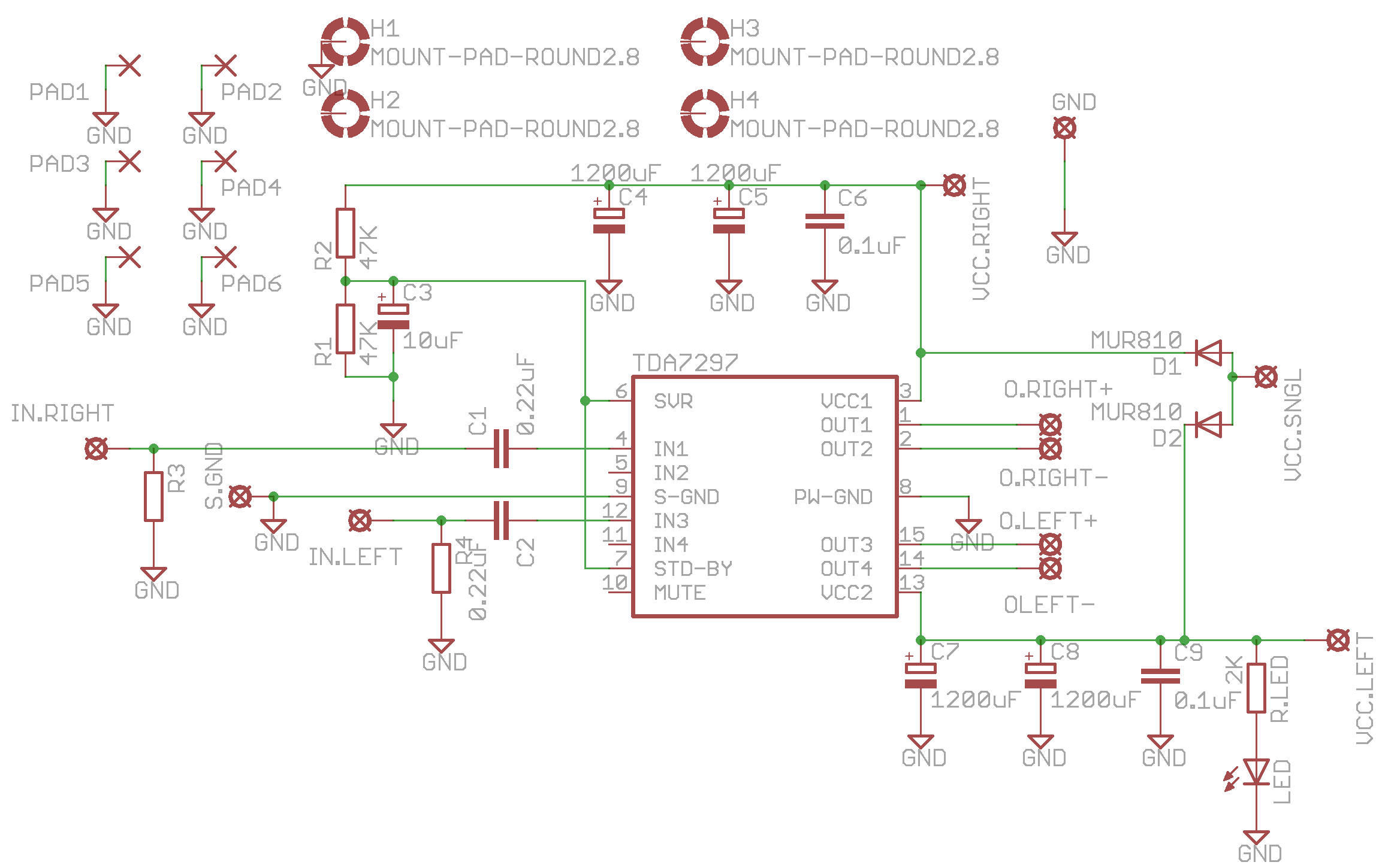

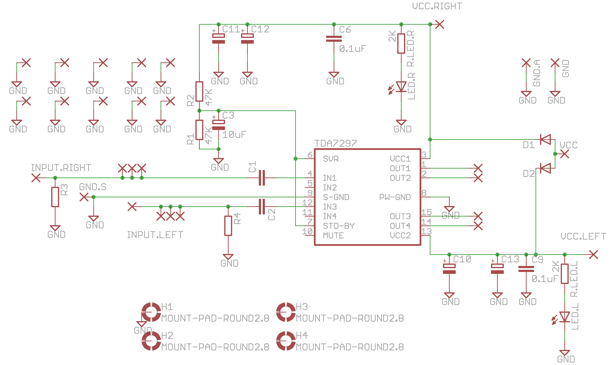

I just realised that the input capacitors are very small. I want to add a larger footprint so larger (physically) capacitors can be mounted. I'm looking at Wima PP caps and they have a pin spacing of 27.5mm. 10 or 15mm seems way to small. Since the board house charges the same for all boards that are sub 10cmx5cm then I will make the board a bit larger to accommodate larger capacitors. Also I will put padded holes for 15/10/5mm like the bypass caps.

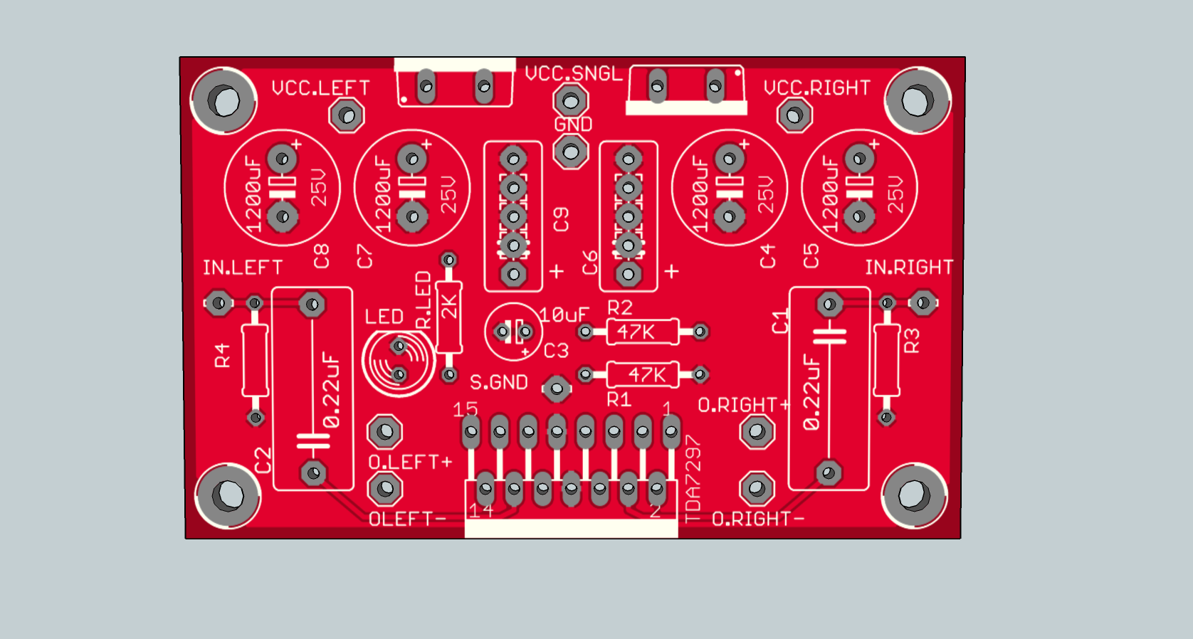

Well, the thing is that this chip has dual power rails.
If you look here: http://datasheet.octopart.com/TDA7297-STMicroelectronics-datasheet-10837159.pdf
you will see that pins 3 and 13 are both Vcc. Since this is a stereo chip it basically has one power input for each of the two amplifiers inside the package. This way you get a better separation between the channels and that results in better audio quality. You can think of it as two monoblocks, each with it's own power supply. Off-course, you can use a single power supply and add the two diodes if you don't want to install two separate power supplies.
Thanks for the explanation. I think I'll stick to single supply for simplicity and costs.
Oh, and please keep at least on LED as I'd use it as a power-on indicator
Theoretically yes. It should sound better but that also depends on your speakers, ears etc. You can use one psu and later add the second one if you want to try it one thing to notice is that the supplies have to be the same type and output voltage. I wouldn't recommend adding a regulated psu as a second unit next to an unregulated one. I don't have experience in this matter so I wouldn't risk using two different ones.

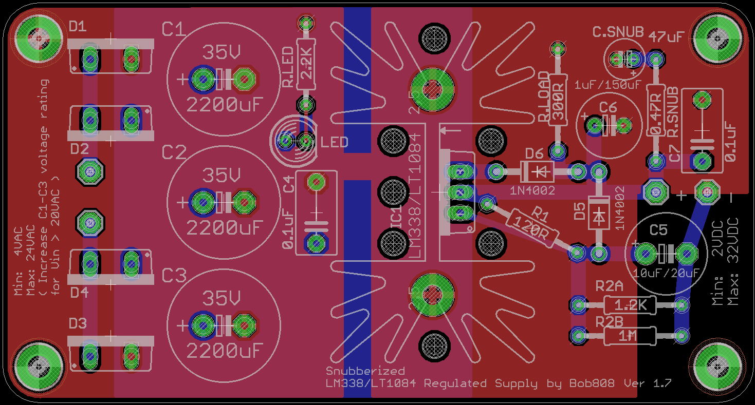

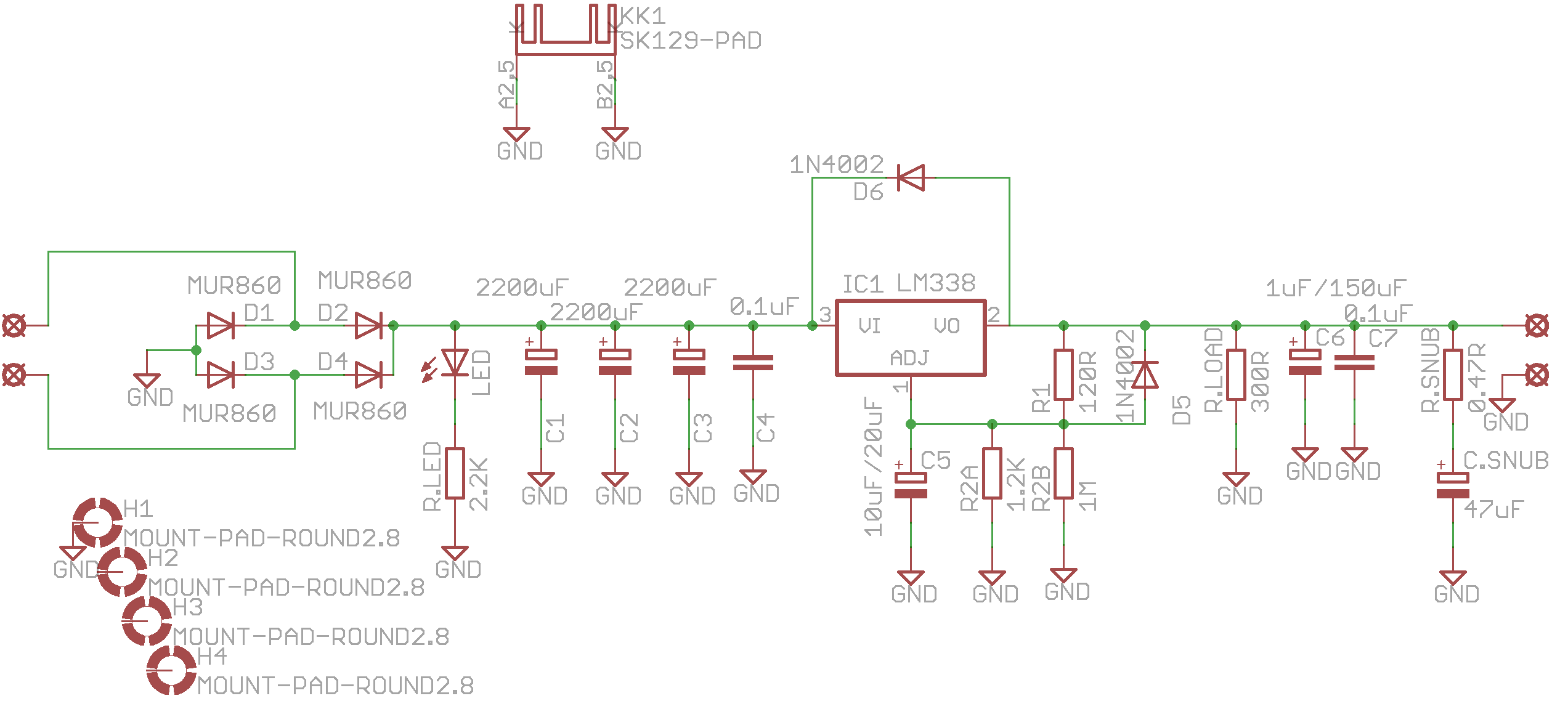

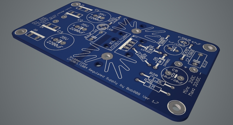

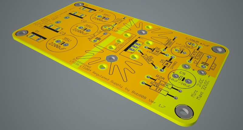

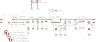

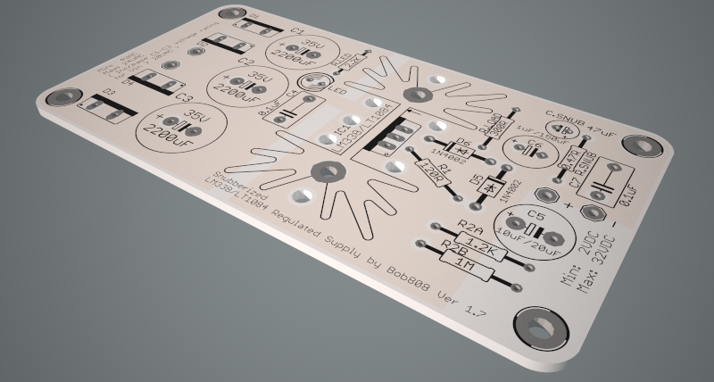

The regulator board can be used with a number of adjustable regulators. LM338/LT1083/LT1084/LT1085 etc. I guess you could use LM317 but I wouldn't bother.
Also keep in mind the voltages you are working with. You want to size the capacitors voltage rating accordingly. For output voltage calculations you can go here:
LM317 / LM338 / LM350 Voltage Regulator Calculator and Circuits
R1 needs to be about 120ohm for LM338/LT108x. I've added another resistor in parallel with R2 on the psu board so you can better dial in the voltage. I don't like a pot in that spot as it can move in time. Also there's a snubber option on the output of the board, you can use it or not. Same goes for the parallel resistor.
If you get the amp board and psu board then don't install any LEDs on the amplifier, the psu has one.
These boards are made to be cased. That's why there is no connector on them. You solder wires directly between the boards. Also you have to think of a way to cool the chip, mount it on a piece of aluminium inside the case.

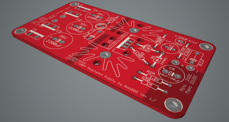

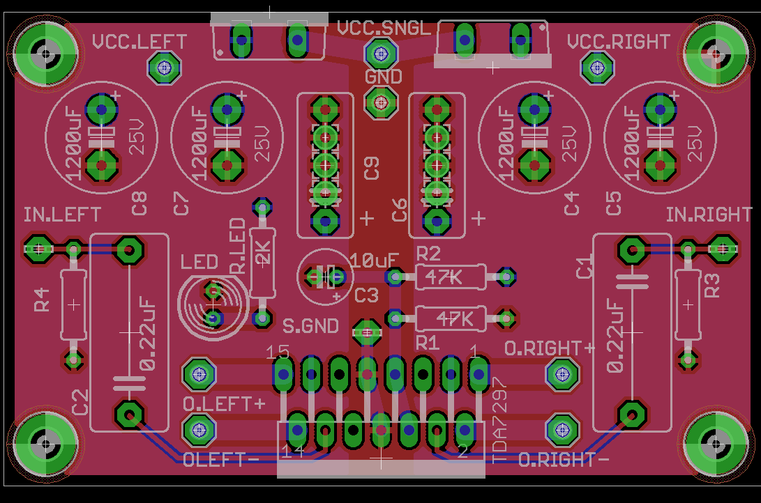

This is the regulator board.
I will look over the boards tomorrow to see if I've done any mistake.
Another mention, I've added another GND pad on the amplifier board near the main GND connection. I would like to test something when I get the board. It seems that the Power Ground and Signal Ground are internally connected and I have to connect them on board. I've read that a good practice is to connect both pins to GND in different places so you separate the digital side from the analog one and I'm planning on trying to not put the Signal Ground leg on the pcb but connect it directly via wire near the main ground connection. I will test it and see if it matters. Should be easy to do.
Also I'm wondering, if I will use two PSU boards then will I need two GND connections as well on the pcb? Maybe someone with more knowledge could chime in.
Another mention, there's one mounting hole connected to ground on each PCB. If you don't need to earth the board with the case then put some isolation between the screw and the pad.
Is this correct?
