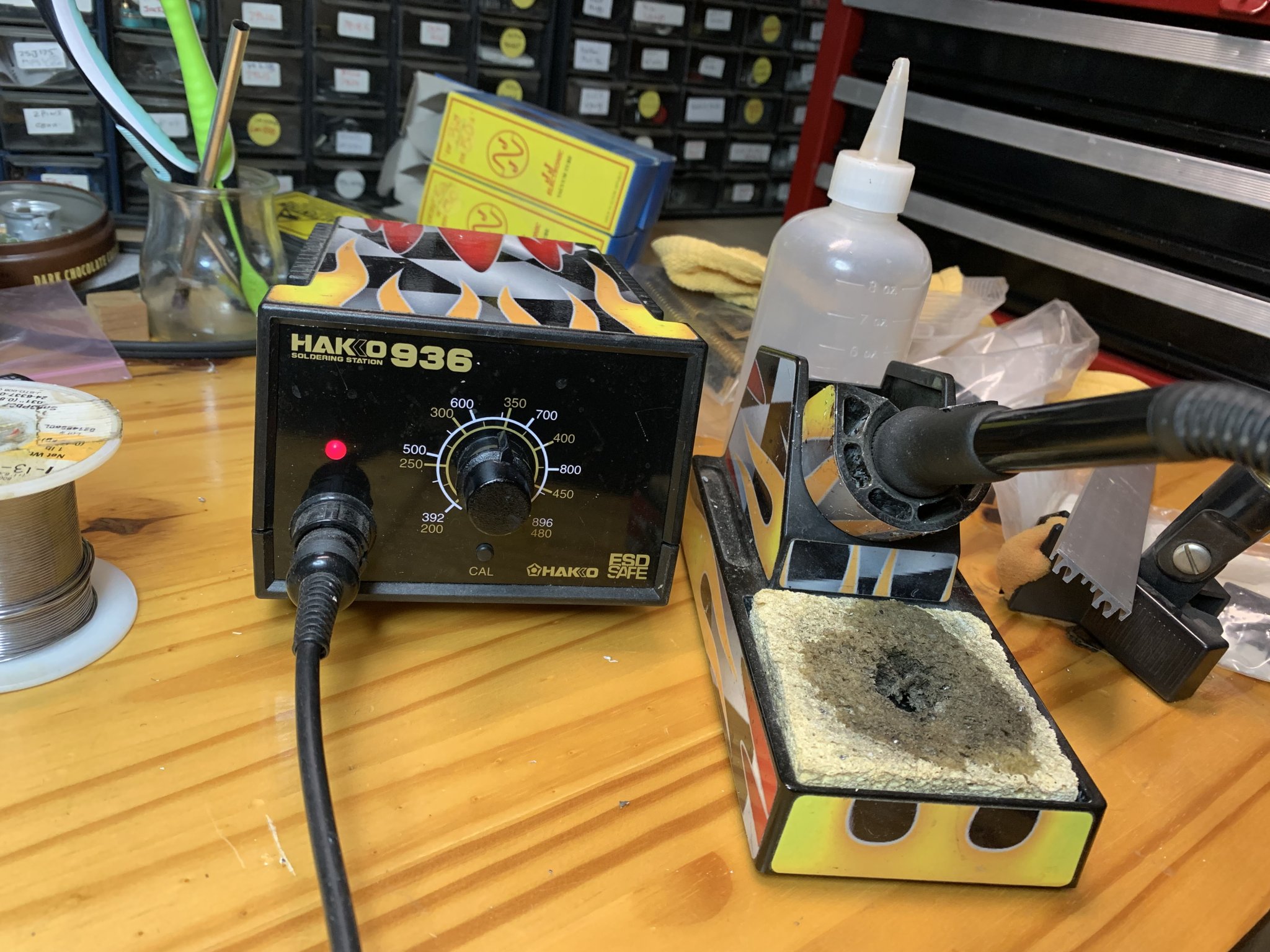

That doesn't look like degrees Frankenstein to me...350 Deg. F
