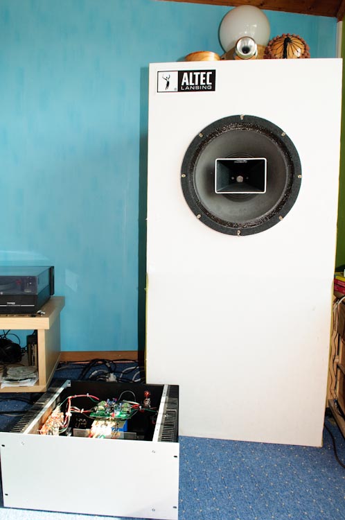

I have completed my two AX-100 mono blocks on last weekend.
I drive Altec 604-8Ks in relatively big back-loaded horn cabinets with them; the bass is better than ever before. I run an active configuration, the highs are currently amplified by a 2x45W push-pull tube amplifier. At some point I might replace it with the low power AX.
I will post a more detailed report later. All I can say for now is that I am happy as a clam, presumed a clam can feel happiness. :)
Manfred

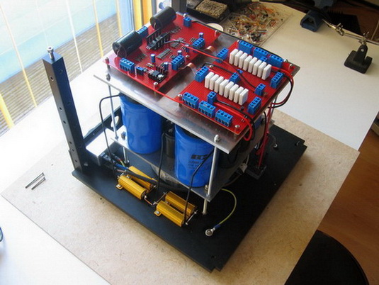

The picture doesn't do my work really justice, because of the restriction in size for attachments. I showed them to Nelson a while ago and he kindly offered me a spot in the Gallery at his website. Although honoured, I declined because I knew that the next one was going to look even better, and that's the one that I want to offer for admission into the Gallery. The insides of this beautifull beast are shown in the picture.

Ok, this is how it looks for now.
I used 5HU cases from Hifi-2000 in Italy as they were cheaper with the heat sinks than what I would have paid for comparable sinks alone. I am still thinking about how to make the face plates look a little more pleasant. I will probably come up with something wooden and a little meter that allows for monitoring the DC offset - I have been obsessed with that lately...
Rail voltage is about 23V, bias is 6A - the heat sinks are too small to dissipate more heat. I guess I will be starting a new thread on the weekend to share more details and to ask a few questions.
Manfred
