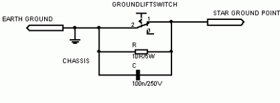

Ground Lift circuit is a method which is been used mostly from PA amps designers in order to eliminate signal injection hum problems. The goal is the isolation of the signal ground from signal injection interference. I'll try to post a circuit with more details.
Regards
ok, it looks like this:
post2 , case2 (the safe one) is like post4 schematic.
Earth ground & chassis is the Safety Earth.
the audio ground (star ground point) is on the right.
Thanks Spirtos.
However, there is a problem.
The 10r causes too high a voltage across the disconnecting network when mains fault current flows from the audio side to the safety earth.
A low voltage component must be added in parallel, capable of carrying the fault current.
A power bridge rectifier or a power thermistor can achieve this duty.
