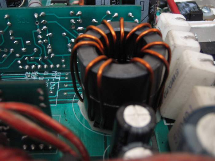

What material to be used for output filter? I built an experimental self-oscilating classD, making the output LC with ferrites (toroidal) it exhibit strange behavior. In small volume, everything is OK, but in medium and high volume, the power amp suddenly sucks big current, the mosfets becomes hot, and the output inductor seems ringing (can be heard, the ringing follows the bass). When checked in osciloscope, in the "on" pulse, there is a blurry area, like comb (in small volume the square is good, without oscilation). Is this because ferrite don't suitable for output LC? What material to be used?

Your problem is saturation of the core. Ungapped ferrite has high permeability, so magnetic flux density becomes high with small amount of ampere turns. You neeed low permeability core, either gapped ferrite core that is more linear, or distributed gap core like powdered iron or pemalloy. Ungapped ferrite toroid will exhibit high inductance until it comes into saturation when it effectively becomes an air core. So you are facing several thousand times reduction in inductance (difference between initial ferrite permeability and air permeability) or in your case from several miliHenrys to several hundred nanoHenrys. Typical inductance used in classD amps is usually from 10 to 40uH. You were given a lot of good advice from orher posters, so maybe only two things:
Remember that most of the energy in inductor is stored in the air gap, so larger the gap, more energy storage is available (and more problems with fringing flux).

A general guideline is that if a DC current is passing through a core, a distributed gap type like iron powder or a gapped ferrite type is required to prevent saturation. Even though the switching frequency may be high in the kilohertz range, the audio component is passing through in a way not totally unlike DC through a power supply filter choke.

I look at Crown BCA, it uses toroidal shape, but it has many-many windings in it (like 100 or so). In my experimental amp with ferrite toroidal, with 12turns only, I've already got 200uH. So I think the saturation could be the cause.
If the core is saturating in my case, why it makes the mosfets hot and draws so much current? Does "Shoot Through" happens with saturated case, or the hot mosfets are caused by something else? I've burned many-many mosfets. (I use IRF640, is it something wrong with using this?)

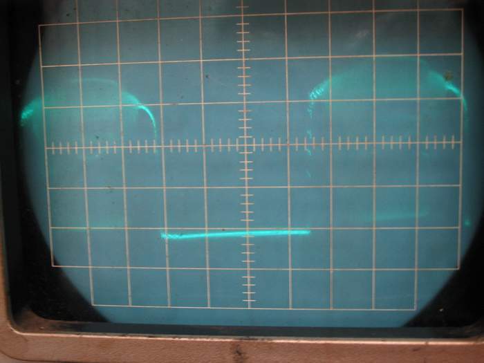

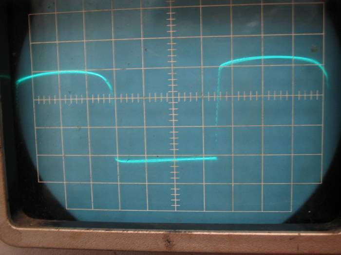

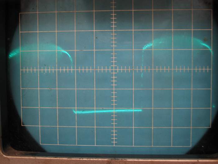

Since I experimented with self-oscilating, it's difficult for me to see what happens in the fault condition. In the fault condition, every track seen in the scopes are mess and moving everytime.

This is the inductor I use. I stack 2 toroidal ferrites

See Alme's thoughts above about too much magnetization of cores. Fewer turns can tend to subject the core to greater magnetic field strengths, which can either push it into a poor Tesla operating range for its material type and operating frequency, or cause downright saturation.
Jaka explained it well that the choke suddenly loses any ability to cause impedance to the current waveform passing through its windings. Then, essentially, the MOSFETs feel a short circuit to the output filter capacitor. Having a relatively high on-state channel resistance as far as MOSFETs for class D go, the IRF640s quickly overheat because at high frequencies, the filter capacitor has a very low impedance. Yet, at least that channel resistance should tend to reduce high frequency EMI.
The high currents flowing then cause a lot of induced and conducted spurious signals or hash. It may look like a blur on your scope because it lacks high frequency resolution. But even a 20mhz scope is an immensely useful tool in switching power circuit design. Also, the signals are constantly shifting in phase in relation to the trigger point of the scope trace display.

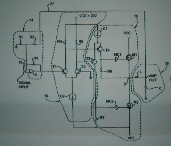

The supply rail is +70/-50V, the topology is like this (you know where it comes from). The opamp is NE5532.
I have a question about this topology. What is the purpose of opamp (receiving input and FB) here. To higher OL gain? What happens if we skip the opamp, and take the input and FB directly to the differential? Will it still works in classD or becomes linear amp? I think if we can get simpler, why go through the hard way. Or we cannot omit opamp in this topology?
