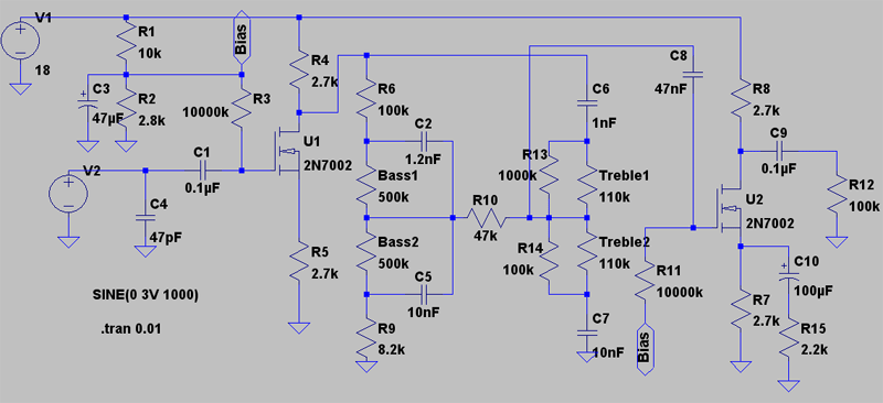

Enzo, thankyou so much for your extensive reply. Your advice led me to opt for 40 watts instead of greater or equal to 60. I have decided to use a typical 'Gainclone' power amplifier, due to its simplicity (this is my first project of this size). National Semiconductor provide documentation on a 40W amplifier using their LM3875 chip, and I plan to use this.
I have started designing the pre-amp. Because this is my first amplifier design, I'm keeping it minimalistic. I play jazz guitar, and all I'm realy after is a good clean tone that compliments my archtop. At the moment it only has a volume control, and a baxandall tone stack with treble and bass controls. I don't want to make it much more complex than that. I decided to use a baxandall tone control after reading this page http://www.duncanamps.com/technical/tonestack.html on Duncan's Amp Pages.
I have included the schematic so far. I'm using a mosfet input buffer to get a high input impedance, to conserve whatever tone the pickups are outputting. This stage does not actually amplify the signal, because the input voltage for the 40W gainclone stage is not to exceed 1V, according to the datasheet. With my humbucking pickups, I can get over 2V out of them when i strum hard, and this would cause clipping. I designed the pre-amp for a maximum input voltage of 3V, incase some effects unit before it amplified the guitar further. With 3V on the input to the pre-amp, the output to the power section is about 1V.
Now, as you know, i'm a student, and I don't have experience in this field. The reason I am posting the schematic is so that I can learn what is wrong with it and how to improve upon it, so any comments are definately welcome!
N.B. The sets of resistors (Bass1, Bass2) and (Treble1, Treble2) are realy potentiometers; my program does not have pots so i used these instead.

The LM3875 is a good chip. Many if not most of the small amps I see use the TDA2040. The same family also includes the TDA 2030 and 2050. Last two digits reflecting potential power out. These come in a 5 leg TO-220 package, which is easy to mount and wire in. Look up the TDA2040 and check it out.
More than you need, but interesting anyway is the TDA7293.
AS a student, none of this has to be permanent. With separate preamps and power amps you can upgrade either end when you feel like it.
Your design looks good to me, I must admit I am not real experienced with MOSFETs. HAve you considered doing a similar design with JFETs, just to be scientific? FETs will emulate tubes better than bipolars. Most amps use op amps rathre than transistors anyway - in the commercial marketplace. Daily I mostly see op amps and tubes.
If you write to Peavey and get the schematic for the Rage/Blazer you will see a basic little amp that sounds pretty good done with bipolars in Darlington. This is meant to emulate tubes somewhat. If you ask for ir, make sure to specify the "Transtube" version. They have made several versions of amops with those names. It might also be informative since hte r=two amps are identical except the Blazer has a reverb. Something you may want to add at some point.
A lot of the small practice amps sound crappy because they have a tiny crappy speaker. it is amazing how much better these little things sound through a nice full size speaker. The speaker is an important part of the sound, as I mentioned.
SOmething to consider. Whatever the output signal voltage winds up being, you can always pad it down before you send it to the power amp. (Does you rpower amp actually clip at 1V? Or can you peak over that?) Though the guitar can output a strong signal when strummed, much of the gentle picking results in a small signal. The smaller signal is that much closer to the noise floor. Your amp will be amplifying the noise along with the signal.
Generally we expect a pretty good level of gain at the first stage to elevate the signal over the noise floor. The EQ is passive, so it is cut only, there is no boost. Setting the controls at mid point does not result in boost as you turn them up, it just cuts less. SO the tone stack represents a large level loss, and the stage after it is ther to recover the signal level. The noise will always be there, but if the signal is many db louder, the noise will be masked. SO in general it is good to get some initial gain to give you enough level to work with.
Is that circuit running on 18VDC? if so, you have the room for almost 9V peak of signal before clip. Or do I misunderstand the design? DOn't worry about the output level, you can adjust it afterwards with a simple pot. Or is R12 already a pot?
I notice you bypassed the R7. Bypassing R5 would have an effect on gain and low end response. COnsider bypassing with a couple different cap values as an experiment. I am not suggesting it needs them, but it might be instructive to watch the effect. Again, I am not a FET guy, but in tubes and other devices this is the expected result.
Tell us how this works once you build it.
